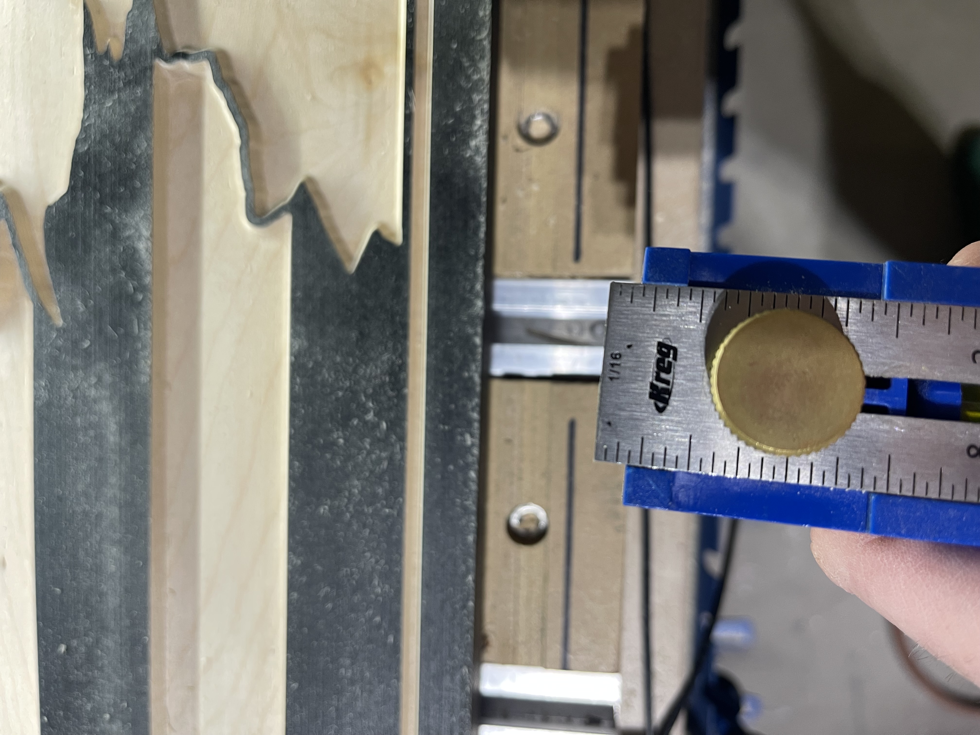

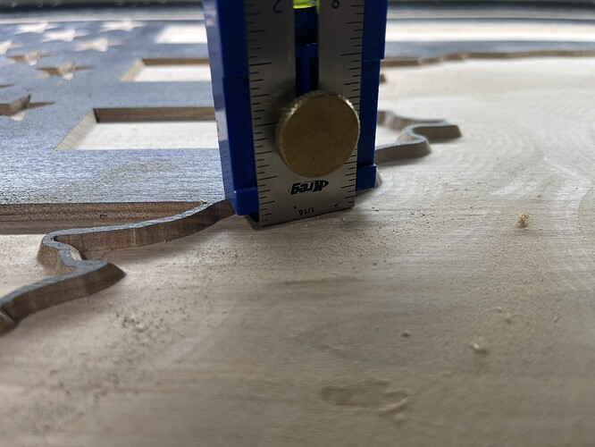

I’m having trouble with my machine cutting quite a bit deeper than I want. In the end the result looks ok, but isn’t ideal. I’m setting the max depth on an Advanced V Carve of .1”. Starting with a 1/4” 201 and finishing with either a 60 degree V or a 30 degree V. The actual depth of the cut ends up being about 3/16”. Maybe a bit more. I can’t figure out what to change or what might be causing this. Any help is appreciated!

I’ve only had it a few months. Movement seems normal. Should mention I’m also using the bit zero. How do you calibrate the depth?

How deeply a given toolpath cuts will depend on where the origin is set relative to the surface of the stock and how flat the surface is, and how true that surface is to the plane of the movement of the machine.
I would suggest trying a test cut in a stable material such as MDF, first surfacing the stock, then cutting a test pattern such as:
