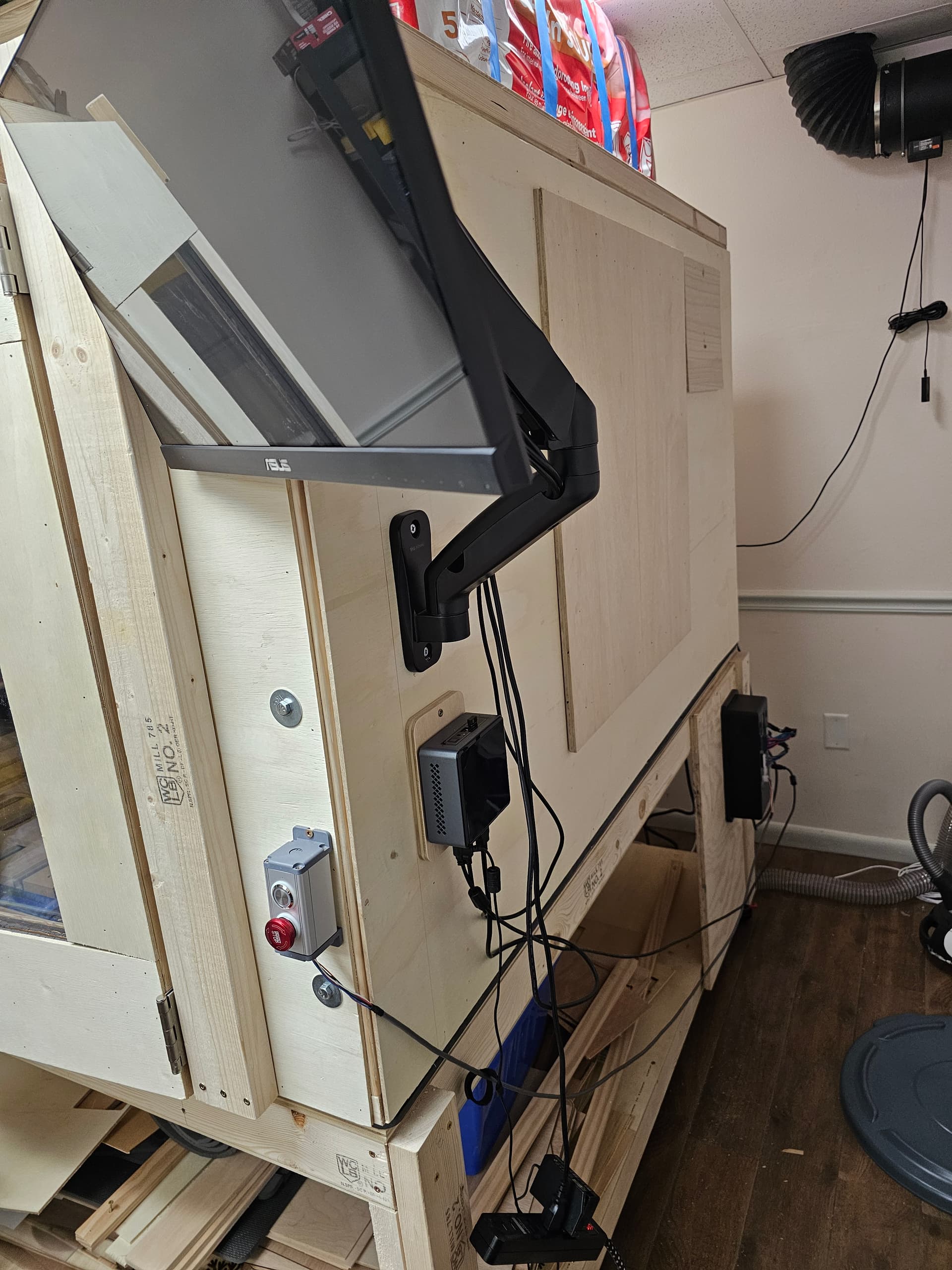

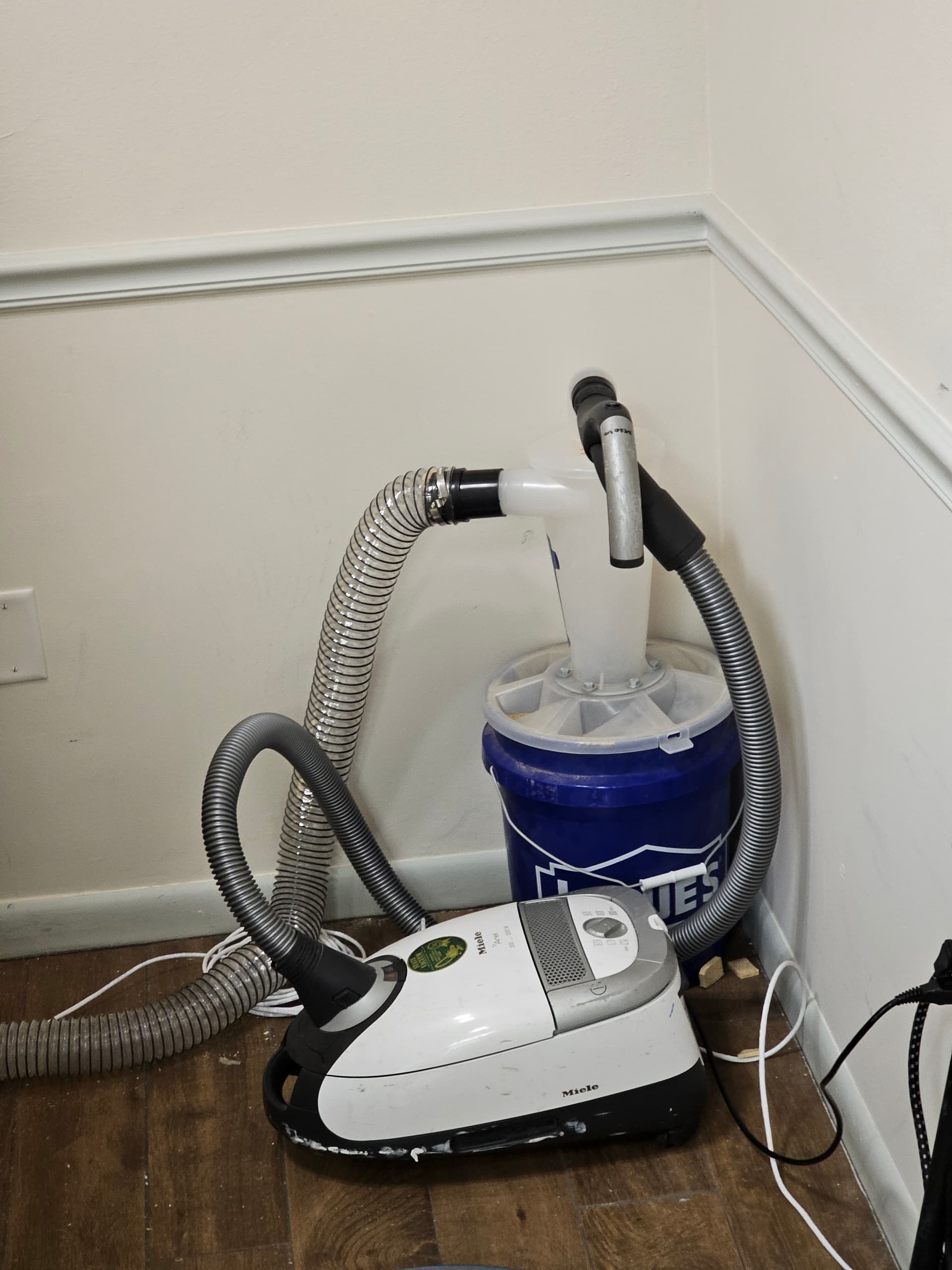

Couple of questions: 1) how large was the table top you were building this on? I read back… 72"x72" :slight_smile: 2) if you don’t mind me asking, what was your cost? 3) I see where your power pendant is. Where do you have your controller and PC for running CM? Are they enclosed to protect them from dust? 4) How is your dust collection system outside the enclosure?

  2. The Warthog electronics are attached to a piece of scrap plywood that is bolted to the back right table leg. I added a monitor arm to the side near the front for a touch screen monitor and below that an old Intel NUC PC for controlling the thing. The USB cord from the Warthog runs over to that.
  1. Dust collection is just an Oneida Deputy Cyclone on a 5 gallon bucket for now. That is probably going to get upgraded to a 55 gallon drum when I have time. I am using an old Miele vacuum with that. Miele vacuums are quiet by design. They have a second impeller on their exhaust that bumps the frequencies up into the ultrasound range. You can get them used on ebay for like $150 dollars. They also have a suction adjustment on them so you can dial in the amount of suction you use. Their lowest setting is still enough to clear saw dust and it is super quiet. They are also considered a high end vacuum, they last a very long time, and are designed to be serviced.
  1. I have a Fusion 360 model for the table. I did not model the enclosure because I really had to design it on the fly after the S5 Pro arrived. Things like the placement of the access hatches and the location of the dust hose support arm had to be changed after the fact. Most of the construction is just standard house framing with some augmentations so it can be taken apart. There are also a number of mistakes like the how the doors are mounted. They attach to a 2x4 which is then screwed to the top and bottom of the front wall. This is because I forgot to put supports on the inside for the doors to screw into.
I should also point out that it is not complete yet. I still need to build the air intake and exhaust ducts. Right now there is thin plywood covering those holes. I also want to somehow add a switch for turning the router on an off without having to open the doors. Big issue there is that because this is a commercial building I have to make sure it meets very tight fire codes.
