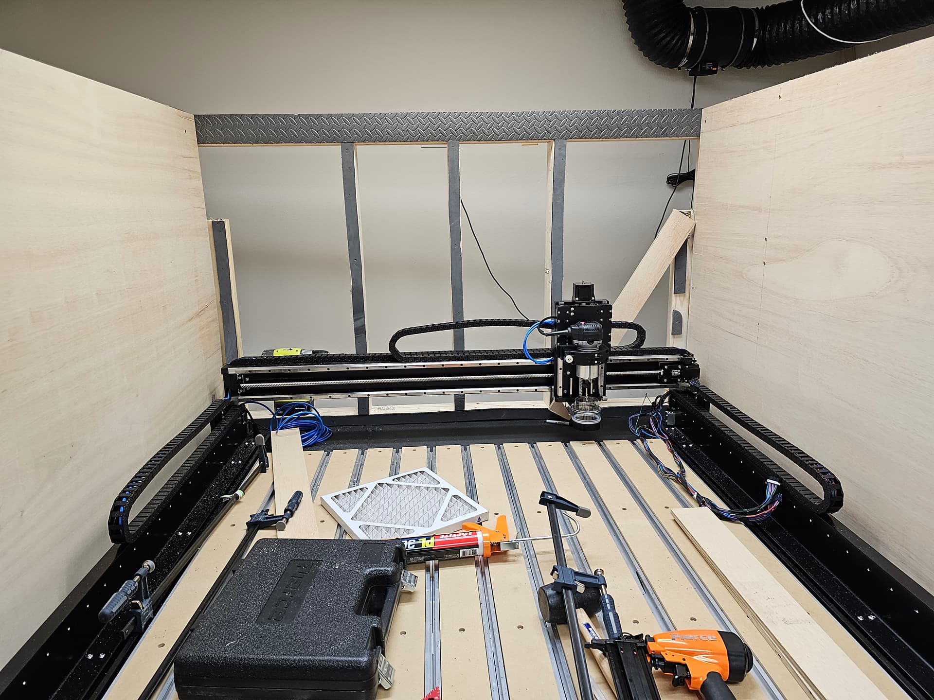

Anxiously awaiting UPS to deliver my machine today. Enclosure is 90% complete, some stuff will have to wait until it’s installed. Unfortunately the VFD hasn’t shipped yet but I got the C3D router as well and it is going to be here today so I should at least be able to get started. Fingers crossed they have all the bugs worked out and this one will work straight out of the box.
Progress:
I need to put the top on, make the doors and access hatches, and make the air intake and exhaust ducts.
The square hole at the top left in the last picture is going to be the exhaust and is going to take a 12"x12" furnace filter and is going to have two 140mm PC fans. The hole on the top right is the air intake. Both are going to have a snaking duct lined with foam to block the noise.
I noticed between pictures 4 and 5, you’ve added some windows on the sides and back. Am I seeing that correctly? Will those just be viewports, or will you be able to open them to access the bed?
They are access hatches so I can bolt things down at the back of the machine and clean up as needed.

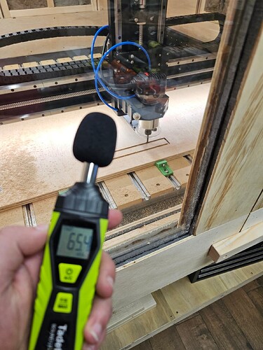

Here are more progress updates that should give you a good idea:
The last photo is from before I finished the right door. The dB should be even lower now.
