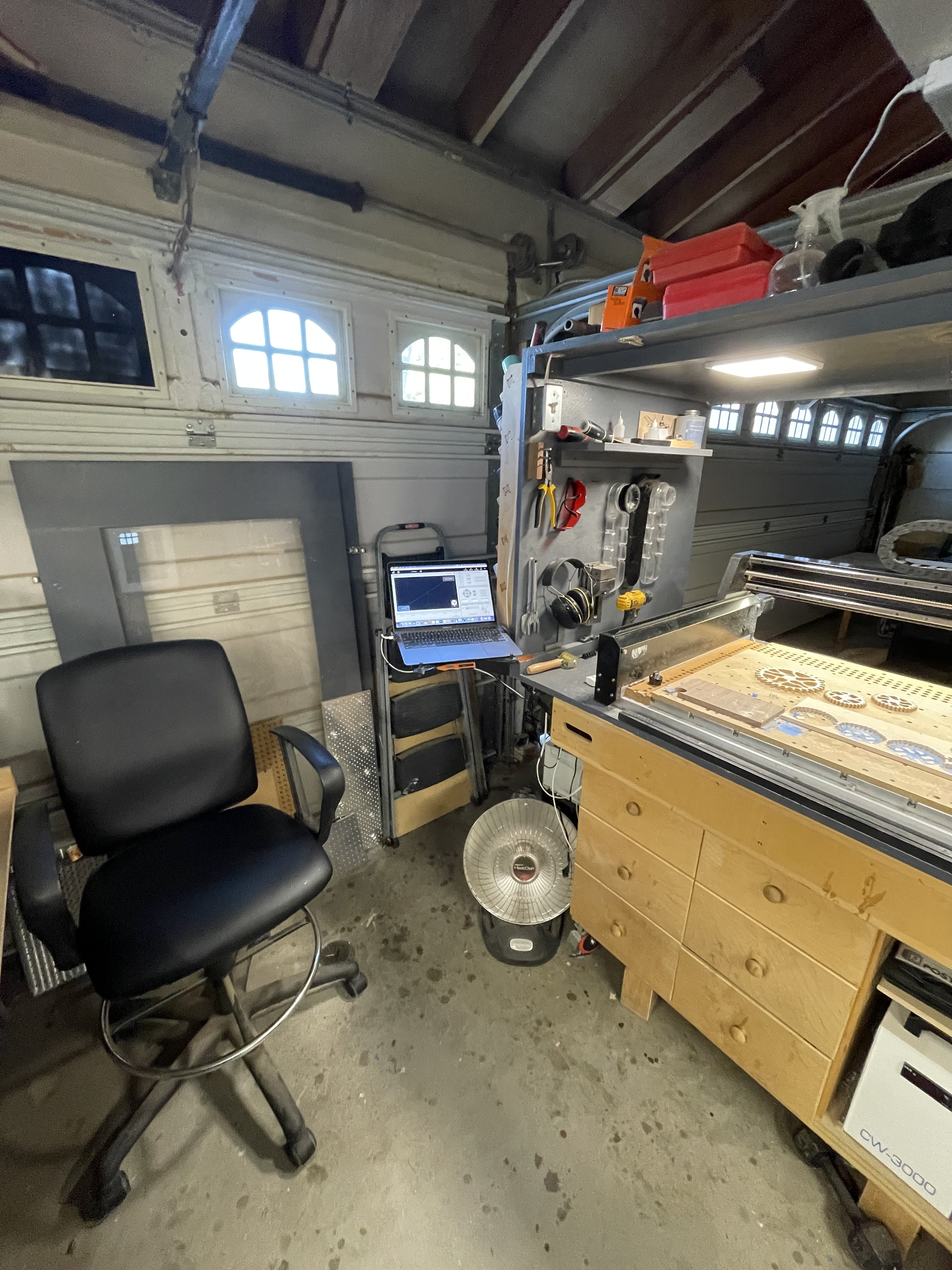

Some food for thought for you.
These pics represent my 4th iteration of CNC work space. Please excuse the mess, deep in the process of building a wooden clock and haven’t done a clean up in a few weeks.
The removable, hinged-at-the-top doors are behind the chair, never used ‘em.
I’ve found that two screens are a must have, ymmv.
The MacBook Air is overkill but convenient. I appreciate being able to swivel from my wok station to the CNC.
I built the cabinet and torsion box years ago for my original SO3.
I’ve tried all the dust removal options, for me, middle, top is best. And simplest. Big fan of KISS.
At about 12 o’clock you will see the dust hose coupling, I can disconnect the sho vac there and use to clean up the entire garage.
Dust collection on the opposite side of the garage, shop vac-in-a-box with separator on top.
So, there it is, the glorious mess I walk into every morning. Use what you like, chuck the rest.
