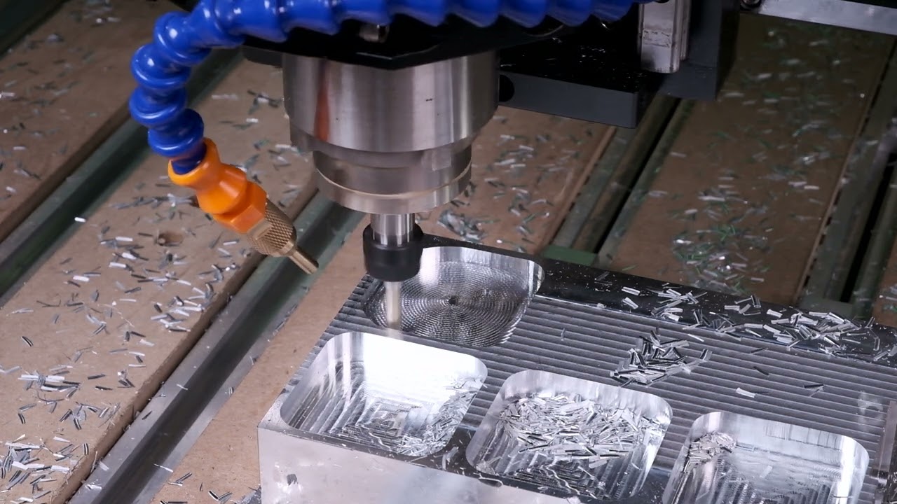

Winston put together a quick aluminum video on the SO5 Pro:
This toolpath is spindle-limited. The machine can do more, but the spindle starts to bog down.

I really hope that block is held down with more than CA and tape :wink:
Could @wmoy be able to provide the recipe/mrr etc for the above video? Looks approx 1/4" DOC.
Would be nice to see what happens with a 2.2k water cooled.
Tool: Carbide 3D 278-Z 1/4" single flute endmill + air blast
RPM: 22000 RPM
Feedrate: 2200 mm/min
Stepover: (Fusion 360 Adaptive Clearing) 1.25mm optimal load
Depth of Cut: 6mm
Looks good to me with a small spindle. I need one!!! Will be selling my SPro XXL ASAP to make room for a SPro5
