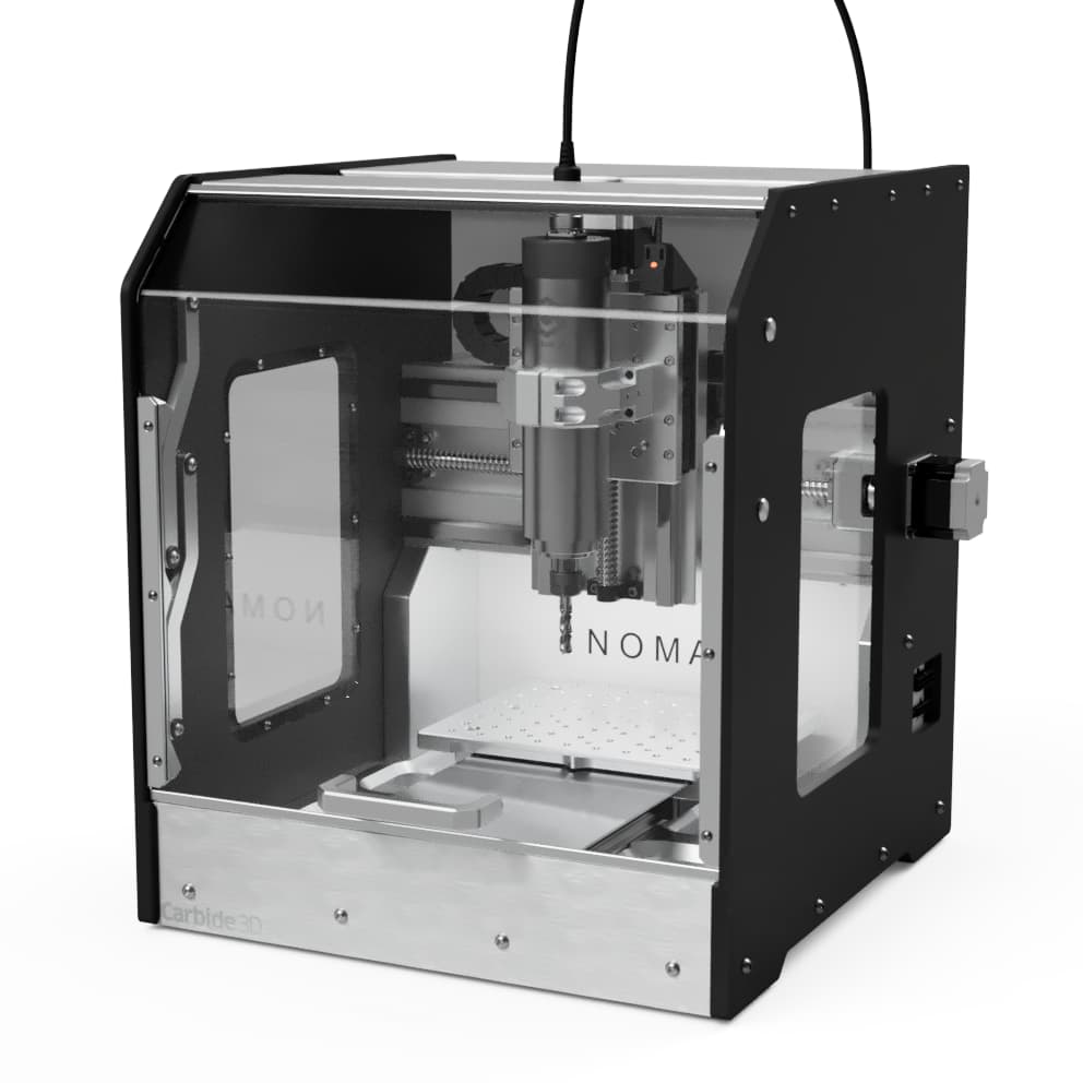

That said, if you are considering an HDM and your parts are small enough to fit, have you considered a Nomad 4?

What is better about the Nomad 4 than the HDM? It’s almost the same price but is much smaller, no?
This helps a lot. if you’re not hesitant to do run aluminum, that confirms what I was thinking… and I really want to keep it all under one machine. Thanks so much!
The big advantage for the Nomad 4 is that it is enclosed, so easier to use in a non-shop setting.
[Jeremy Clarkson voice]It’s been said that there is a guy who has an N4 in his apartment living room…[/Jeremy Clarkson voice] And it indeed has the perfect working envelope. Depending on the fixturing, you could possibly fit three of the Φ4" disks on the table…
