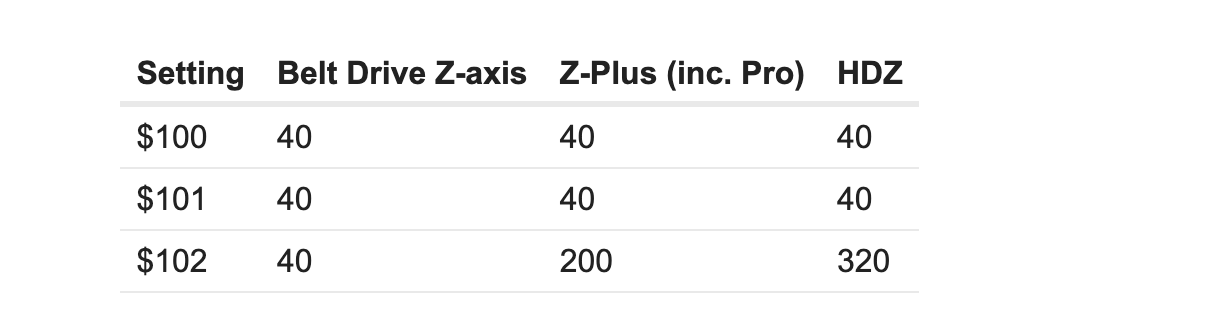

First, the BitZero is used to set zero relative to a corner or a surface — it is the BitSetter which if enabled and configured will be used to measure the tool whenever Z-axis zero is set. See:
Some potential causes of overcutting on Z:
  • wrong Z-axis configuration — if an HDZ is selected rather than a Z-Plus when a machine has the latter it will overtravel, and the more aggressive movement can cause lost steps
  • lost steps on retract, either because it’s a rapid and aggressive tool geometry next to a wall wants to pull it in, or something mechanically interferes (a too-heavy vacuum hose is a frequent culprit, or a power cord which gets trapped in the mechanism)
  • the tool pulling the carriage into the cut due to too aggressive feeds and speeds for the current tool/tool geometry

I dont have a belt on my z axis its a leadscrew

Next please verify the Z axis configuration. If you selected a HDZ but have the default Z plus the travel would be incorrect. You can set your zero as normal to the top of the stock then jog up 1 inch and measure how far up the axis travelled. I use a 1x2x3 block for an easy gauge. If it moves the wrong distance, redo the setup and select Z plus.
I checked it above in my log file
$102=200.000
I also measured the distance when I told it to go to Z +6mm it was 6mm above where I set Z
