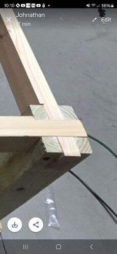

So i went with a more traditional woodworking joint for the main frame. So that i could get more stability. Added some regidity and additional support using pocket hole screws. Its for a 4x4 table. Pine for the frame and maple for the base. Its a work in progress but its finished enough to put the machine on which should be here this week
The main joint is called a castle joint, good quality wood is needed to prevent cracking. As far as finish i did a prestain, a cherry stain and 4 coats of poly finish. Also went with 4 castor wheels with rathcheting pads on the bottom, this allows me to use the ratcheting pads to actually level the bed when stationary, which i dont plan on moving it much, but if i do want to cut and index a 8x4 i can rachet the wheels down and move the table easily.
I also built an L shaped computer desk/station. Both tables are exceptionally strong. Im proud of how they turned out considering ive only been doing woodworking for 4 months. Keep in mind these are designs that ive mixed and matched from what i have seen on youtube and other places. They are really out of my head and i have no plans or schematics.

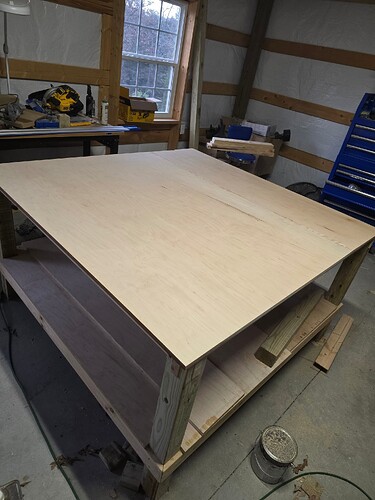

Here it is what I build for mine before CNC arrive. Mine is 4’x4’ I use oak plywood and solid oak rot the front. Hope this can help you with idea if you like my design .
My table uses some 80x20 aluminum, too. I’ll show it off soon, but I’ll admire yours in the meantime
That plywood is pretty
how do you go about letting air in? is the suction effected?
