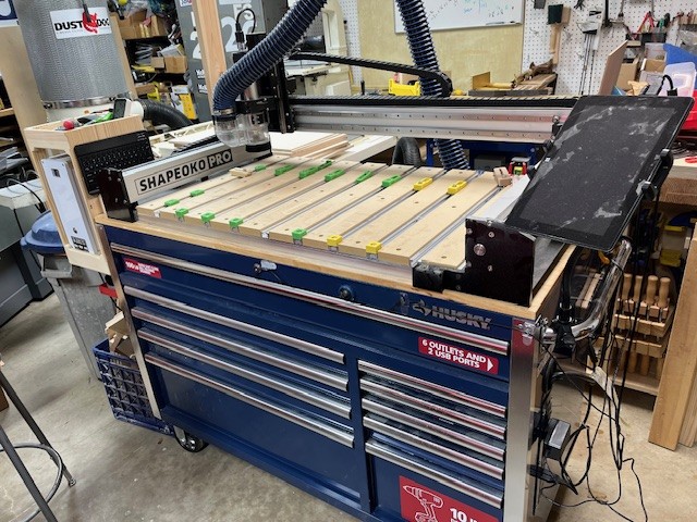

I have a PRO XL (The numberless one between the 4 and the 5) and got a rolling tool cabinet from Home Depot to put it on. The 4 Standard is smaller, and probably can fit on one of the smaller rolling tool cabinets. I like it since I have drawers for clamps, and bits and other stuff.
I built a small outrigger to hold the spindle controller when I did that upgrade last year.
A lot of what folks are showing in this thread are for the larger machines. My brother bought a used 5 Pro (4x4) and he did the big blue table that everyone was using and that works well for that size machine. For a smaller machine the tool cabinets are nice, and have enough mass to keep things from moving too much (plus the casters lock).
John ( who didn’t realize how dusty the tablet was when he took the picture)

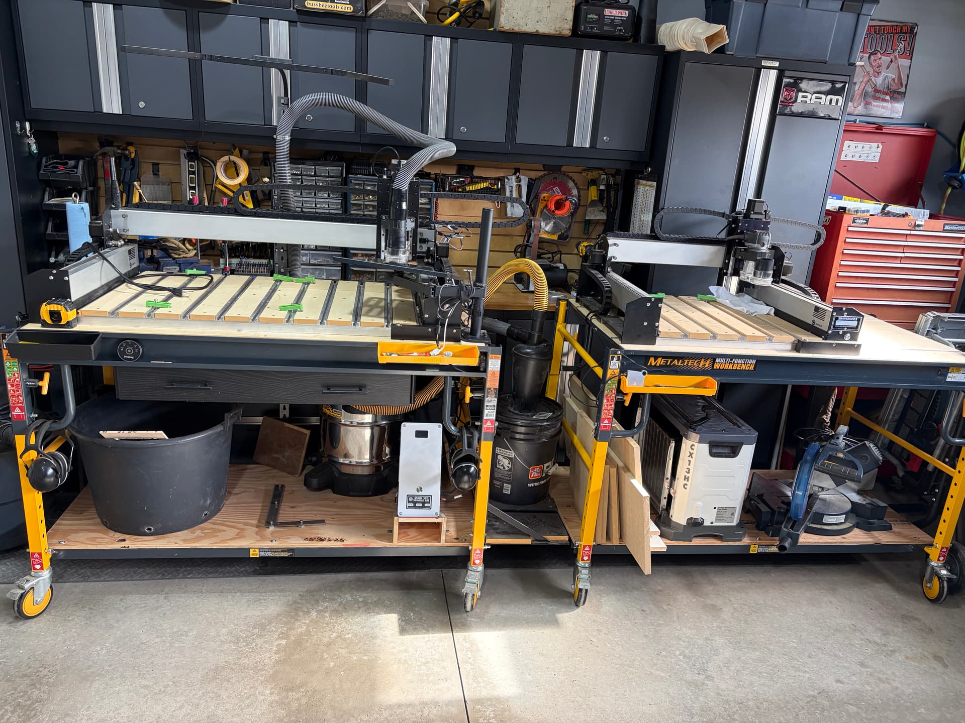

Here’s my SO4S on the right side of the pic. Its on a mobile workbench.
SO4XL mounted on the same kind of workbench on the left.
I have to move them off to the side of my garage so I can get the car in so being on moveable workbenches works good for me.
