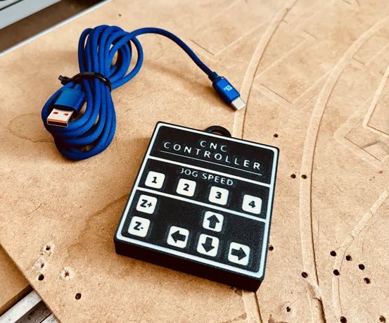

Found another one. Even smaller.
Arrow keys for moving X&Y
Plus and minus keys for moving Z axis
1, 2, 3, 4 for setting the speed
