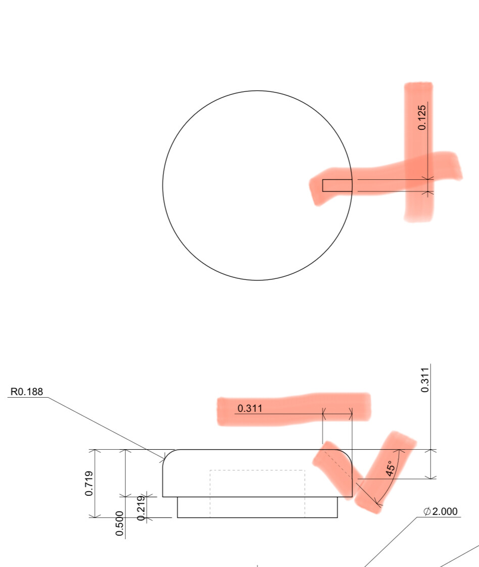

Hi, I have a shapeoko 4xxl and the free carbide create software. Is it possible to cut a sloped slot? Guessing maybe v carv option but still not well versed at using that either.
Drawing to help explain.

A V carve operation will cut that, but it’s a V carve and requires different geometry at the surface.
It’s possible to sort of make this as a series of stepped cuts which could then be easily cleaned up w/ a file or a plane float.
If you have Carbide Create Pro then this could be modeled.
Alternately, use a full-fledged 3D CAD program and 3D CAM pair.

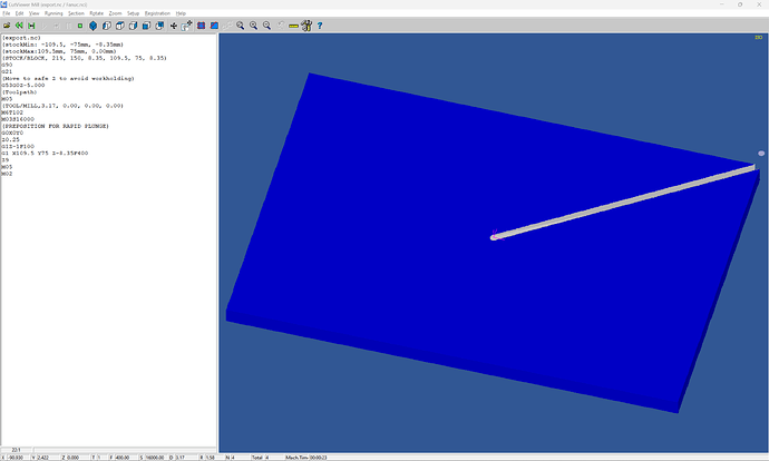

I tried to talk someone through manually programming this by editing G-code at:

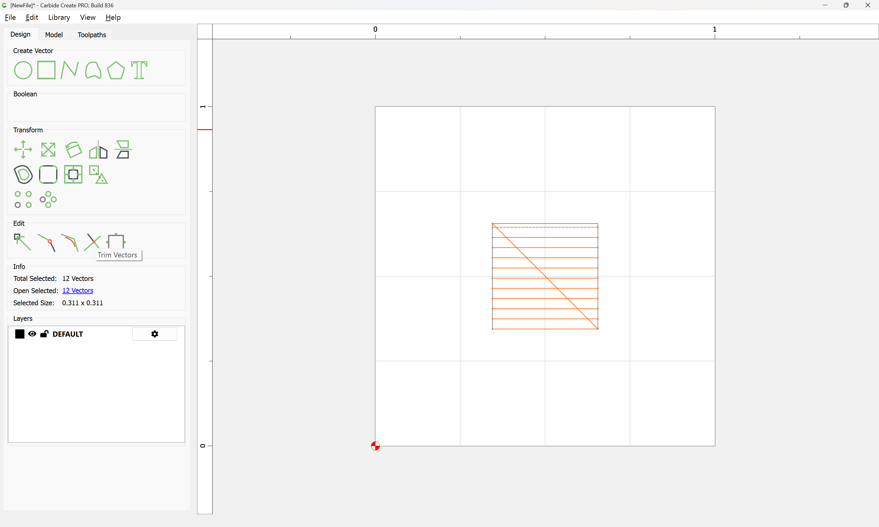

I actually use a cut like to that as an example in a project I’ve been working on for a while:
and show doing the stepped thing at:

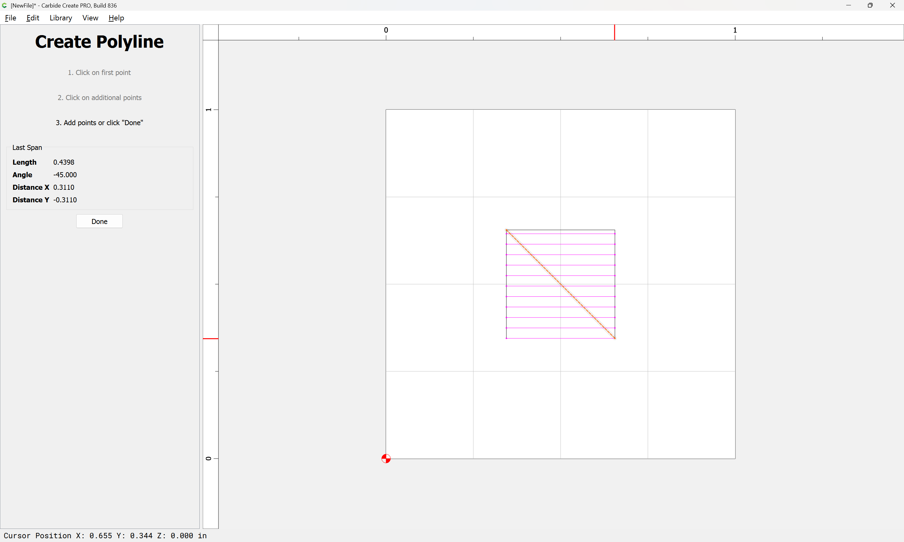

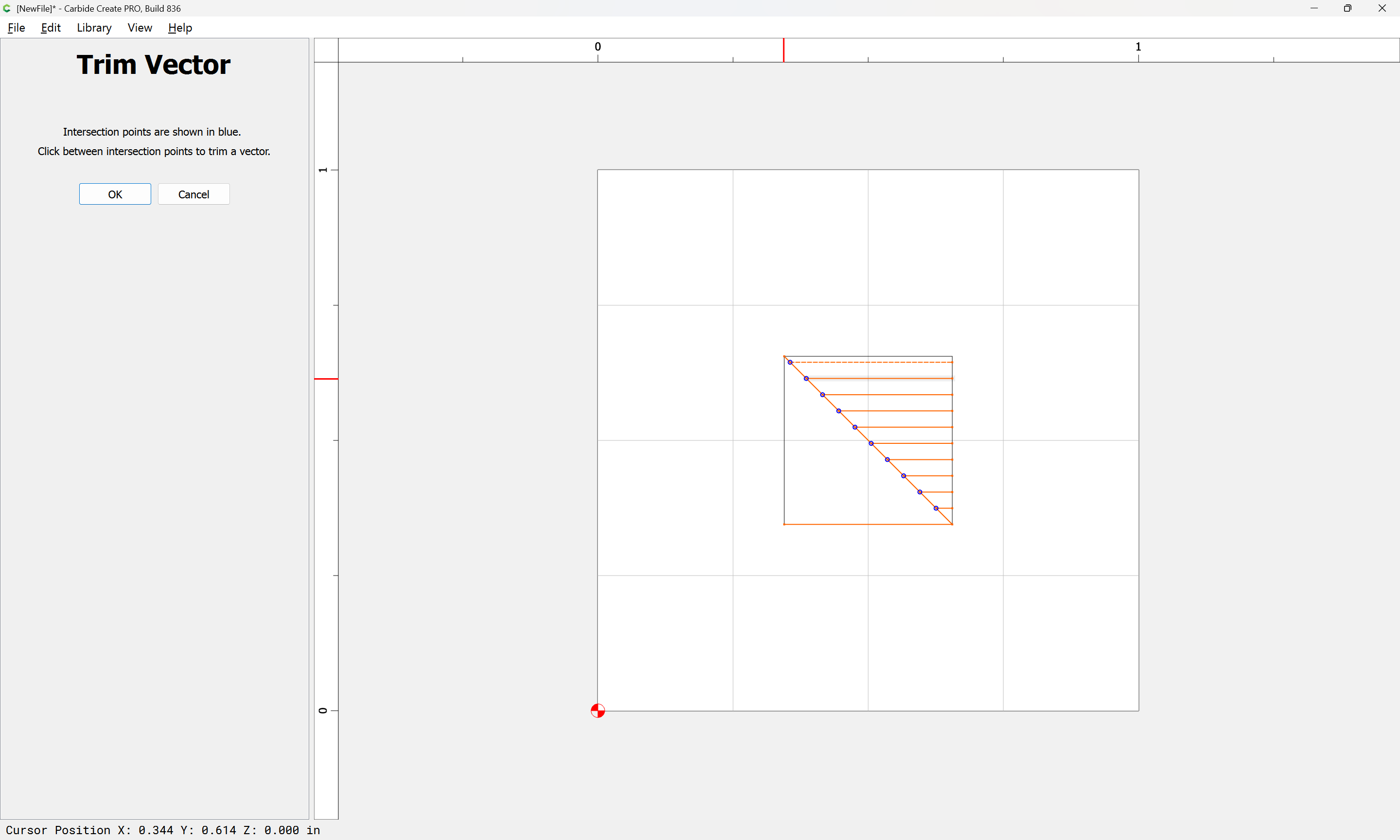

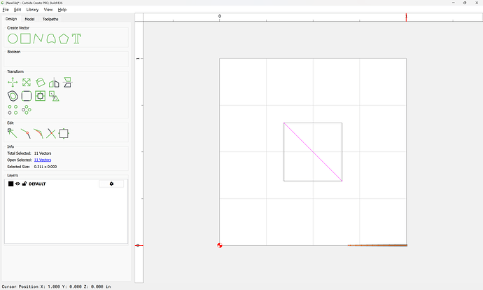

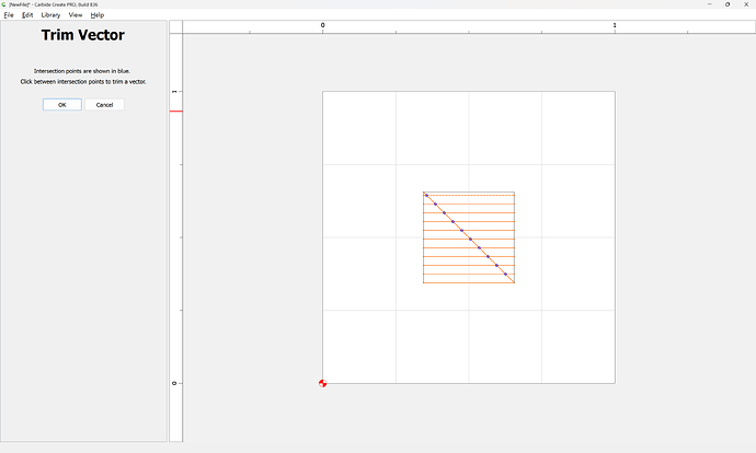

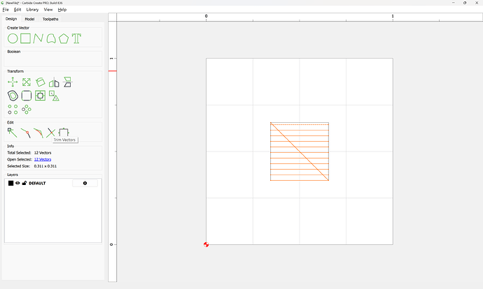

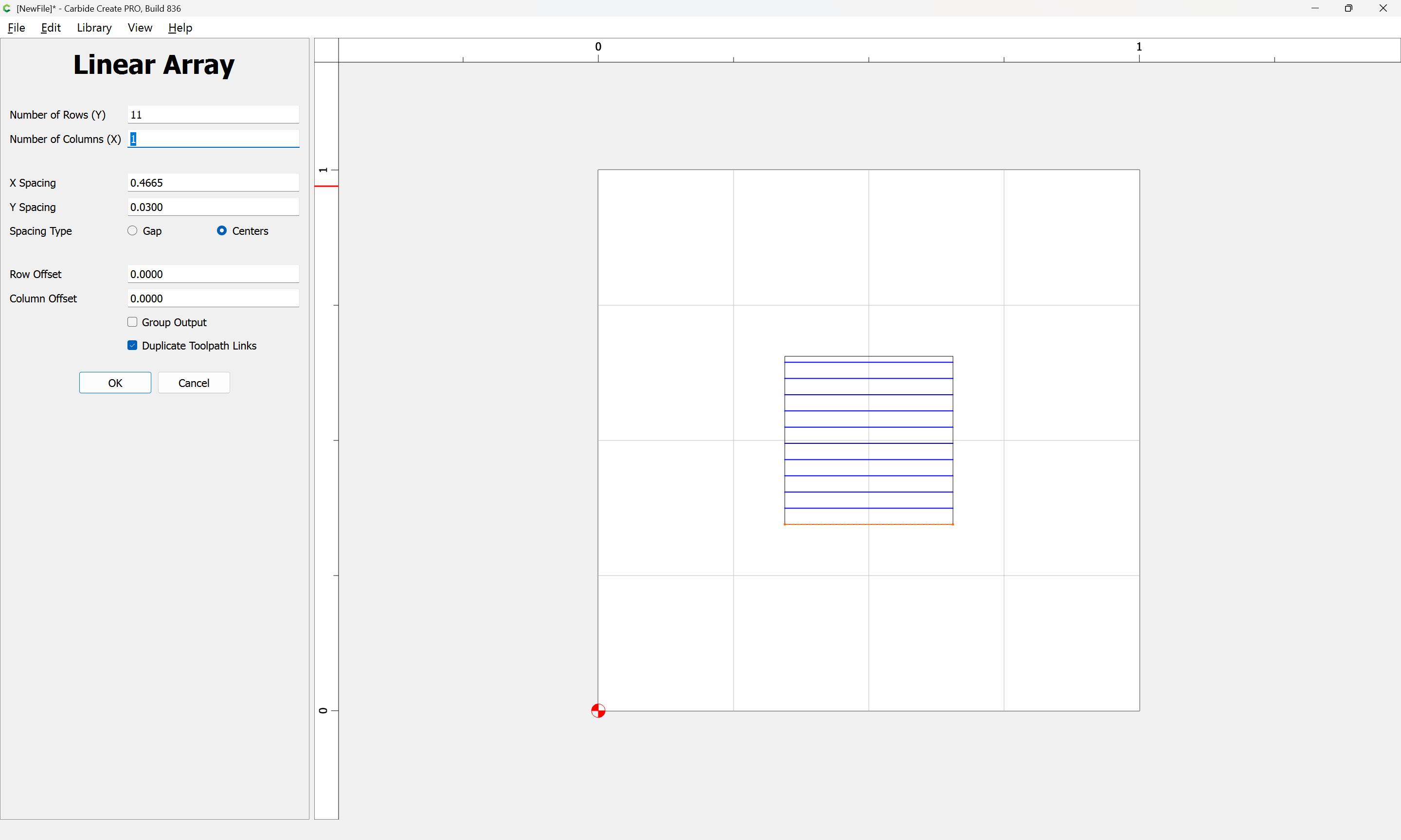

Basically you need a series of lines:

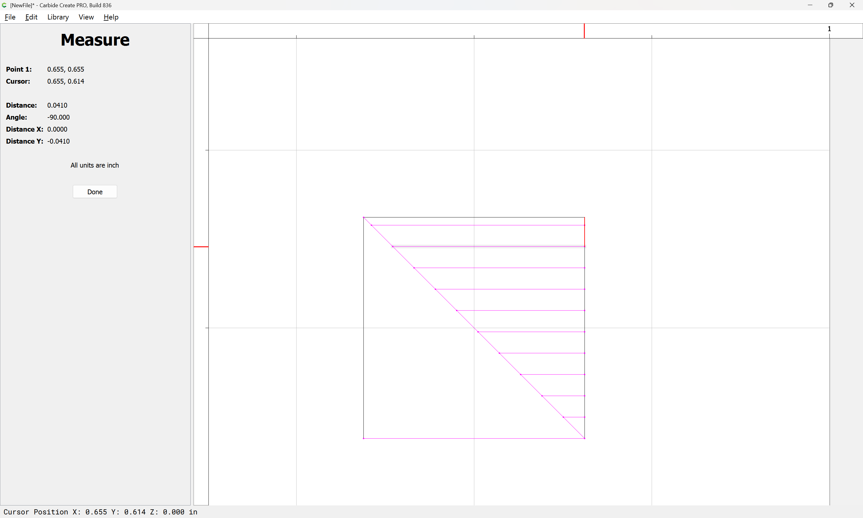

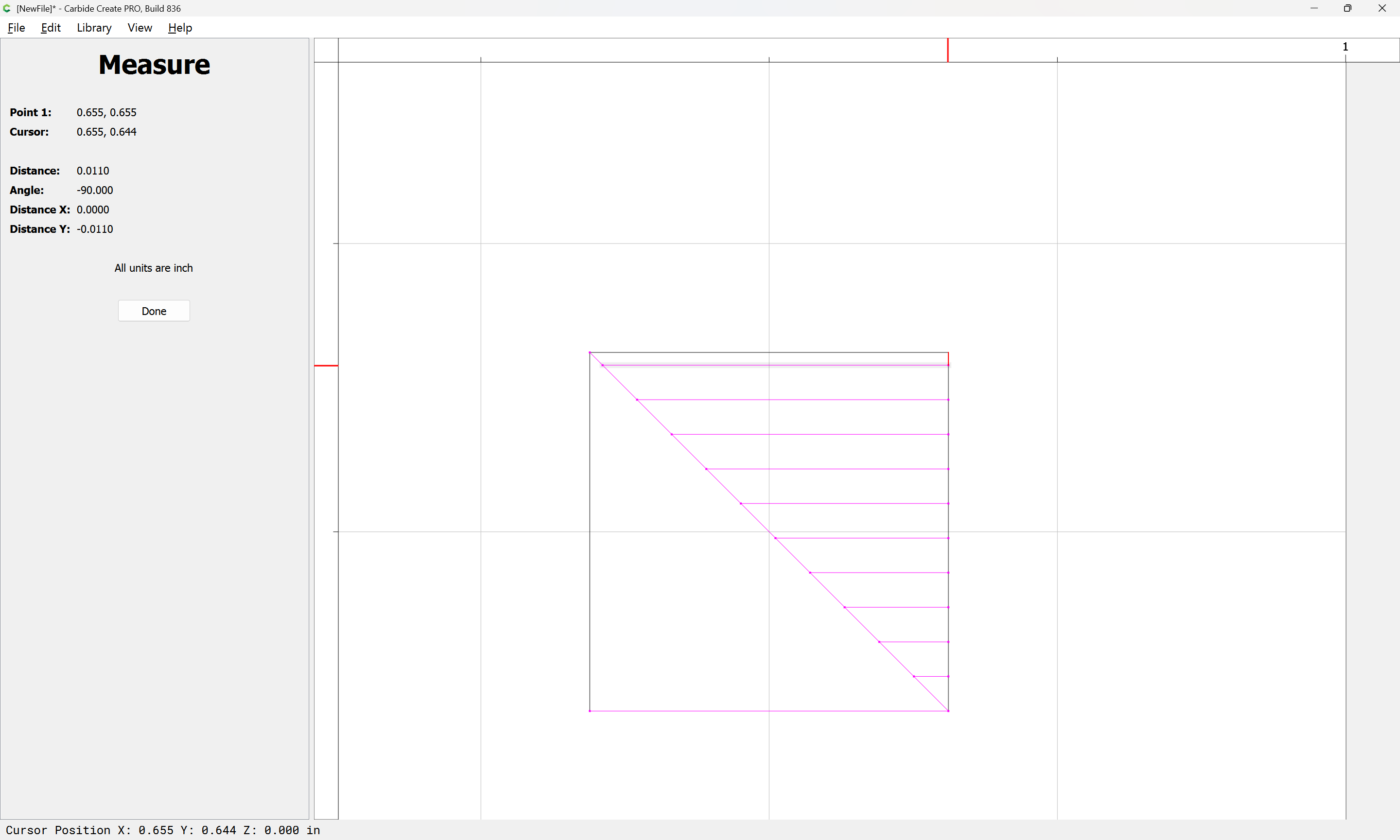

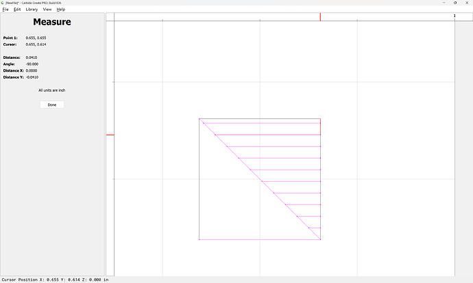

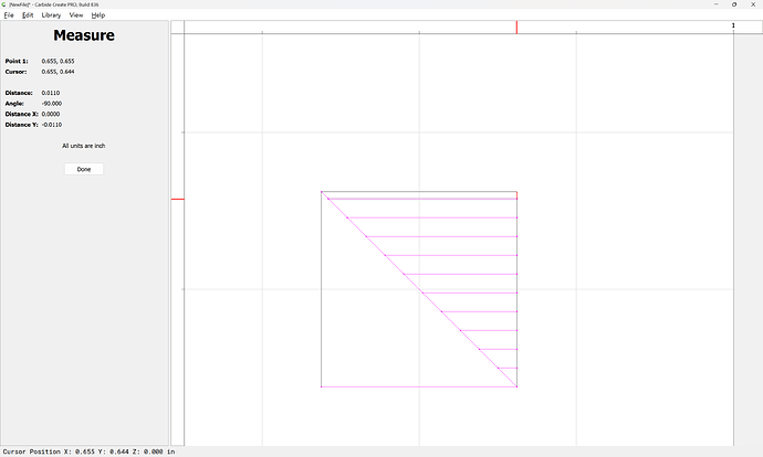

which are set up to match the precision with which you wish to make the cuts, say at the 0.030 inches of the Depth per Pass:

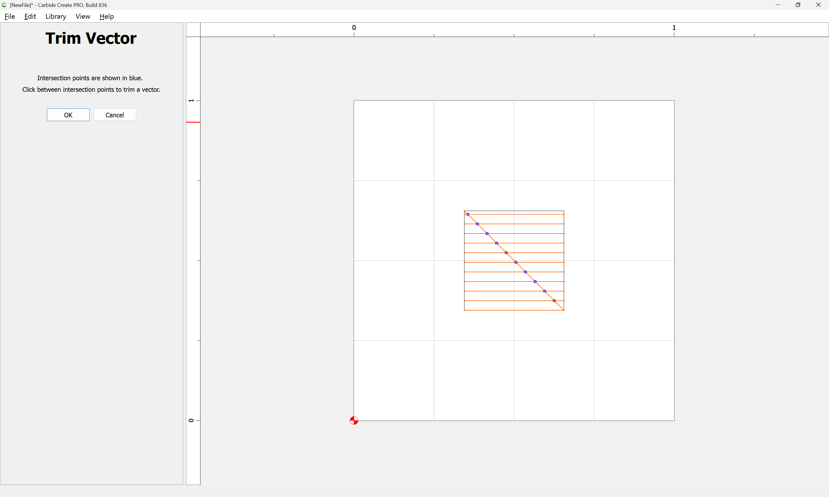

which are cut off at a suitable angle:
using Trim Vectors:

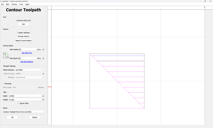

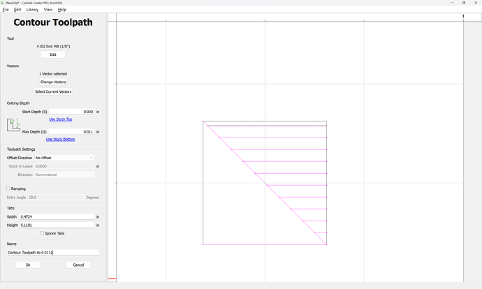

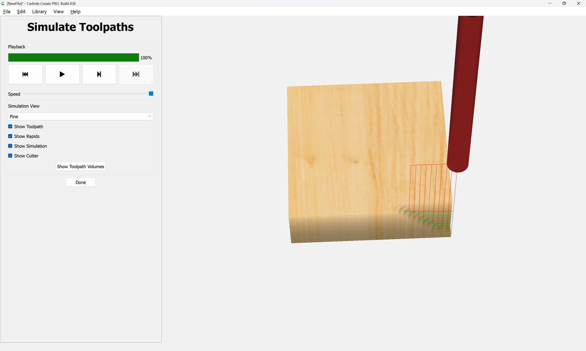

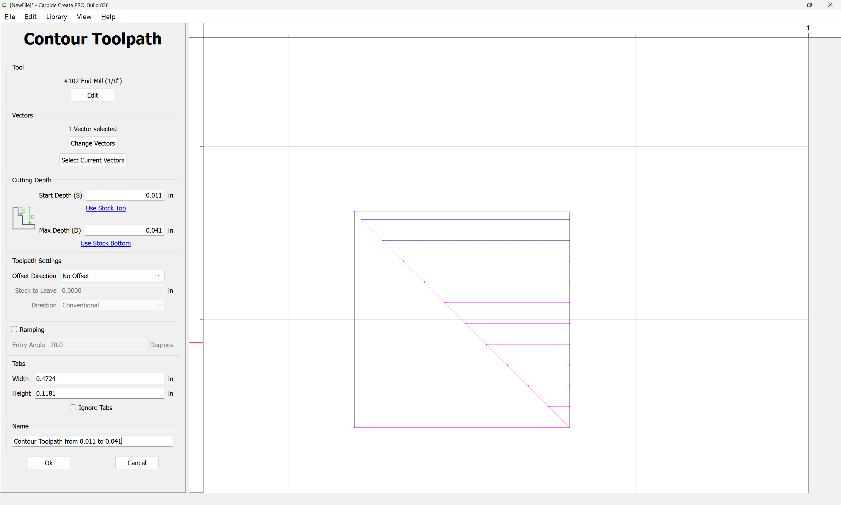

Then, for each line, assign a No Offset Contour toolpath at the desired depth:
repeating until one arrives at:

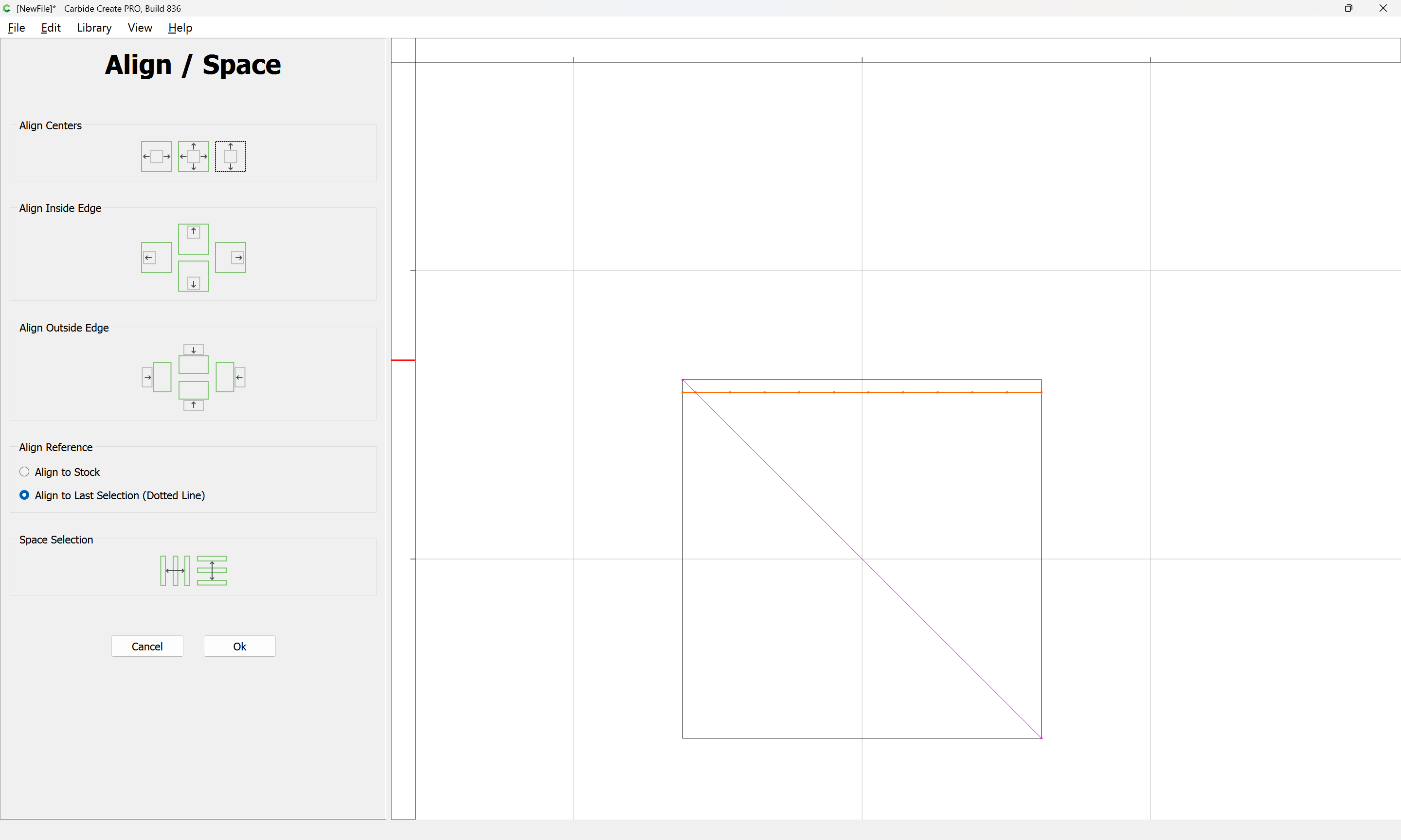

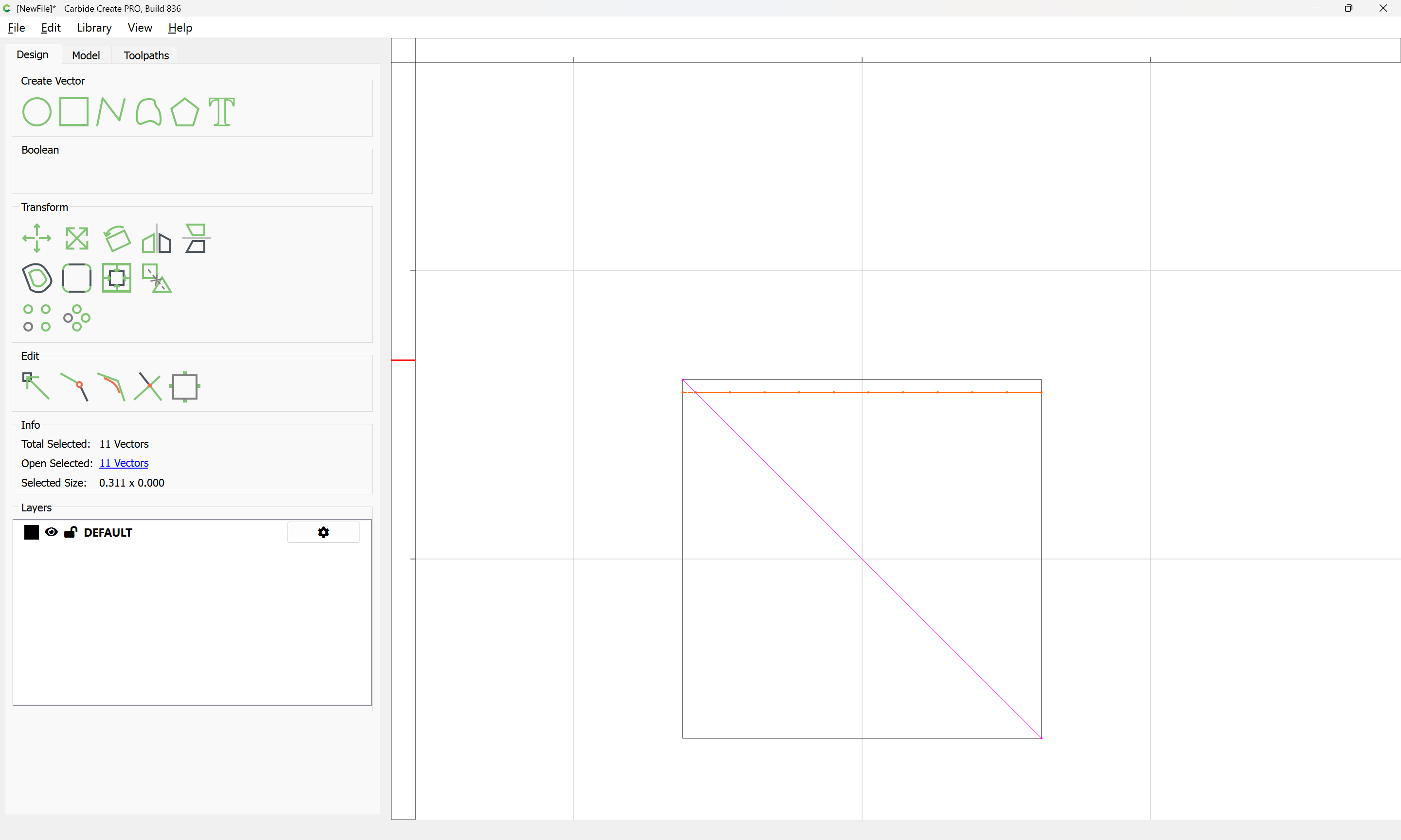

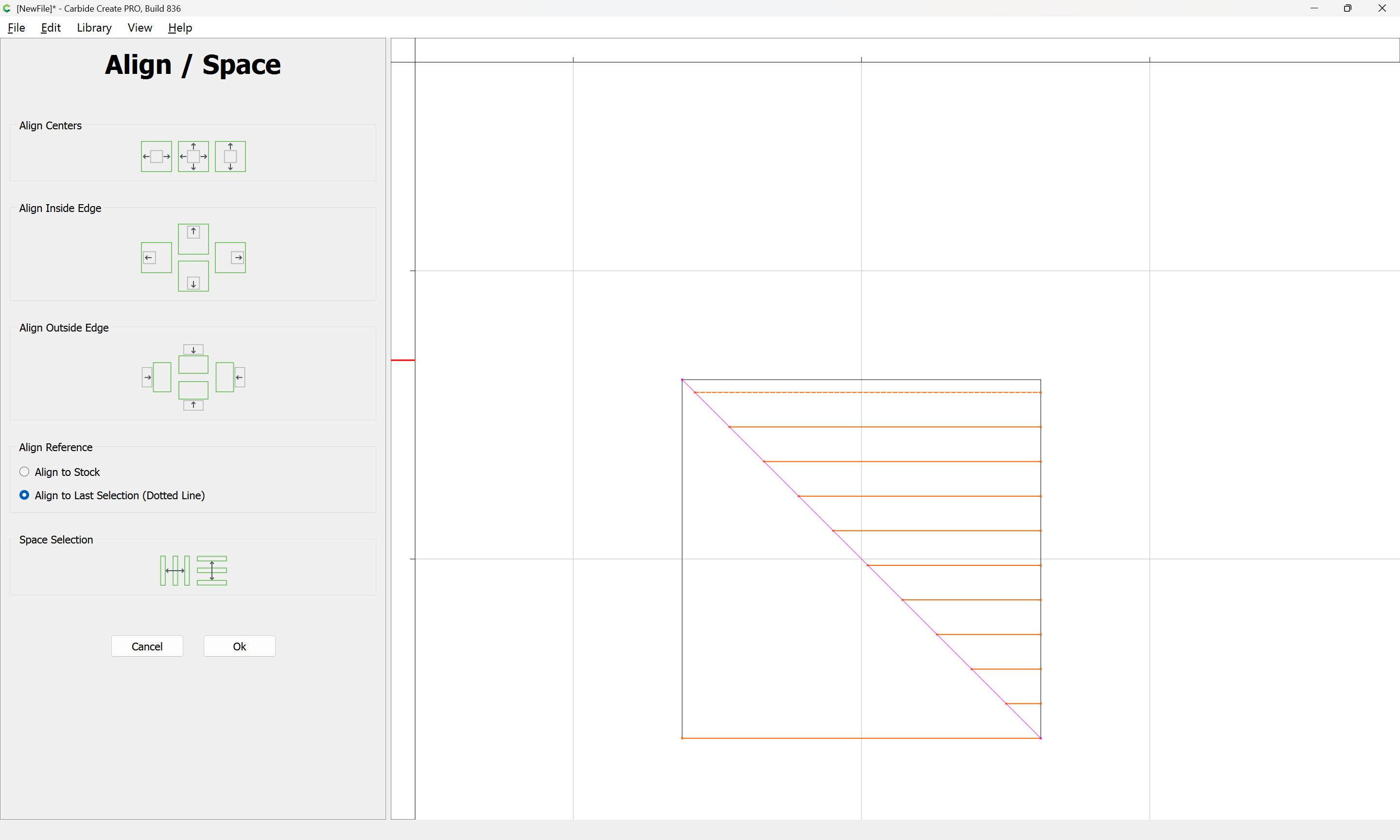

Then align all the lines:
and position where one wants to make the cut:
(and group)

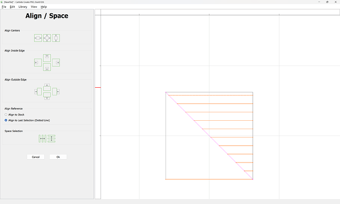

Positioning at a corner shows:
Attached as a v8 file:
stepped cut_v8.c2d (60 KB)
