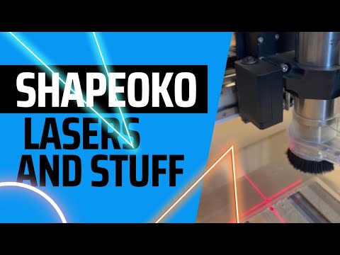

Guys, I aded another accessory to my shapeoko pro. I put a laser with crosshairs on the side of it! I have a video here on how I installed it.
The probe that carbide has is just WAY too slow I needed something I could quickly reference from my desk that’s like 4 feet away from my cnc.
I used a Multicam machine the past 8 years at my day job that had a similar laser with crosshairs and I loved it. So, I brought it to my desktop machine.

The laser line looks awfully fat in the pics / videos. Is this just meant to get “somewhere in the ballpark” ?
Yeah I focused the laser after. The camera distorts it too.
There is a little Gcode for the quick actions that make it super easy

My two cents on the fat laser line. When I use a laser or shadow line for other projects, I never use the middle of the line. I use the edge of the line for a more accurate point.
I would do something like calibrate it for the upper right corner of the laser intersection point. Move the laser until it just barley starts to hit the lower right edges of the project board. So on the edges of the beam pattern not in the middle of the light.

So this would be good for jobs where you set the zero close to the corner & then cut the perimeter of the piece. Not so good when you’re trying to hold tight tolerances.
