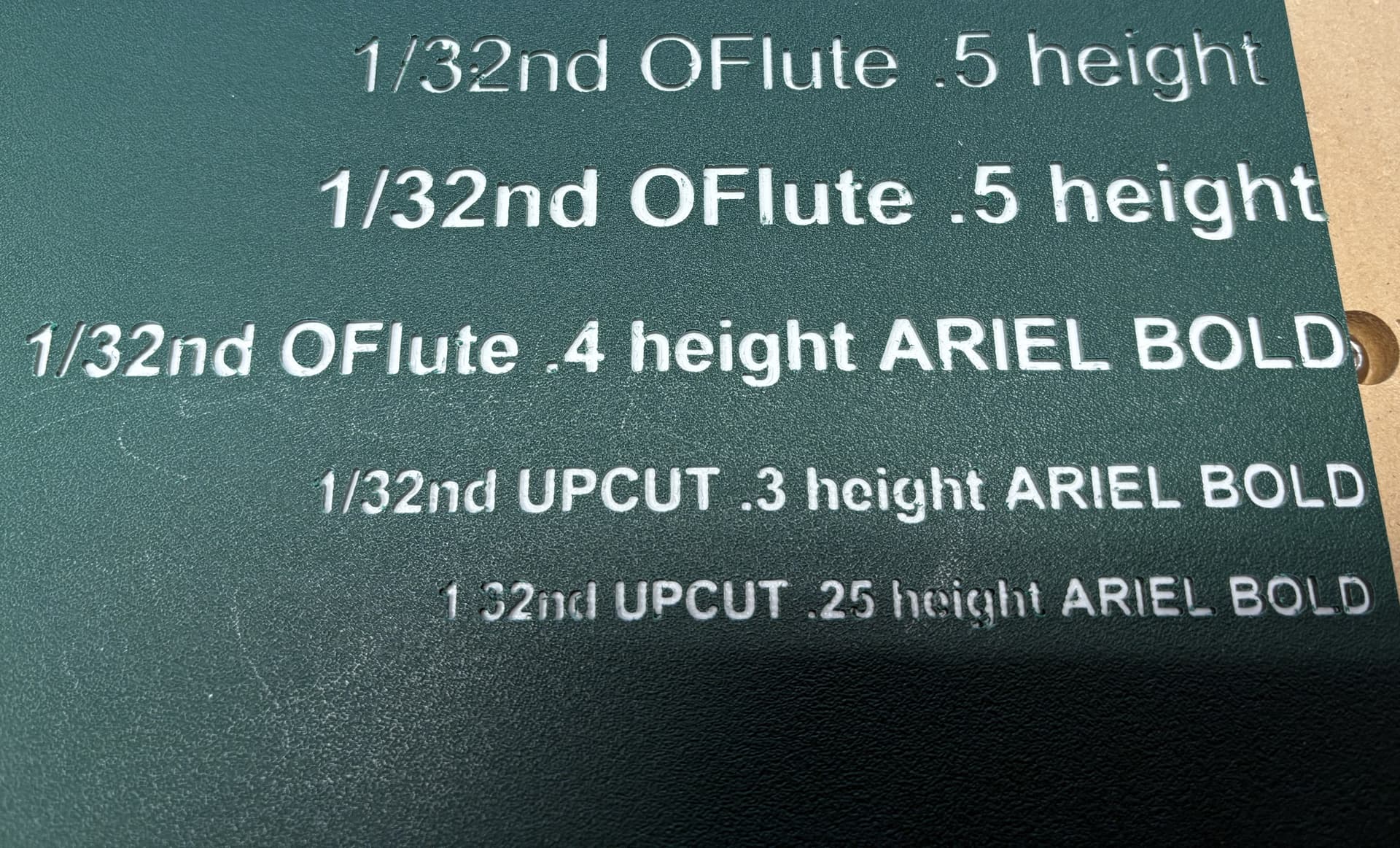

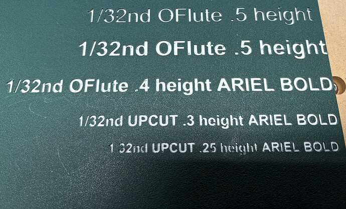

After much trial and error, countless people helping I have solved my version of the need for small text.
Up to this point I have always been using contour or Vcarve bits to try to do text. It was always bad, between fuzz and break through of the tool paths. So I got the 1/32 bit, this is a game changer. Still had some issues due to the way fonts are made. I needed single line fonts.
Out of curiosity I tried the pocket with the 1/32 And bam. Clear concise text down to .250 Absolutely opens up my possibilities. Thanks for all that helped. Pardon the errors in the text, I didn’t change all of the parameters.
