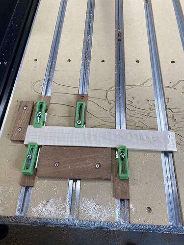

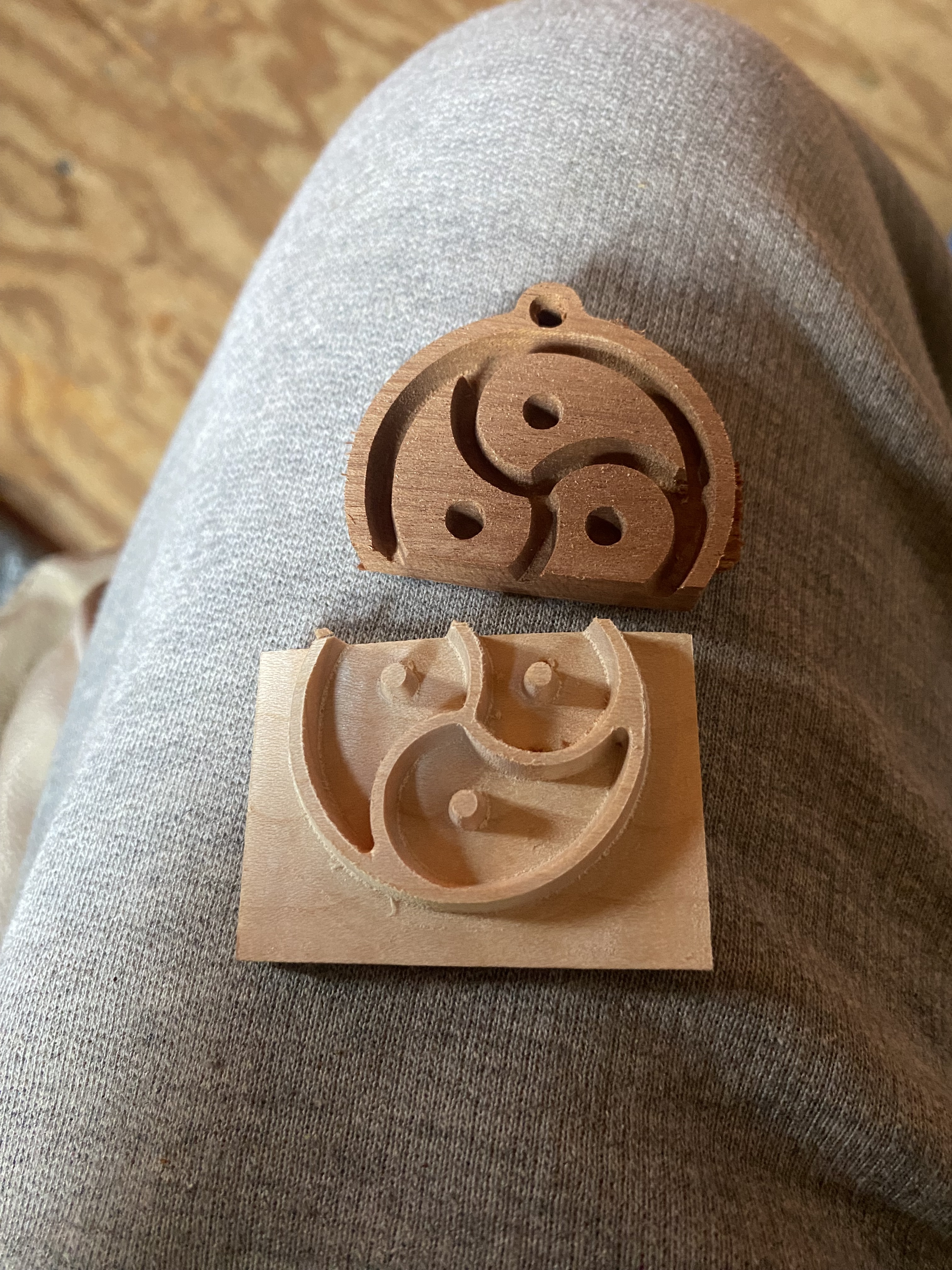

I took a bunch of pictures of the process in hopes that may help figuring out what I’m doing wrong.
As you can see even with those settings, I’m still touching the bottom and there’s no glue gap?

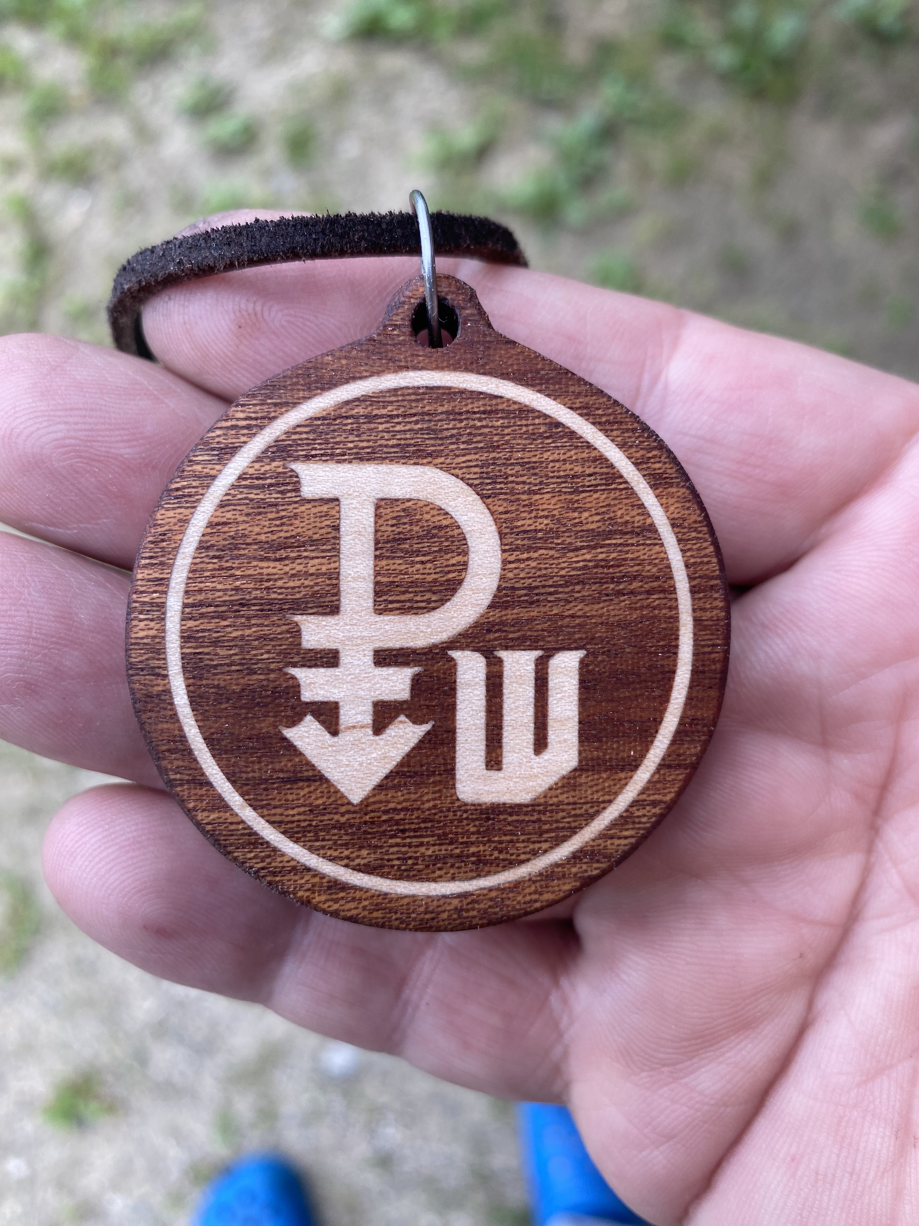

Here is the very first inlay I made it came out flawless
The piece of wood used on this inlay was about .1 thicker then the ones in the file above.

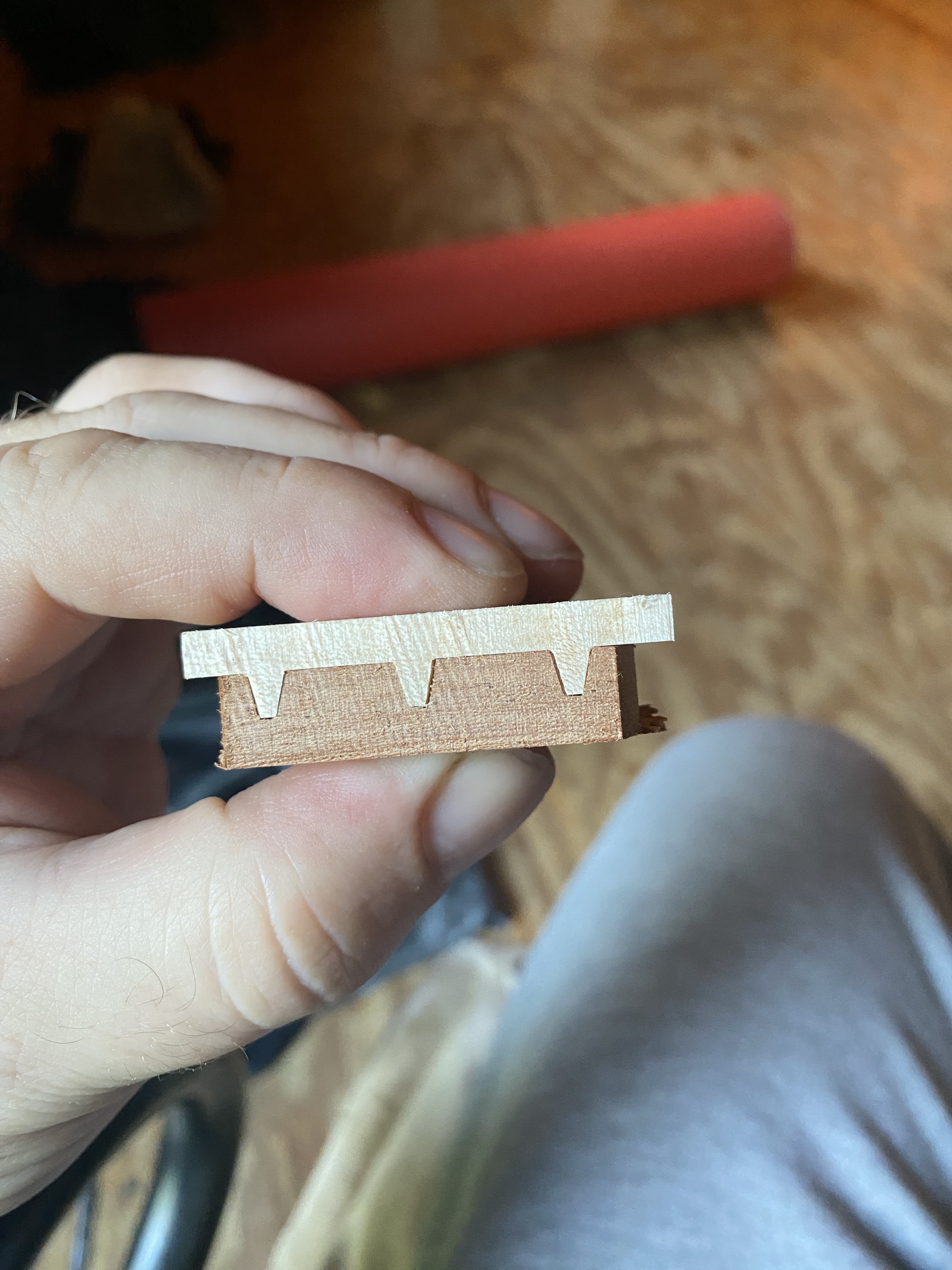

If the stock is thicker than planned, then the width of the pocket will be wider, and the top of the male (which becomes the bottom when you flip it over) will be narrower. You want the bottom of the male piece to be just a little bit wider than the bottom of the pocket so it doesn’t bottom out & you get a tight fit on the sides.
If you measure the height on this cross section, is it larger than designed?
There should be a bit more gap at the bottom, and at least some gap at the top.

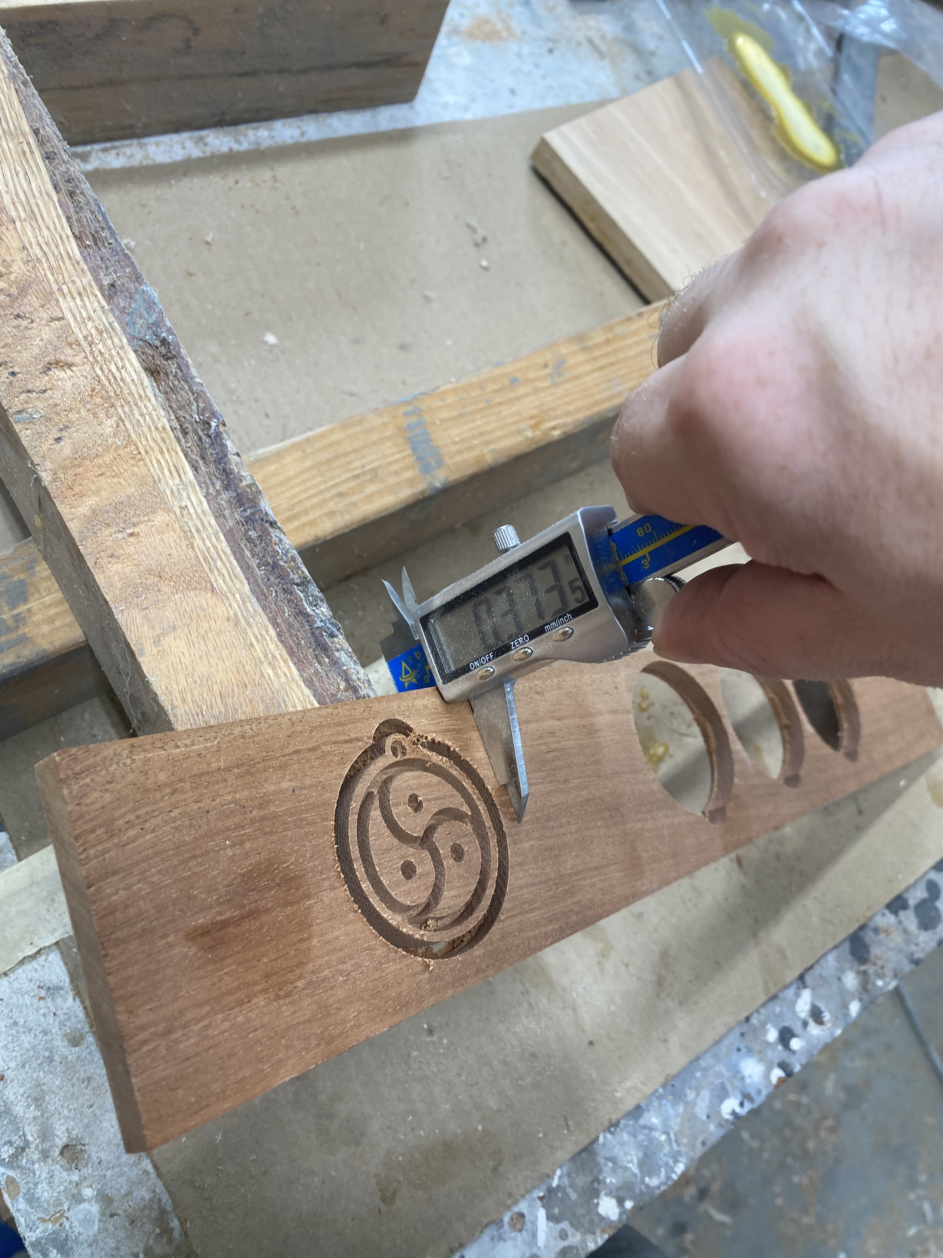

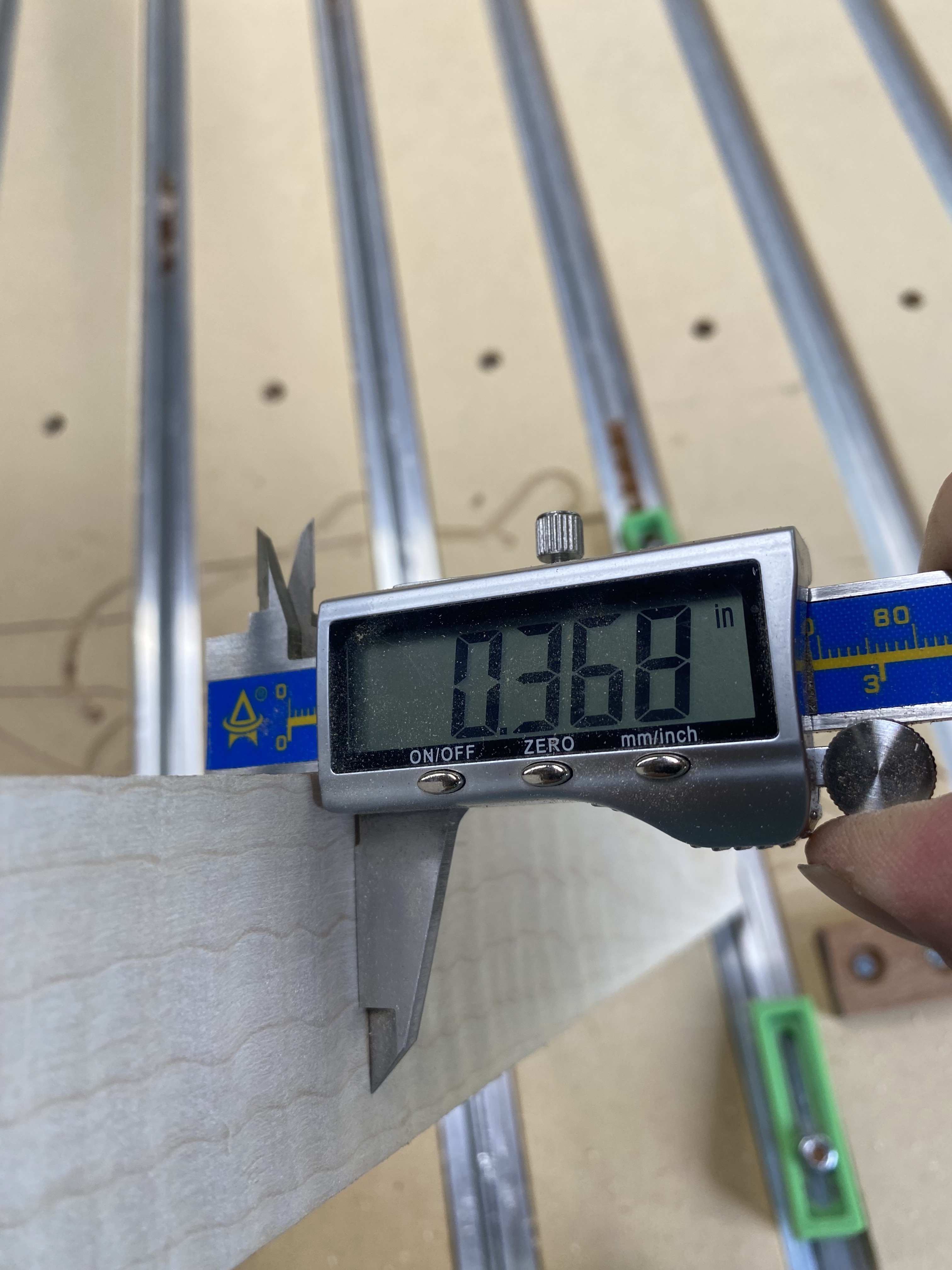

I stock is extremely close to the right thickness. As far as I can tell it comes out of a high end thickness planer, which does have some variance but it’s a 3 hp industrial grade delta so there’s a few hundredths of an inch in difference is that enough to make a problem.?
I even posted the file and the caliper measurements that they showed in case anyone was able to check that that was close enough. As you can see, they are still bottoming out and all the pieces are the proper thickness as far as I can tell.
