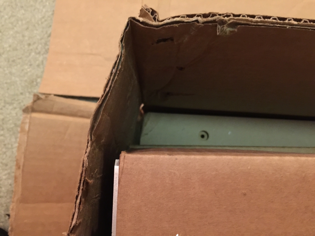

As you might have noted in the previous picture, the inner container has moderate damage on this one corner despite the outer shell not showing any indication of such. This is the root cause of the casualties I mentioned and will become obvious in forthcoming shots

Now, back to the corner damage…let’s take a peek down inside the container to see that things are not all well…
Here’s what the wasteboards looked like removed from the carton - these are 42" x 19.75" each, for the record
Now some closeups of the corners that were crushed…one wasteboard is worse than the other…I’m not pleased with this, but I don’t know if ultimately the damage will cause any mechanical or precision issues were I to assemble as-is

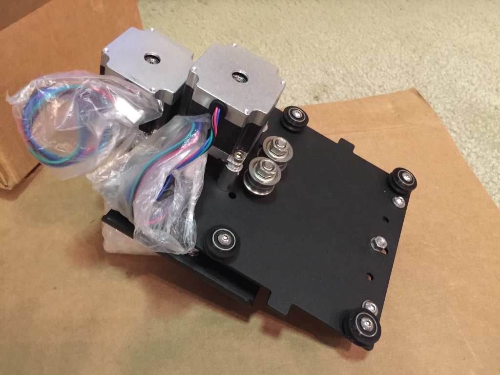

The gantry assemblies are individually boxed and marked left and right - This is the left side assembly as shipped. Note that the stepper motor cable/connector is only about 14" in length which is a problem…
…and this would be the mirrored right-side assembly…Note that the stepper motor cable/connector here is also only about 14" in length which is a problem…

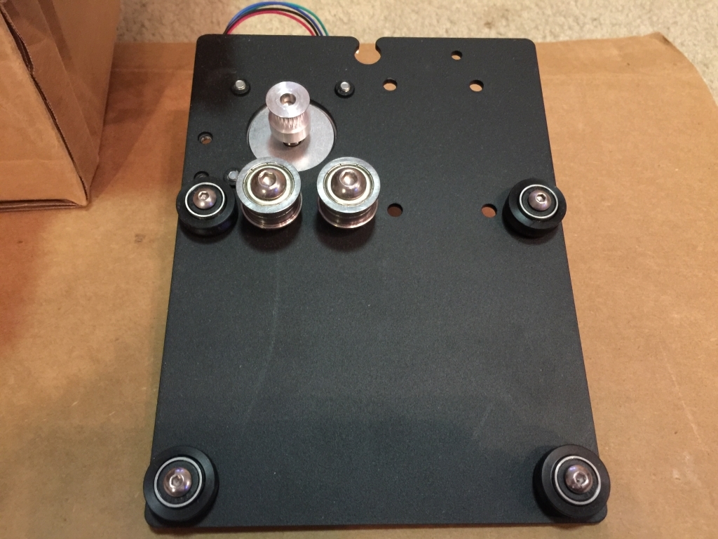

Now for the one most folks are probably curious about…the Z-Axis assembly. I’m providing many shots and angles here to try and answer any questions people might have. Again, this is all pre-assembled and boxed separately. I will mention that it looks like the belting here is only 6mm and not 9mm like the X and Y. Perhaps there wasn’t room for a wider belt and pulleys?
The XXL kit (and maybe the XL?) took a different approach. No more PITA criss-crossing straps that were a nightmare to line up. The following are the 3 beefy cross-straps with folded edges. These run perpendicular to the end straps and parallel to the Y axis extrusions

  1. Box damage of the INNER container only which seems to have resulted in two banged up wasteboards.
  2. At least one of the pre-assembled V-Wheels is really tight to the point where they almost don’t move without considerable force. The other V-Wheels spin freely as expected.

  6. The stepper motor leads and connectors are all approximately 14" long. I can see these probably working for the X and Z motors to the PCB, but I can’t fathom how the Y motors can reach the electronics without much longer cables. I went back and looked through the accessories box and can’t find any sort of extensions or other options that would make this work.
Thank you for passing this info along! We’ll see about adding some corner protection before shipping any more!
  1. At least one of the pre-assembled V-Wheels is really tight to the point where they almost don’t move without considerable force. The other V-Wheels spin freely as expected.
Can you check to see if there is a shim (washer) between that hard to move v-wheel and the plate. We’re working through our QC process for these plates and I can see that missing a shim is a potential error that could be made.

  1. The stepper motor leads and connectors are all approximately 14" long. I can see these probably working for the X and Z motors to the PCB, but I can’t fathom how the Y motors can reach the electronics without much longer cables. I went back and looked through the accessories box and can’t find any sort of extensions or other options that would make this work.
You kits should have shipped with 4 extension cables. They would have been in the same box as the Drag chain, tools, and power supply. If you’re missing those - send an email into support (support@carbide3d.com) and we’ll get the missing piece shipped out ASAP!
