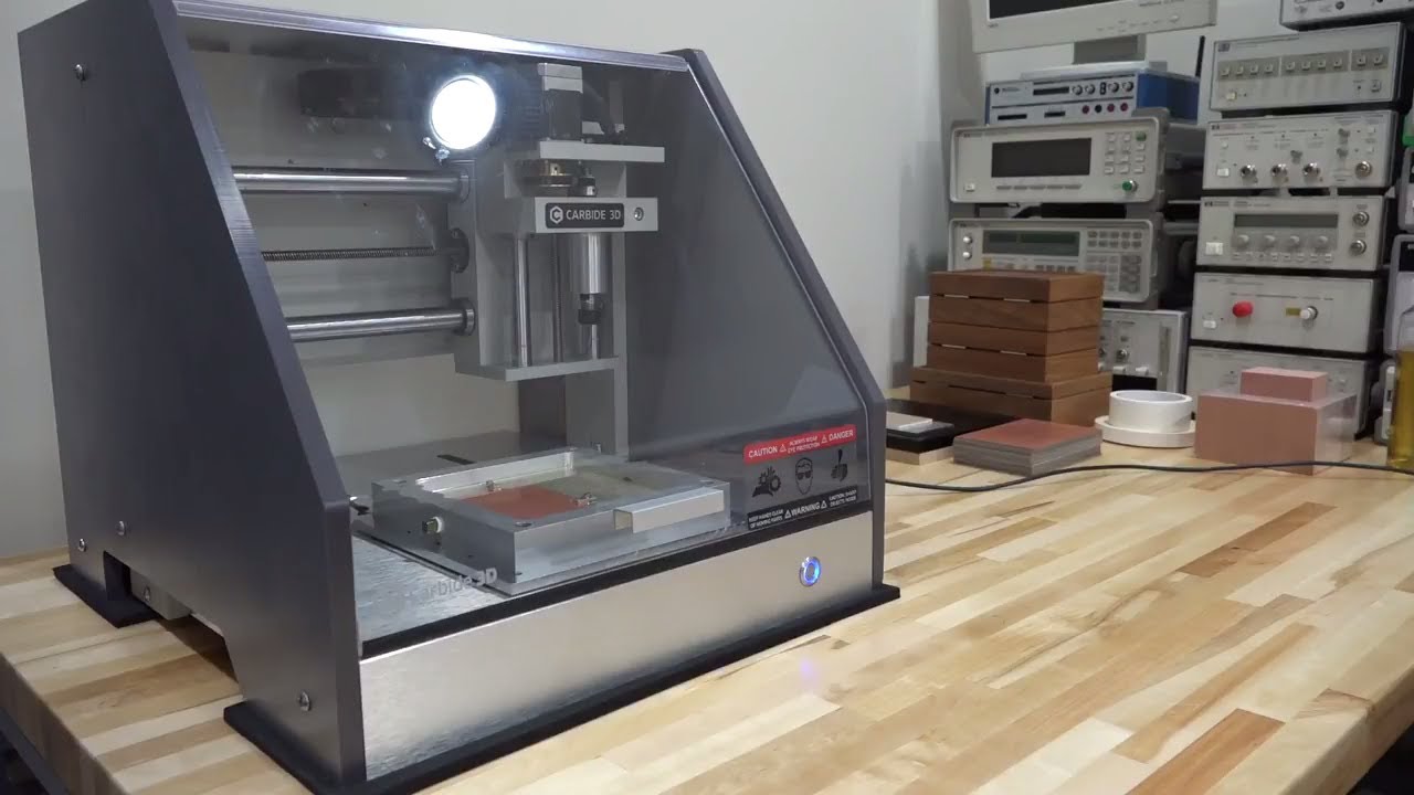

Hi, I am trying to machine some soft iron/ soft magnetic alloys as core for electromagnets. Does anyone have experience with this on the Nomad3 or any recommendations on setting and cutter? I know it will be difficult but I am wondering if it can be done!
Could be possible? This was shown on the previous gen Nomad (883 pro), so new Nomad should be doubly capable (higher rpm).

Thanks for all the great comments! So I am guessing I will have to install some kind of vacuum system to get all the dust out. Otherwise what are the cutters you are using on the nomad? Are the coated ones from Carbide3D just fine? Also coolant is obviously not really possible buy I read some post recommending it and others not. Any advice?
The Carbide3D cutters are ZrN coated, which is primarily intended for nonferrous metals. For iron you want AlTiN, TiCN, TiN or TiAlN. Or just plain uncoated carbide.
I actually recall seeing someone who made a little dish on the bed so the part could be submerged, can’t find it right now though…
And even if flood isn’t possible, there are other ways.
No to the vacuum system. Just do a thorough cleaning and wipe down when you are done. (and no air blast).
Cutters: Coatings are not necessary for cast iron, and in fact will not help. (I like these for cutting Steels): HQMaster CNC Router Bits 3.175 Router Bit 1/8 End Mill from Amazon (Jungle Place) at $1.50 Ea.(Yes, you read that correctly) in a pack of 10. In steels, they cut just as well as the Carbide3D #102Z cutter. IF your design allows for a 1/8" cutter.
Coolant: I do recommend the WD40 (or similar) drip can system. I am using Sta-Lube SL2512 Soluble Oil (From the Jungle Place) at a 10:1 ration, in the WD40 Drip can for cutting steels (any). Cool cutters last longer (fact)
