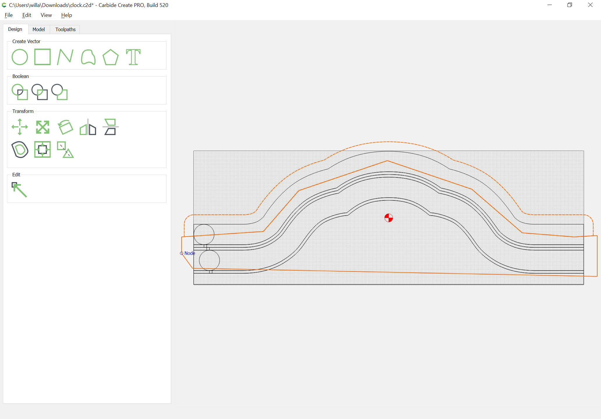

I am about to make a replica of this clock,the question I would like to ask would it be possible to make the top surround on the shapeoko??It is about 30 mm thick and approx 270 mm wide.Any thoughts would be very much appreciated.
Yes, but it won’t be possible to get a 3D preview of the rounded out top portion of the molding if using Carbide Create — it doesn’t support cove radius endmills:
One question is what sort of stock will you use and how will you work it? Options are:
  • a single piece of wood which you remove a fair bit from
  • smaller sections which are pieced together which will allow more efficient stock usage
First thing is drawing up the outline of the design, and a profile of the molding along w/ dimensions — if you can provide a rough outline of the latter we can apply it to the former which would be easily drawn up from your photo:
Once the basic outline is drawn up:
It’s simply a matter of offsetting it as necessary to to achieve the geometries needed to cut each level out.
clock.c2d (1.1 MB)
then assigning the toolpaths necessary to cut out each level (assuming using a single piece of wood for the stock (gluing it up might be expedient).

Here’s my approximation of the profile:

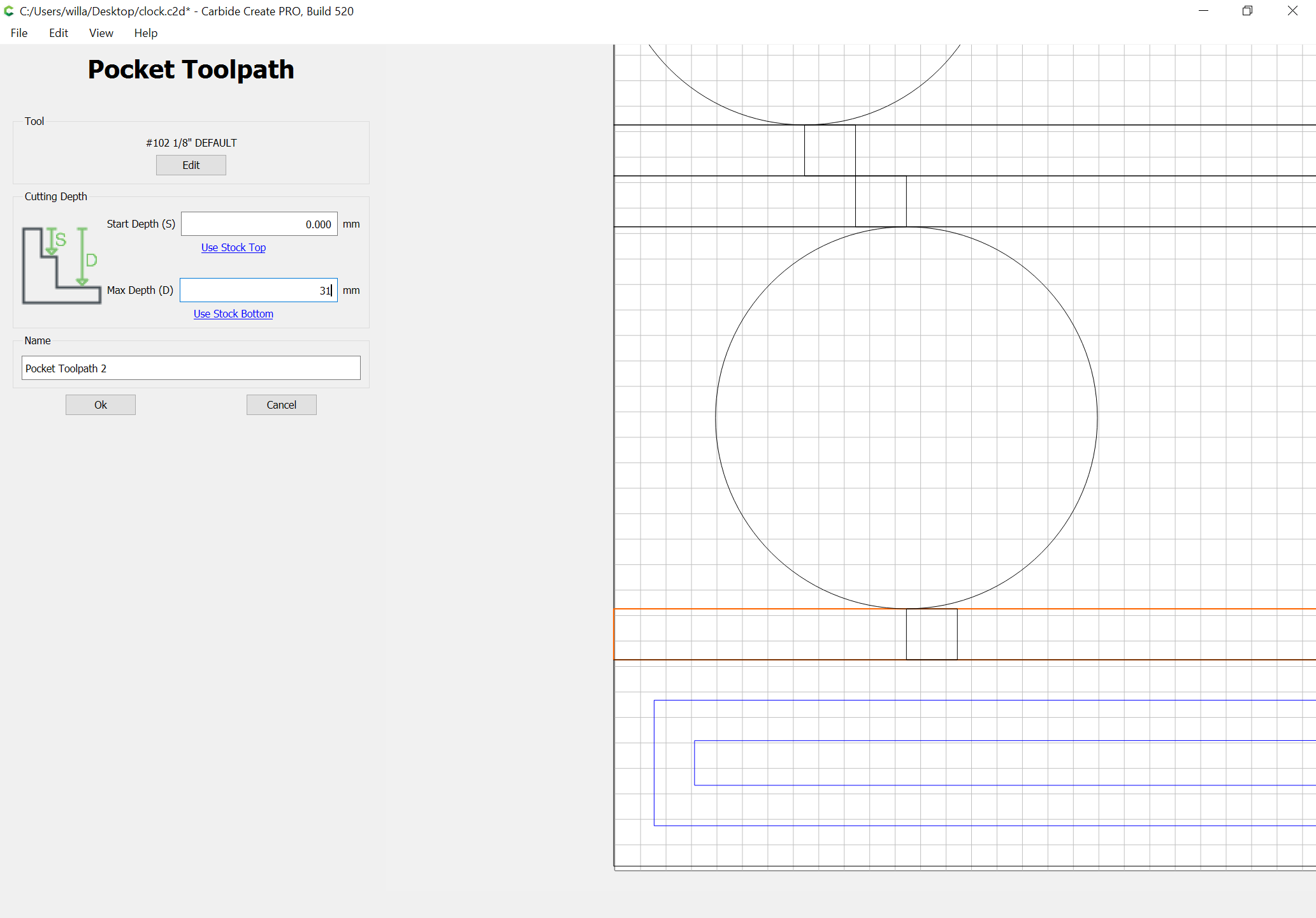

Cutting it out would be a series of pocket and other toolpaths:
Here’s the file for you to experiment w/ — let us know what you work out about the ball-nose and cove radius endmills.

Hi Will,I need some help,the file you posted is brilliant but I only have one problem I can not work out,that is how do I set up to cut a contour cut on the top of the carving as per the photo,I am fine every where else but this has stumped me.
Okay, to create a cut which will only remove material along the top you need to offset by the diameter of the endmill plus 10%, so:
Then you need to reduce that to less than the original geometry:
Boolean Subtraction:
Delete the unneeded geometry, if need be duplicate the original, then select the remaining offset geometry, shift click on the original so that it is the key object (indicated by dashed hilight):
and clean up the corners:
