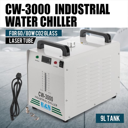

If you do buy the water cooled spindle kits, you’ll need a reservoir, the aquarium / pond pumps they come with are completely inappropriate specification and cheap noisy junk so you should probably just save yourself the trouble and buy a proper cooler, something like this
You don’t need active refrigeration, just a tank, radiator and fan.
