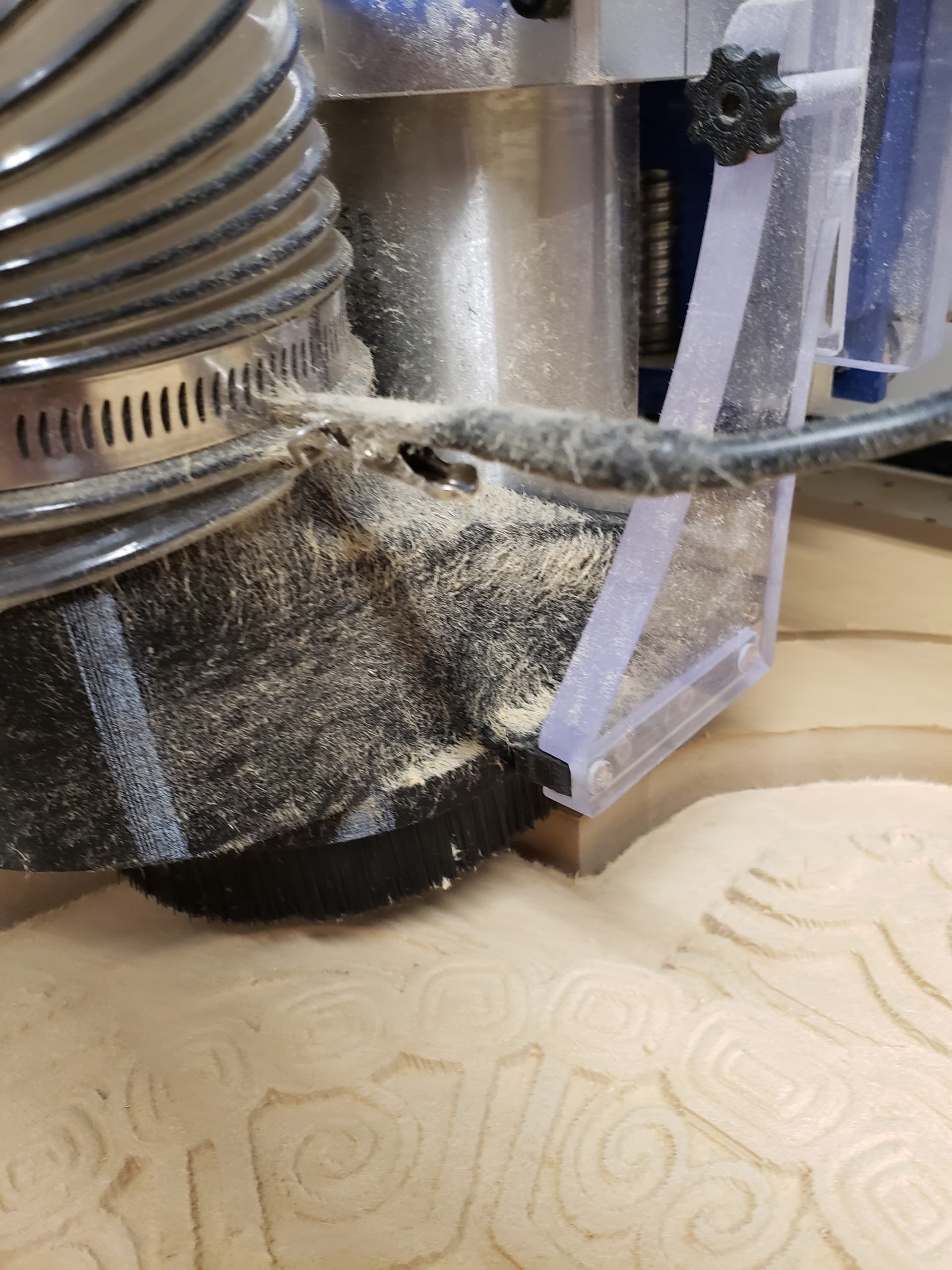

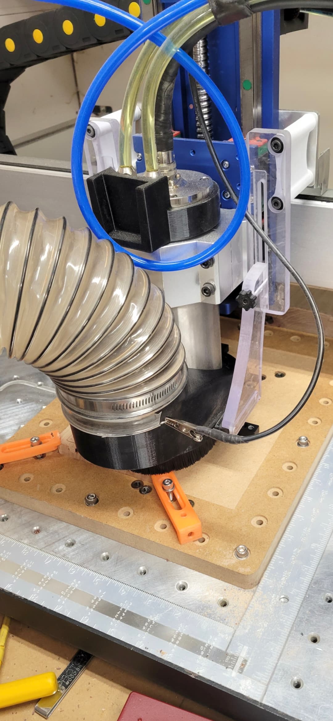

I bought a vinyl hose with the steel spiral reinforcement, and peeled back the vinyl coating to expose the wire. Because it was going to be temporary (hahaha!) I just clip on a ground wire at the spindle after I put on my dust shoe. I have only had two? disconnects since I did that, and both were when I forgot to put the ground wire on the hose.
Better Pic of the ground strap.
