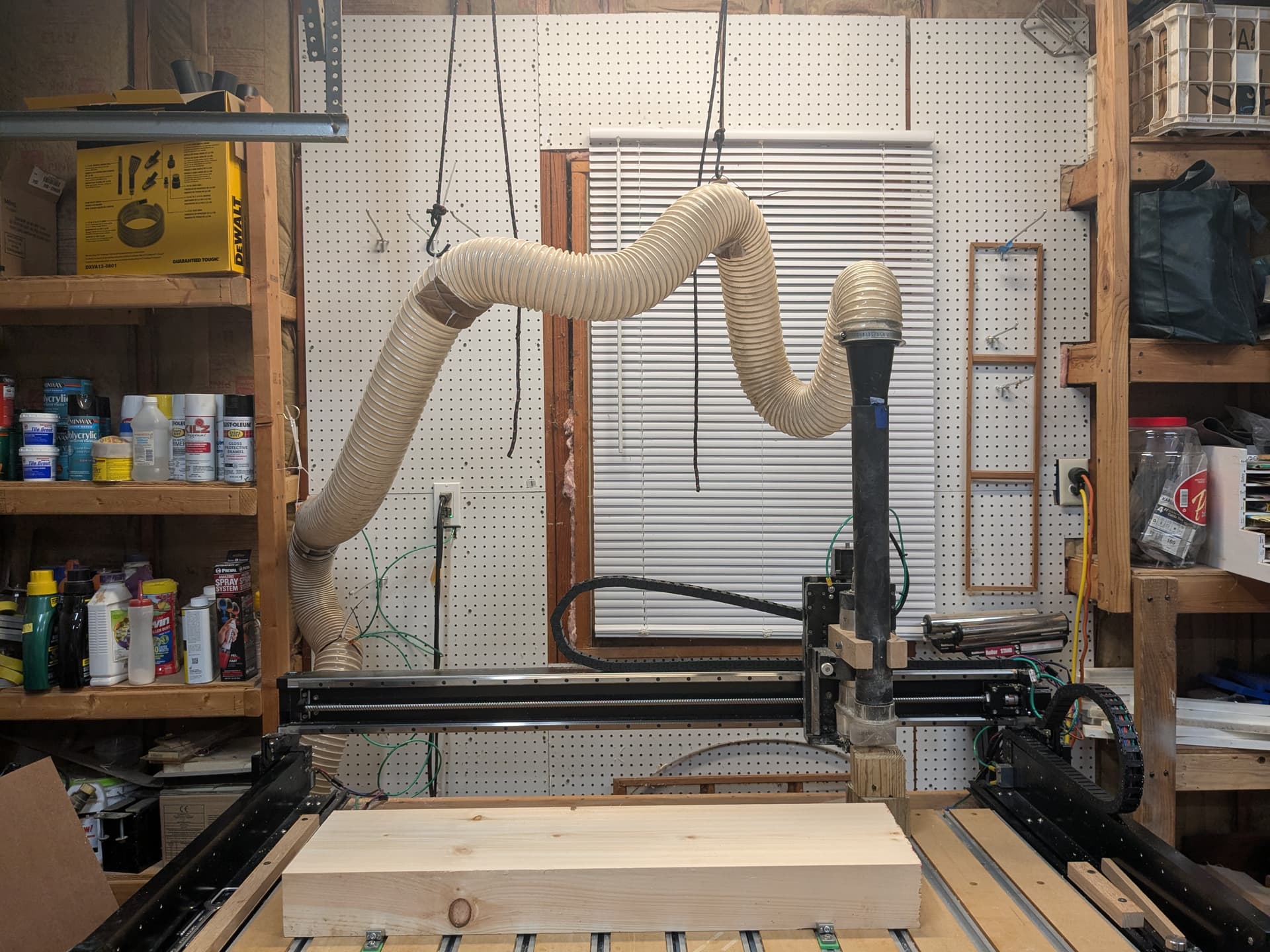

If you have the head room, this is what I did.
The game is the hose loops. Test it by plugging the suction end hard and watch the hose.
My hose collapses axially quite a bit.
I have changed my hose locations since this picture.

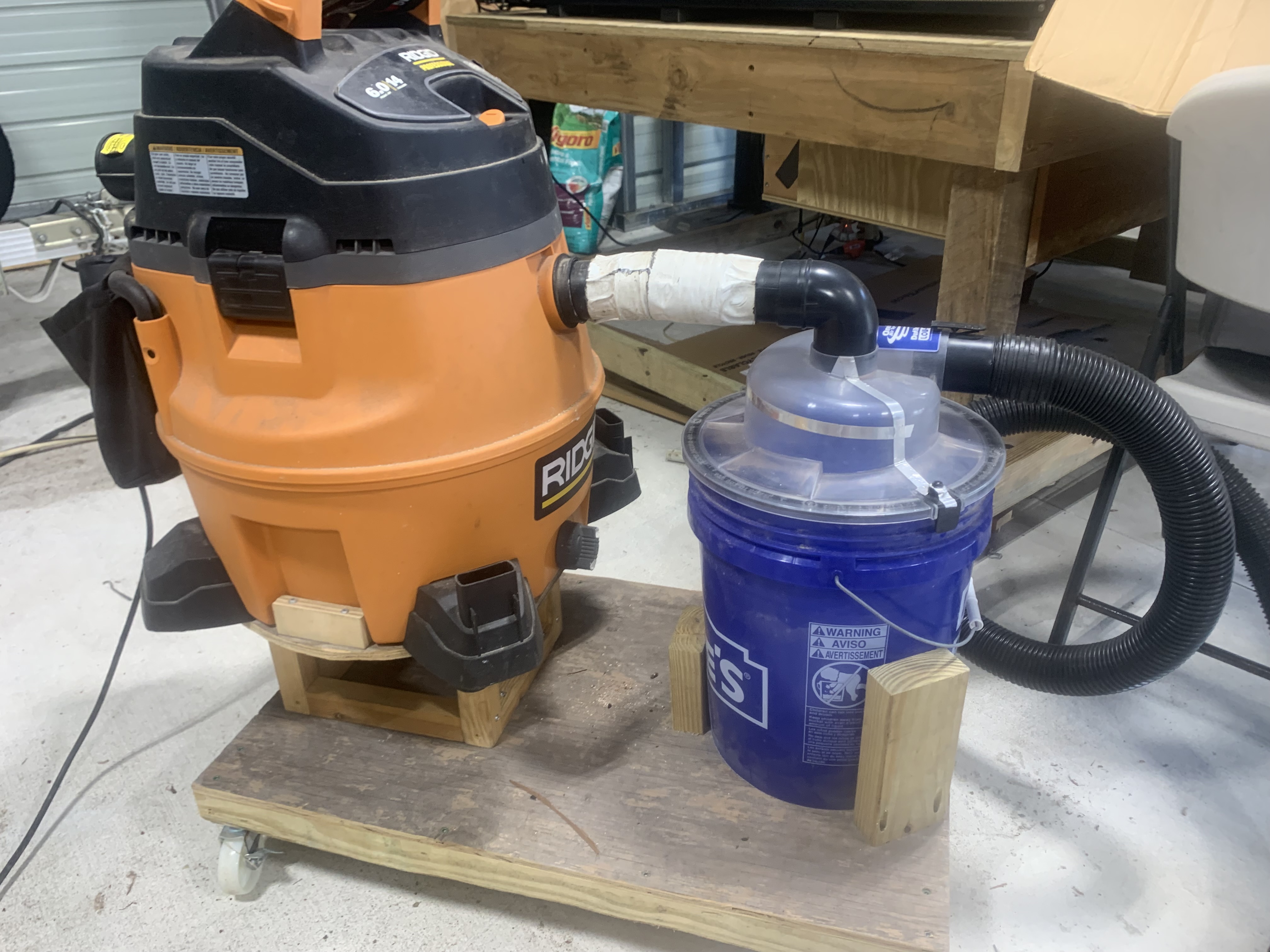

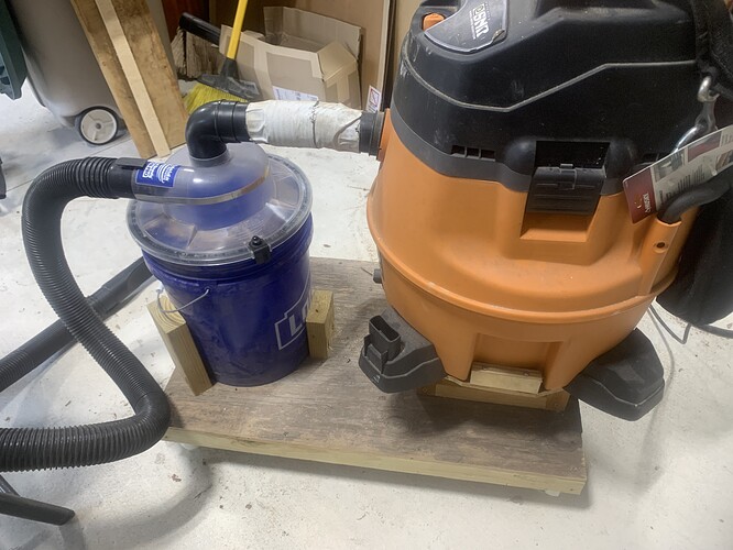

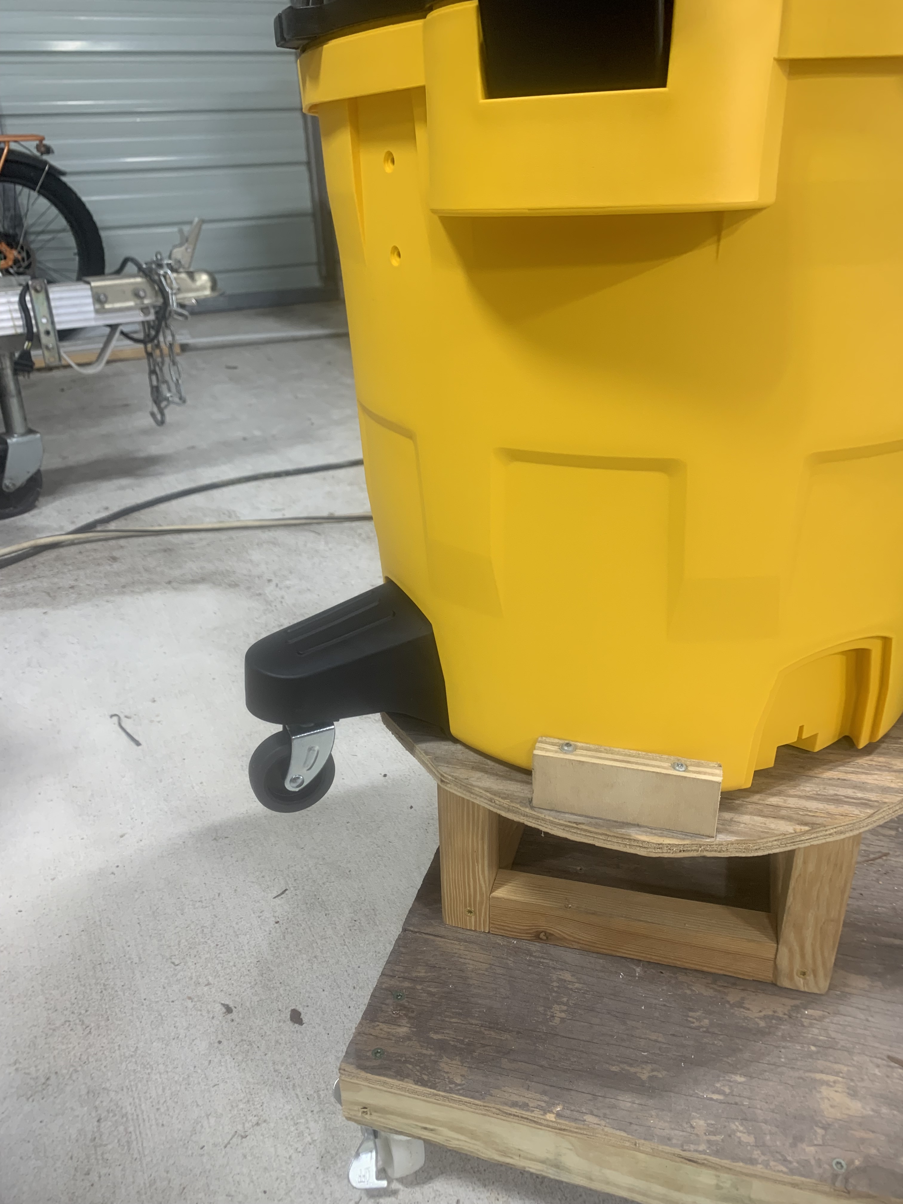

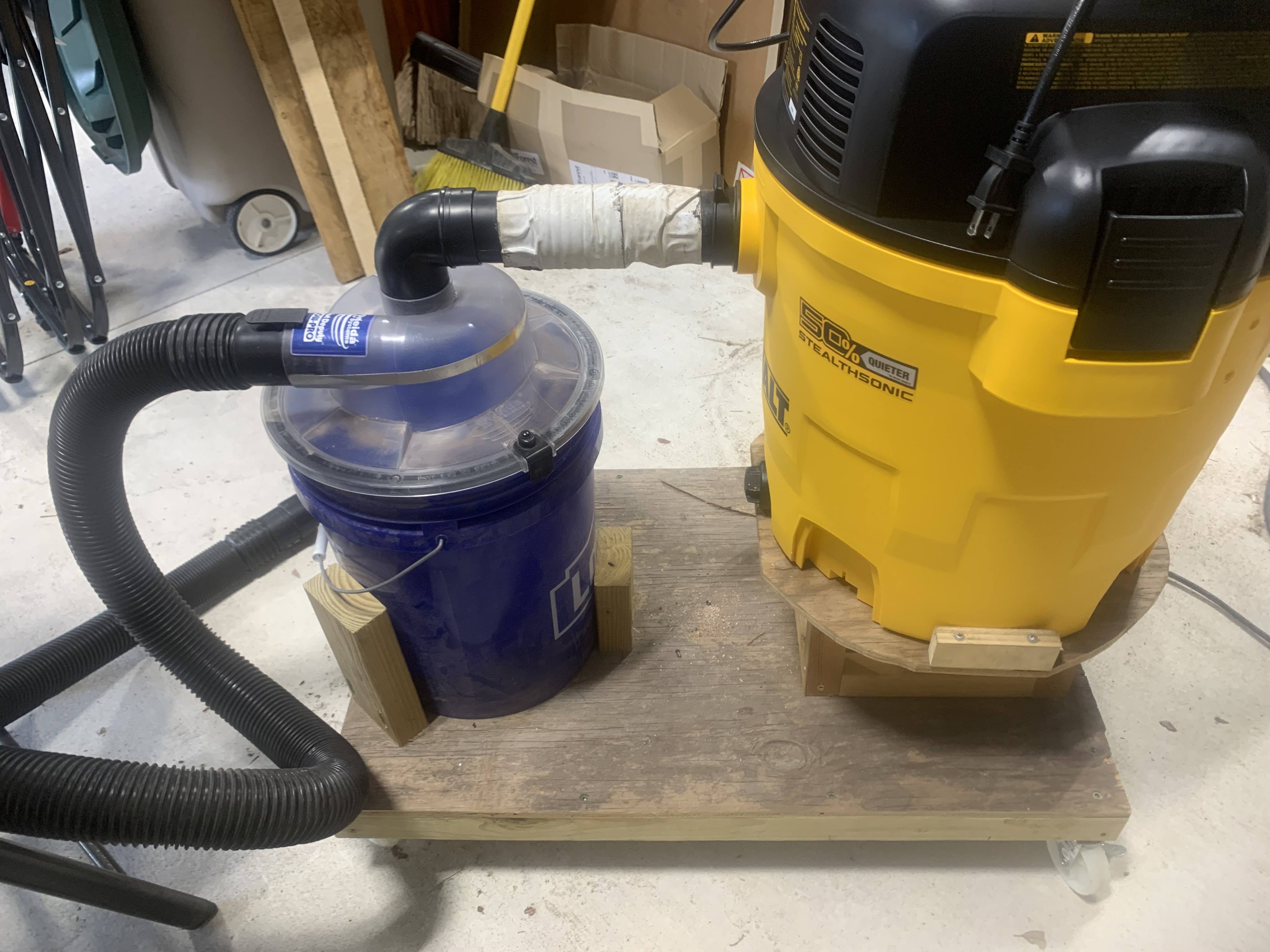

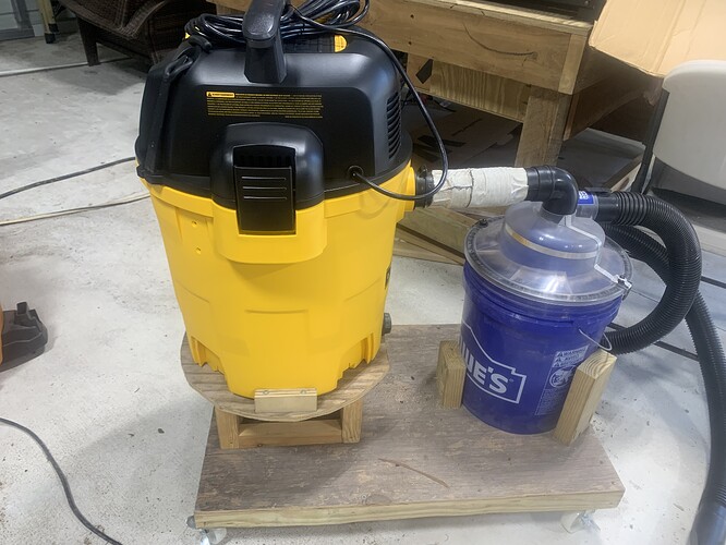

Well, it’s good to be lucky! The vac swap was easier than I thought, just swapped them out with no further adjustments. I’ll finish assembling, wheels will fit easily. The initial design thought was to be able to remove vac/cyclone from the cart if needed without having to disassemble fasteners of sorts. Both are just sitting on top and lift out when/if needed. The cart assembly pulls around by dragging the hose or pushing.
Old setup,
New setup,

Tim, I gotta admit my first thought on seeing your photos was “Dalek with a hookah”… :thinking:
