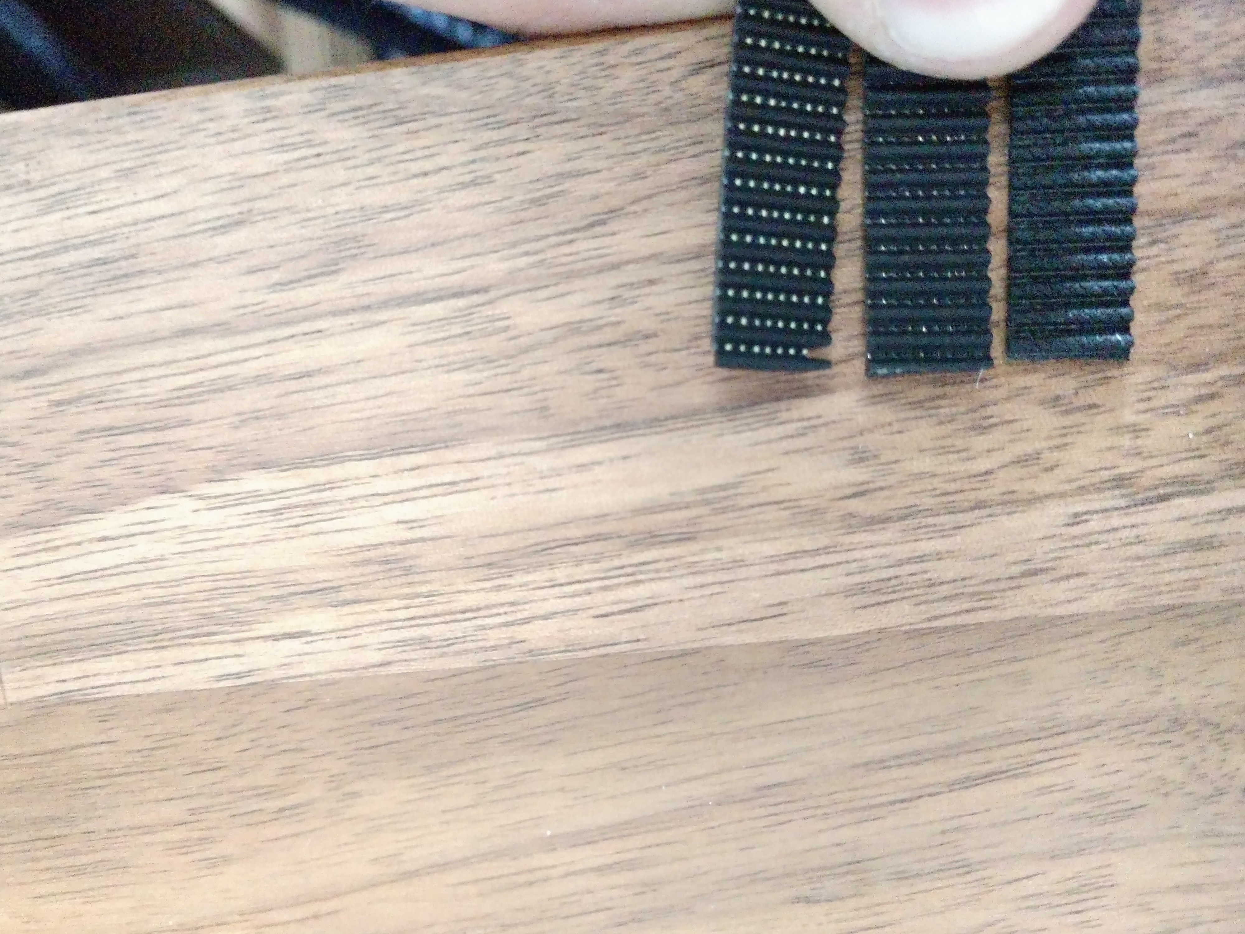

RepRapWorld order came in today.
Kevlar vs Steel vs Fiberglass. Got enough to spare for just in case and some future projects.
Probably be a few weeks before I install them (Kevlar). Plan on tearing down the S3 for maintenance, squareness and tramming.
Wow, nice photo of them. Do you have steel ones currently installed or you have yet to switch from the fiberglass ones?
I have the stock Carbide3D (fiberglass) belts installed at the moment.

I got my steel belts (2 rolls) in from Aliexpress a couple of days ago have not installed yet but comparing them to the stock fiberglass belt here’s what I see. The steel belt is marginally stiffer when bending then the stock. But I could see zero stretch with the steel. As far as wear goes to the stepper motor bearings I don’t see much of an issue as long as you properly tension and not over tension the belts. Belt life will have to be observed over time. But about $40 for 20 meters of belt I think I could afford a little less belt life for increased rigidity. I will try and get them on my machine this week and give an update.
Extra care needs to be taken with installation due to thickness and guide wheel interference

Received 3m of steel, and 3m of kevlar from RepRapWorld. I already have some steel core on the X axis. I installed kevlar on the Y axis this afternoon. They are more flexible than the steel core, not as flexible as the fiberglass.
I did notice that there seems to be a lot of defects in the kevlar belts - I’m not sure they’re anything more than cosmetic, but they exist. I don’t see the same issues on the steel belts. I wasn’t able to find a long enough section on the 3m I ordered to get two segments ~1m for the Y axis without them, so I guess I’ll found out if they’re a problem.
