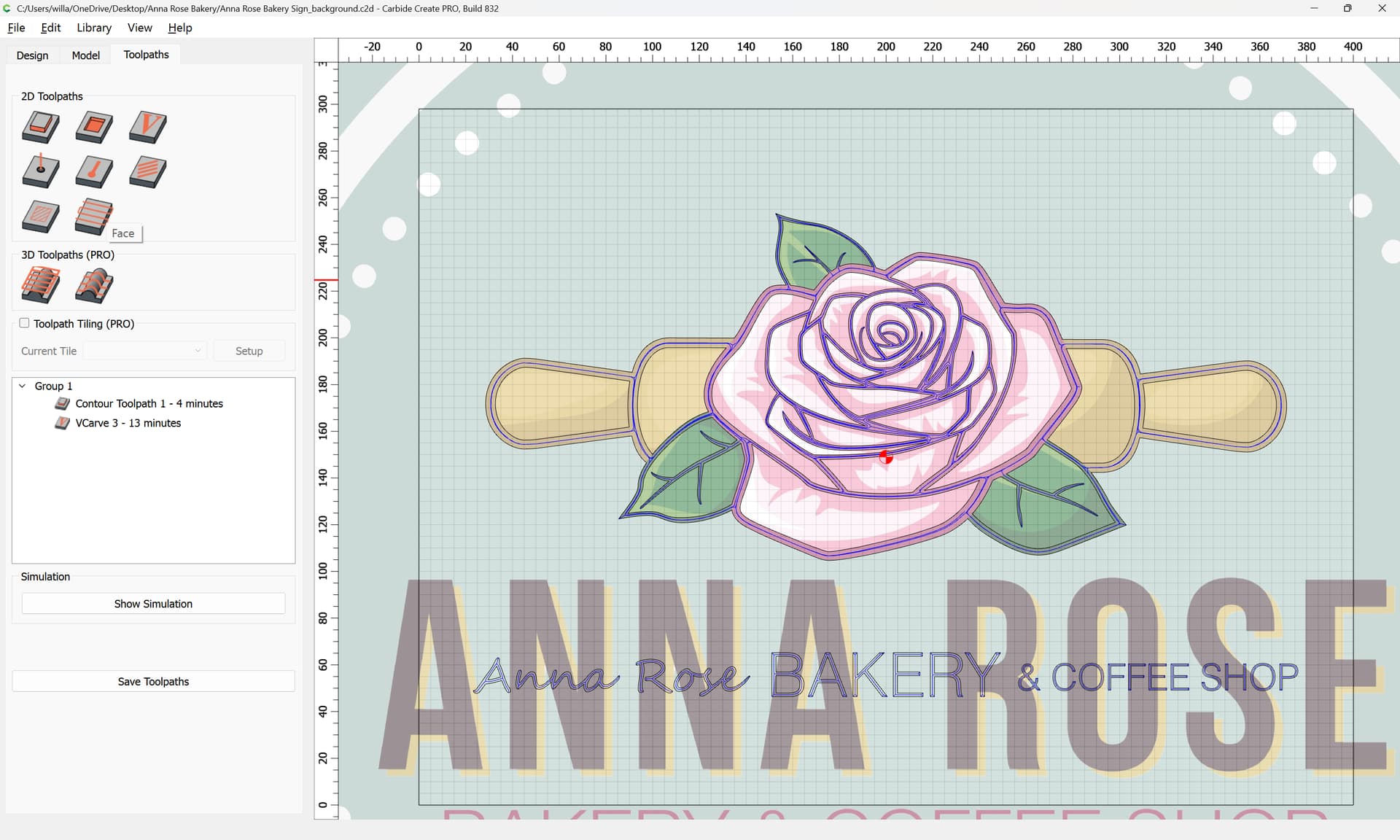

An admin teased rastering back in Jan for the V8 beta. I just downloaded the latest/greatest and don’t see raster toolpaths. Still not available? Any plans for it soon?
It’s in there:
but it’s a Pro feature:
Build 807
Pro Added Facing toolpath.
