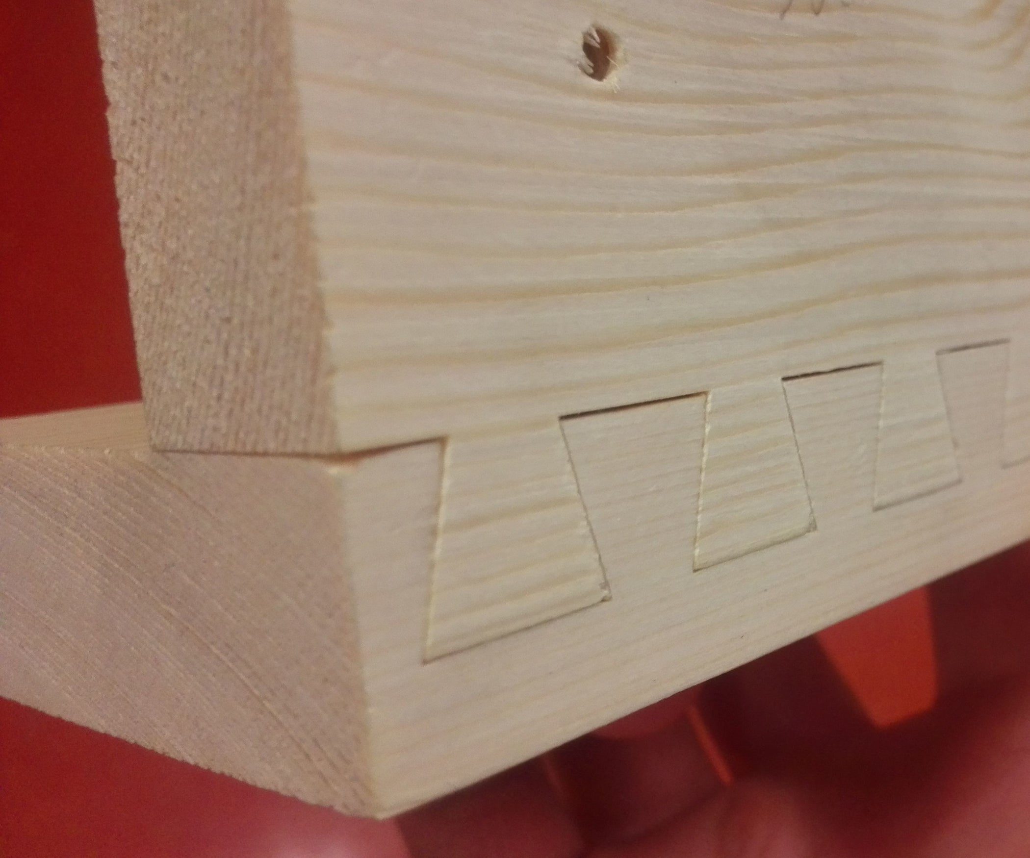

here is an attempt:
here is another:
With a CNC one will not get those sharp corners that can be cut with a chisel.
I recommend to consider different types of joints:
Thank you for your response. I was not looking to make a dovetail joint for a box. I was making a dovetail path (sliding dovetail) for a carcass construction.
Carbide Create does not support that tool geometry.
One can cut them, just one has to take the 3D appearance of the cut on faith:
