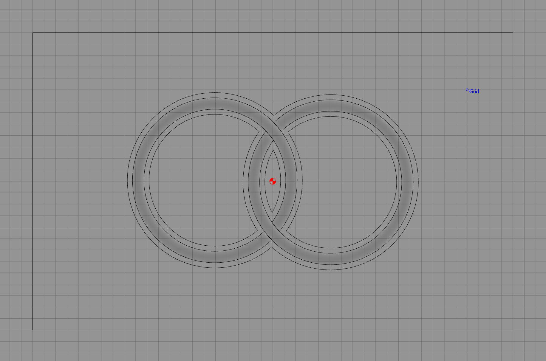

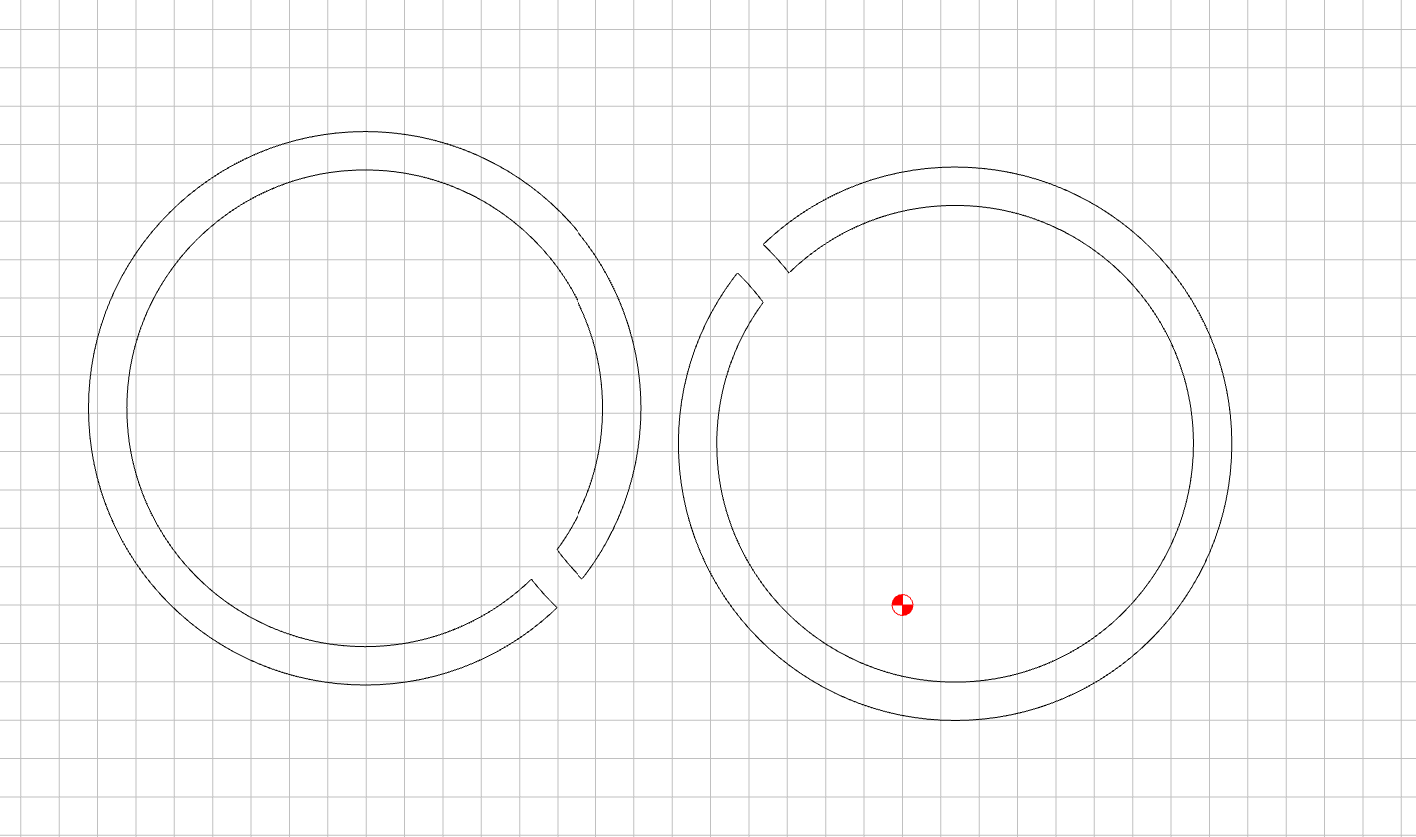

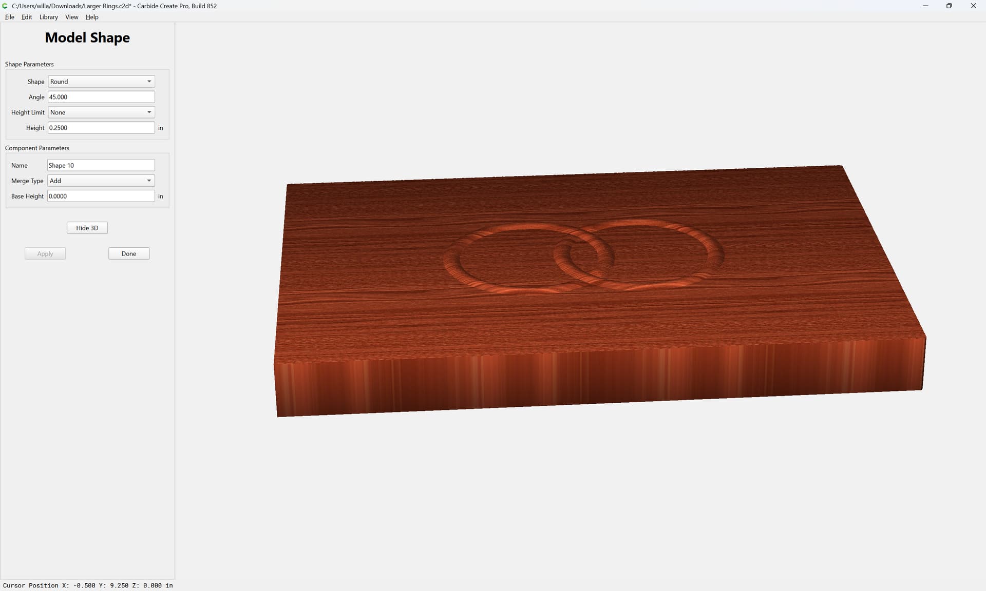

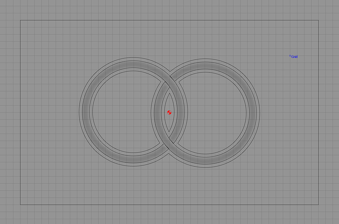

I’m modeling two interlocking rings:

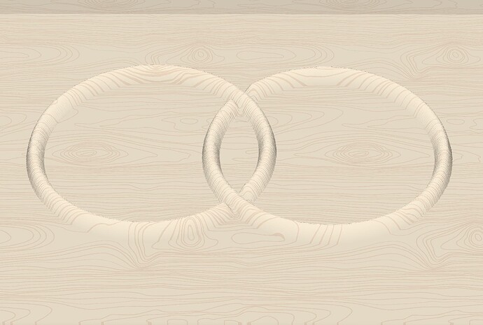

This version of the file works fine:
Note the intersections of the rings…they are (correctly) not overlapping.

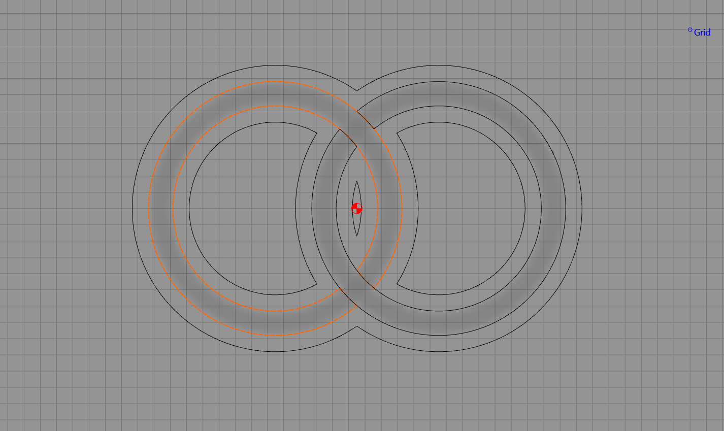

The ring elements look like this (separated):
This is the file:
Cover Rings and Outer Recess.c2d (2.1 MB)

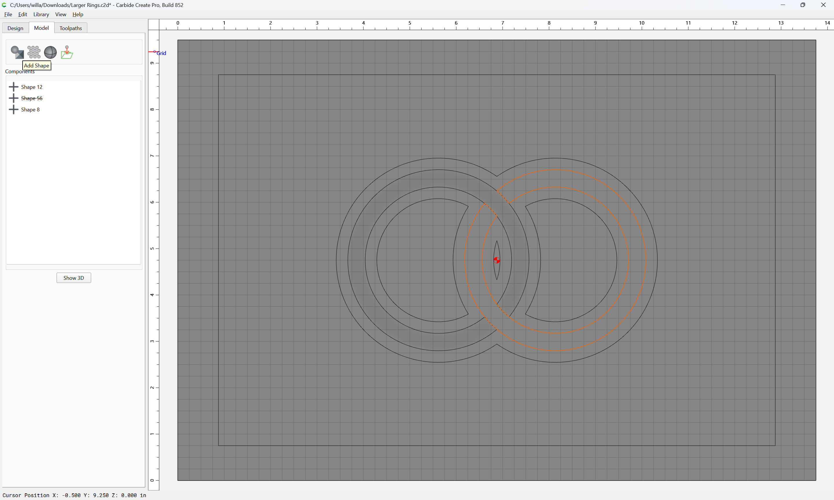

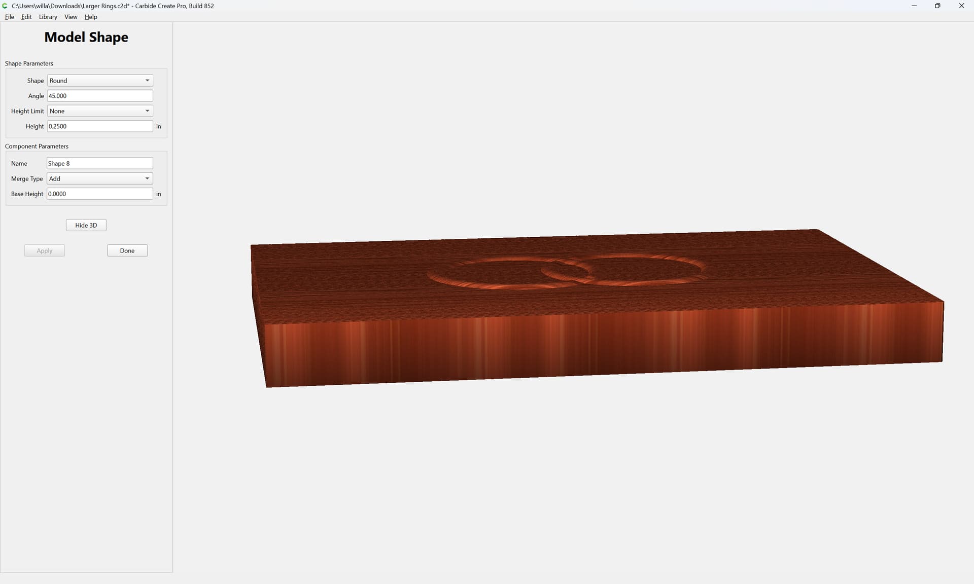

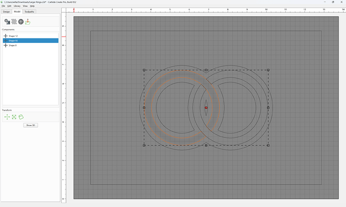

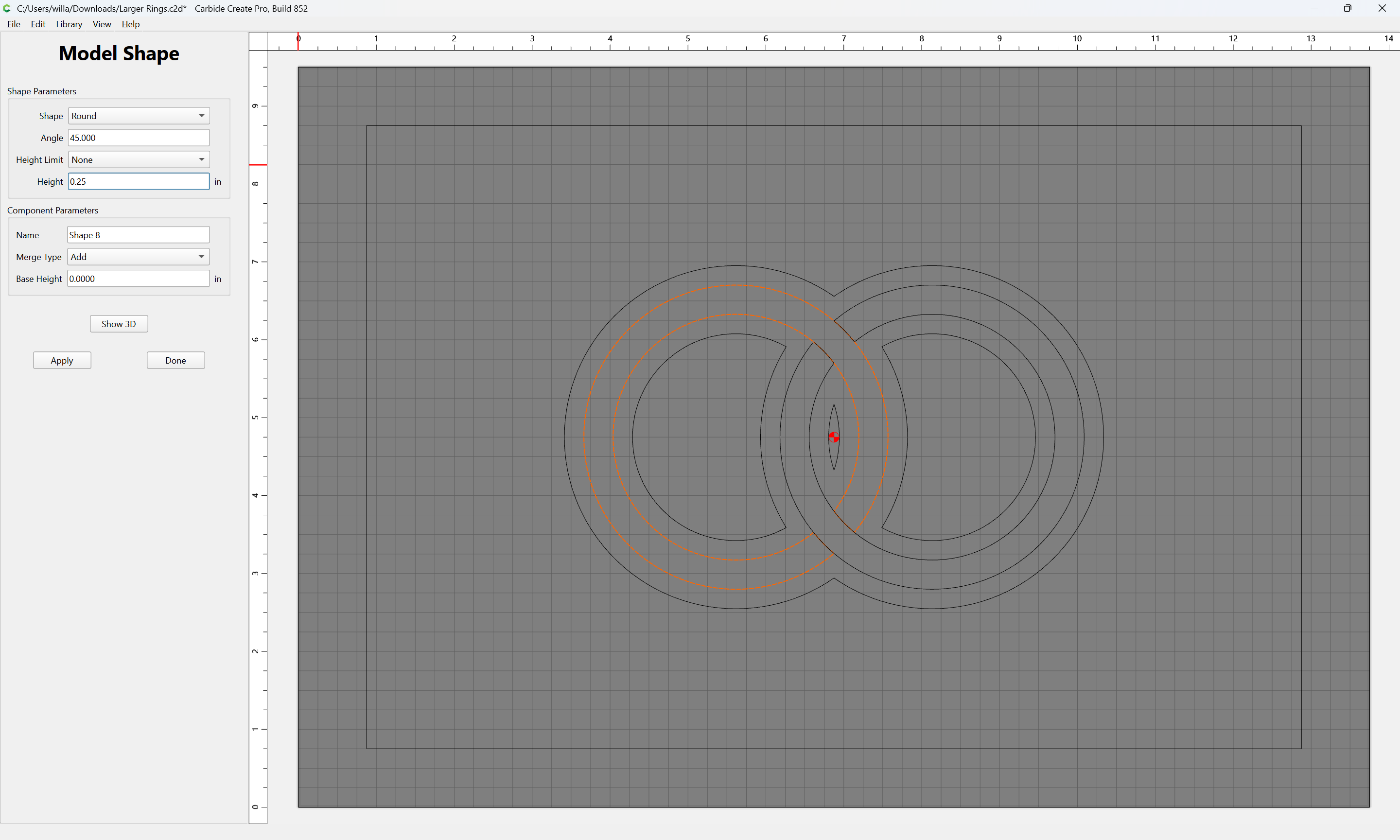

Then, I recreated everything to make the rings larger. When I did that, suddenly the modeling starting working oddly. This is the file with the larger rings:
Larger Rings.c2d (1.6 MB)

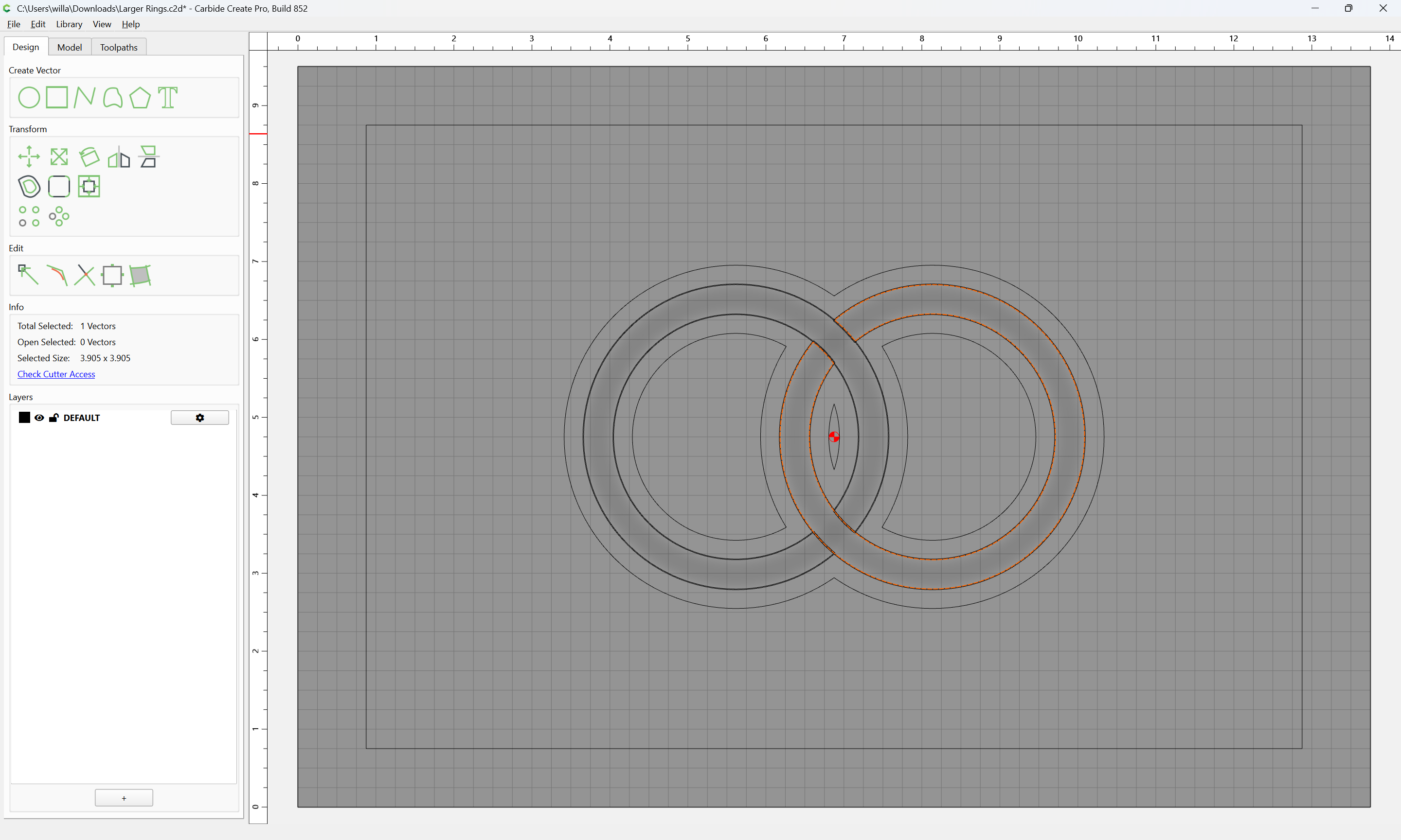

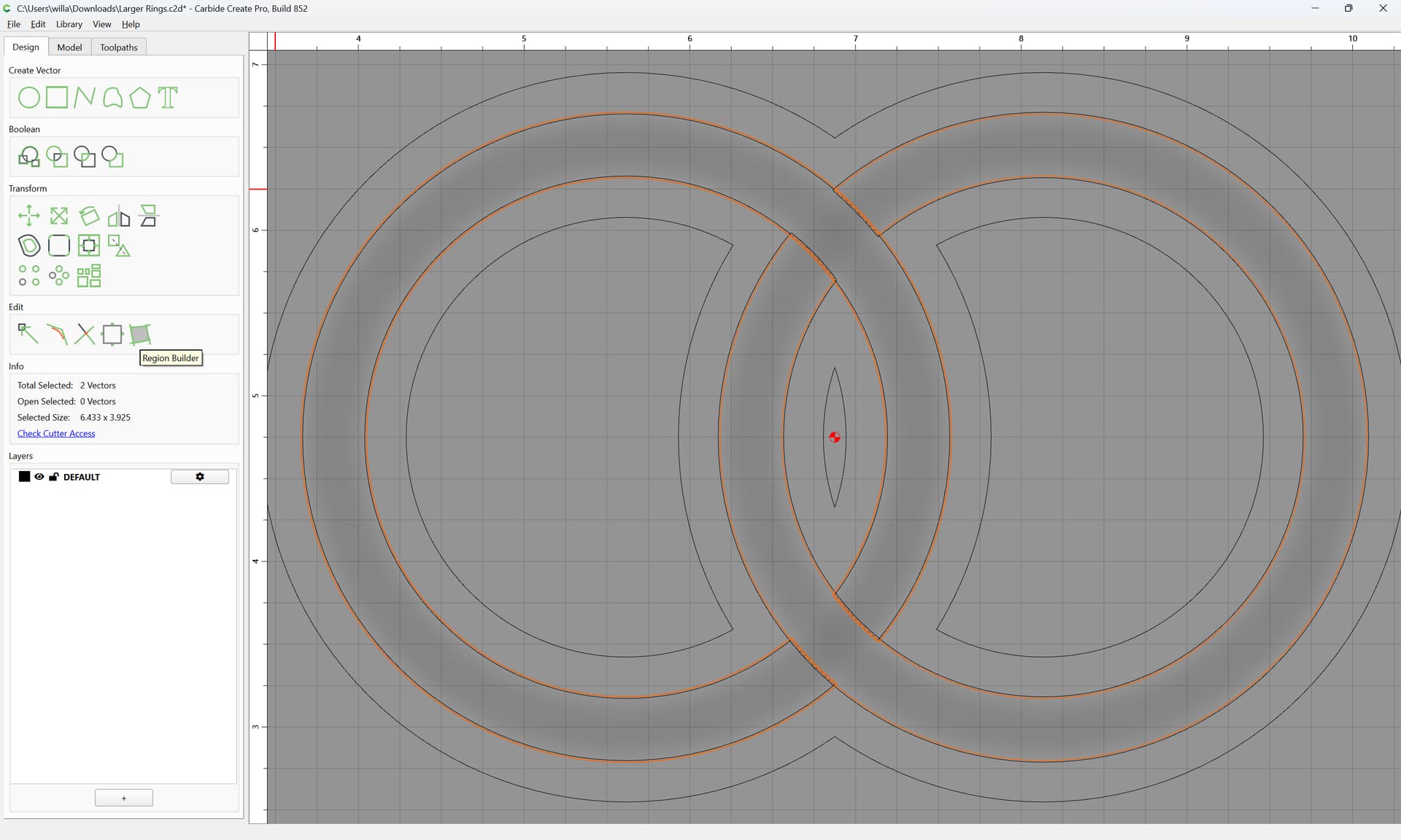

In this file, the rings are built the same way:
and

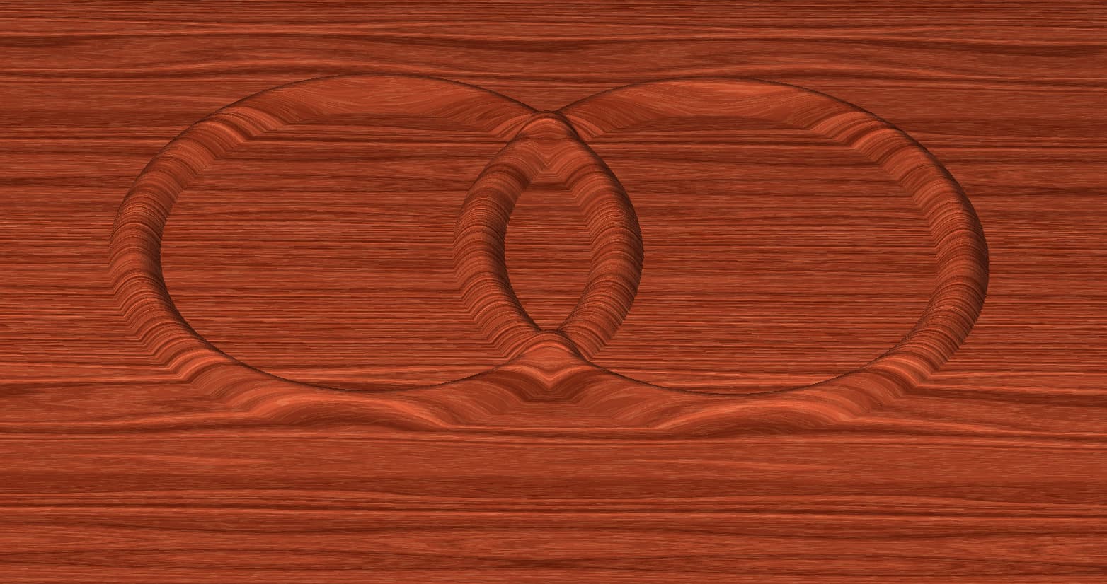

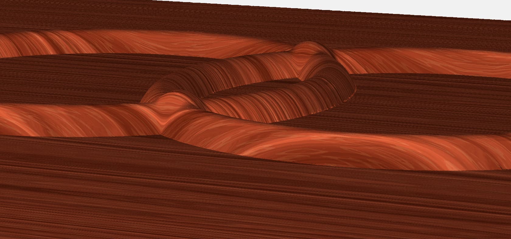

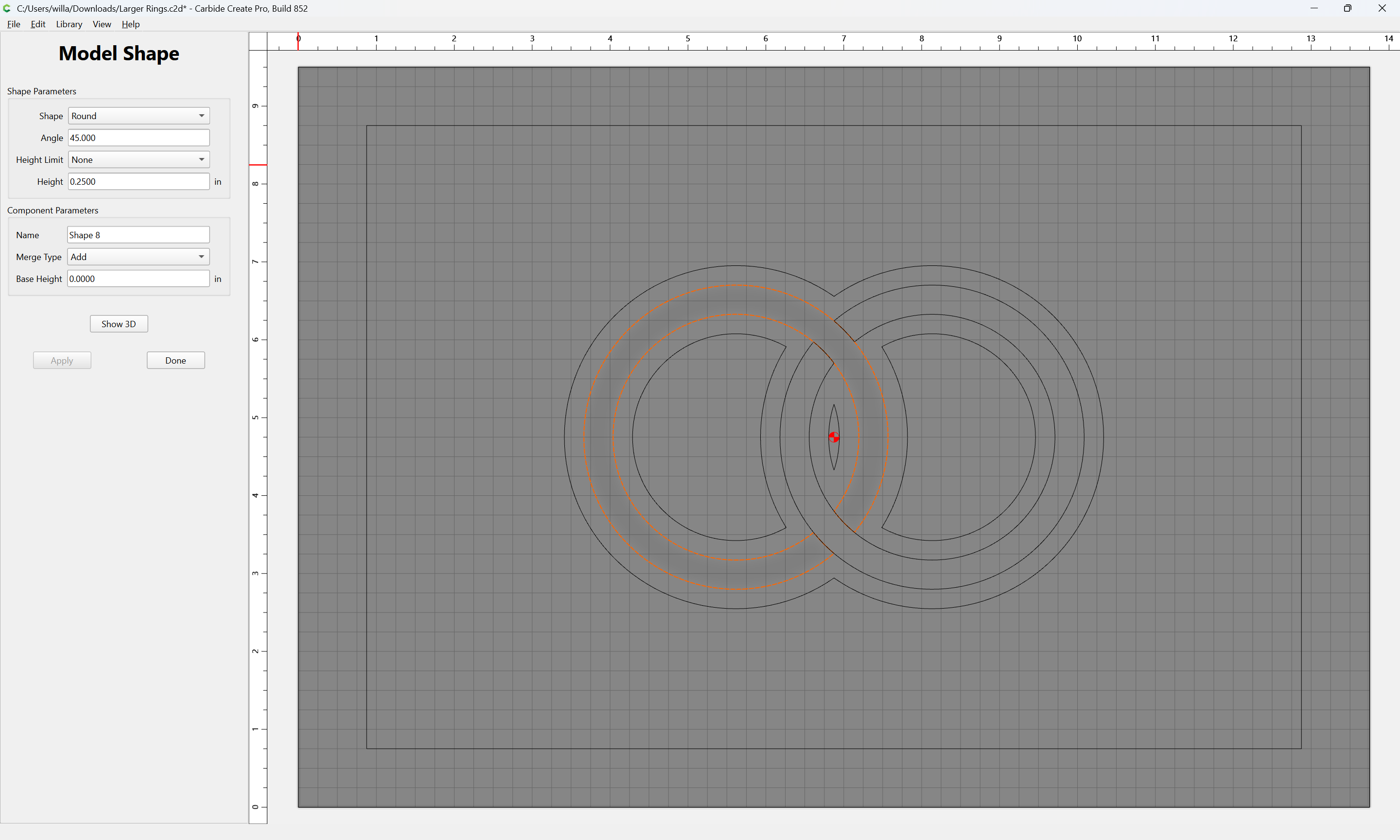

However, note what happens on the intersection points (which aren’t overlaps)
You can see that the modeling tool is ADDING the intersection between the two rings…even though there is no actual overlap of the objects! It’s treating the rings as if they were completely round…when they’re definitely not.
I’ve tried recreating the modeling components, with grouped and ungrouped rings, clearing out all other modeling steps, removing toolpaths…I cannot figure out where those additive bumps are coming from.

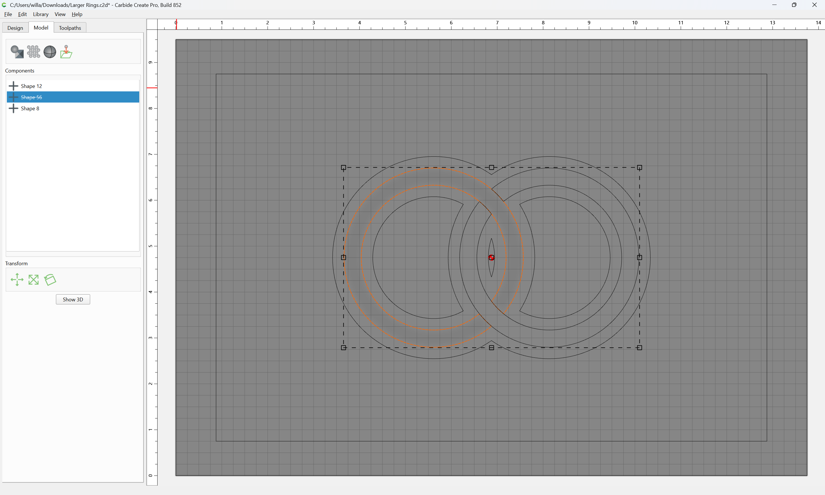

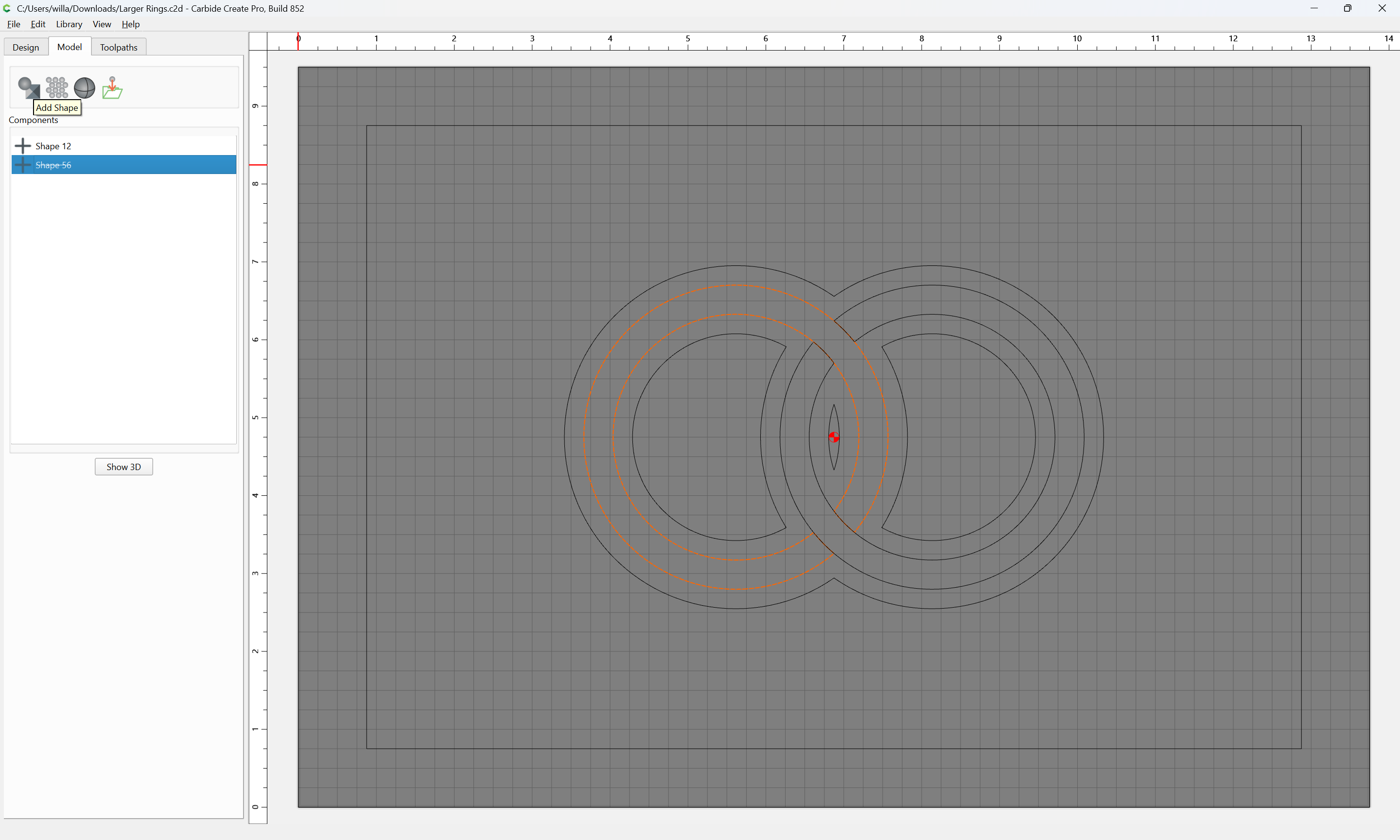

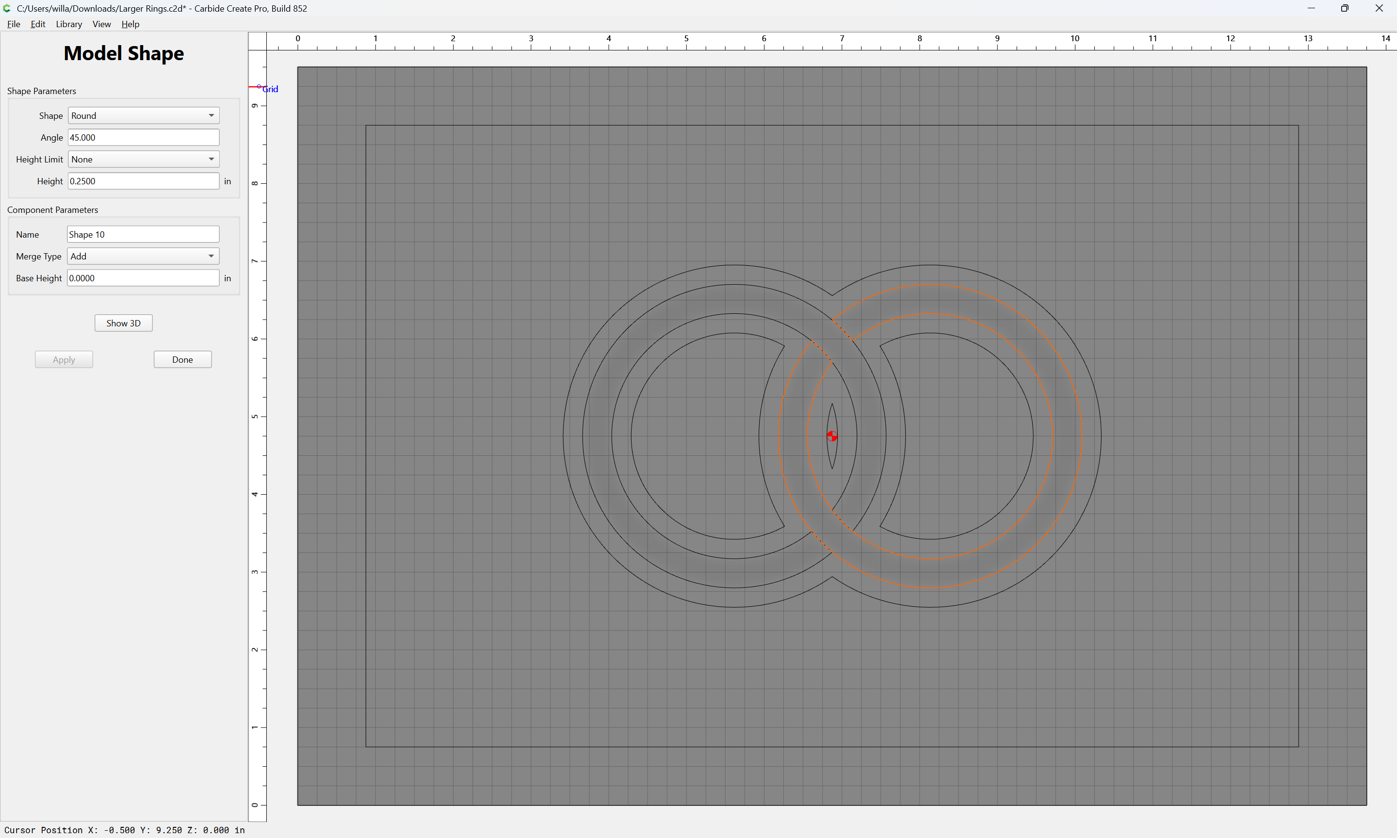

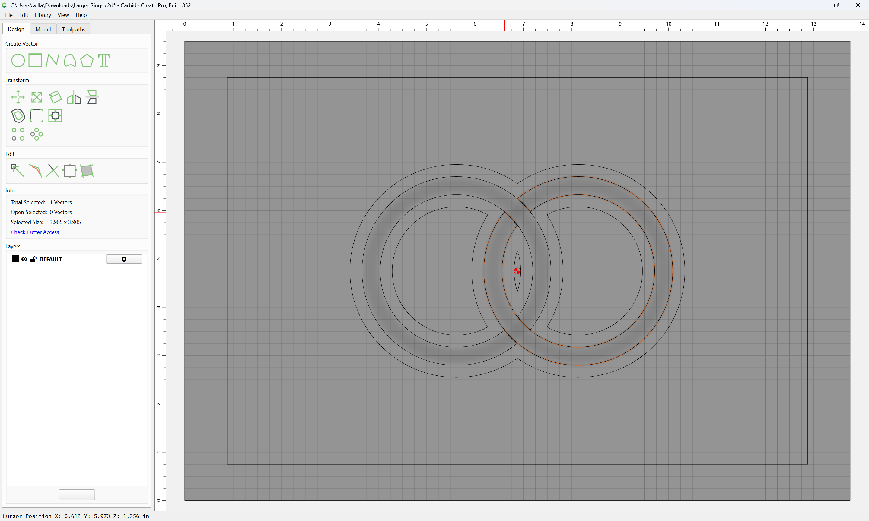

I separated the two rings, built each of them in the modeling tool, and then moved the model components into position manually - and everything is right (no build up)…but if you create the modeled component with the two rings in position already (both selected), in this file (but not the first file), the build up occurs.

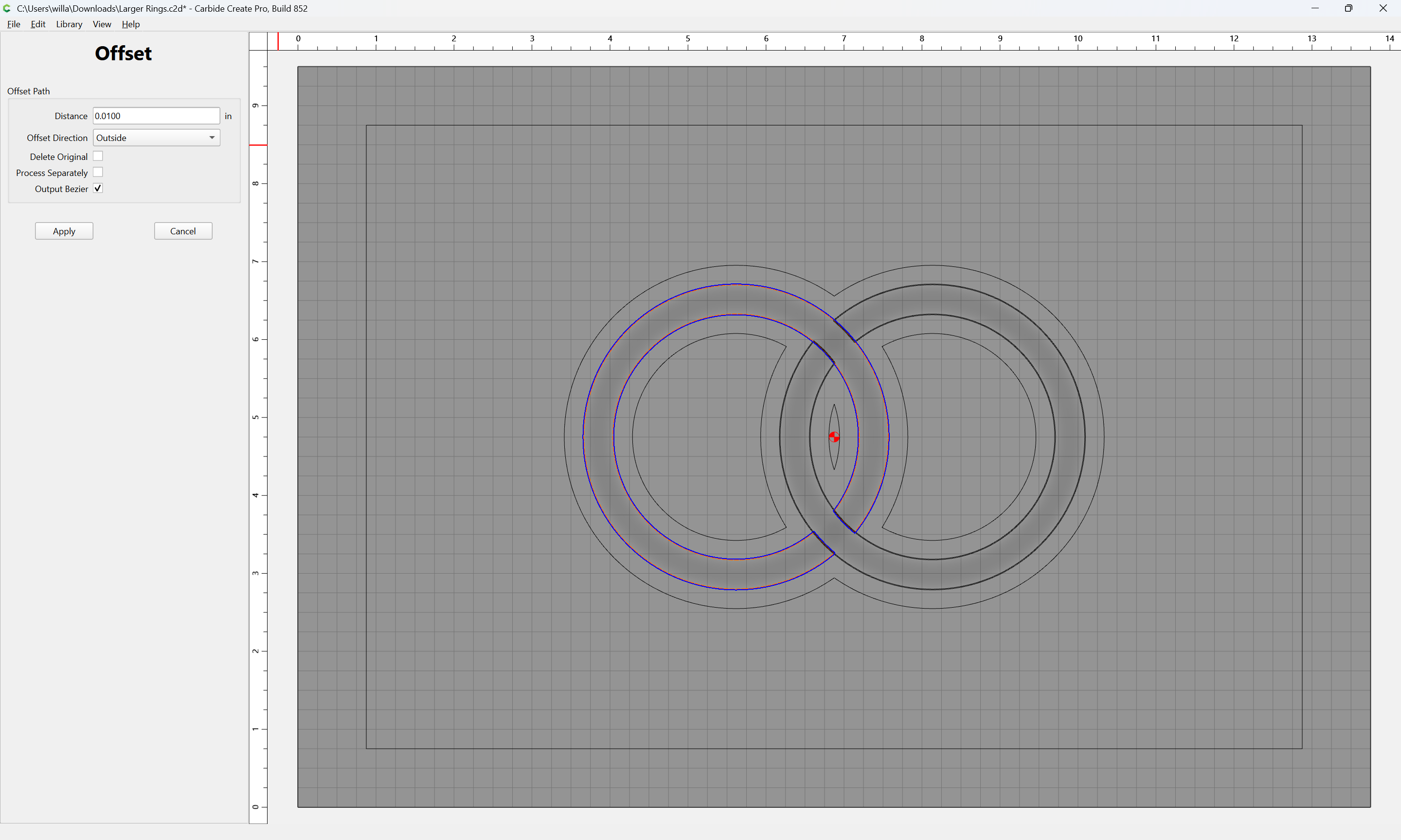

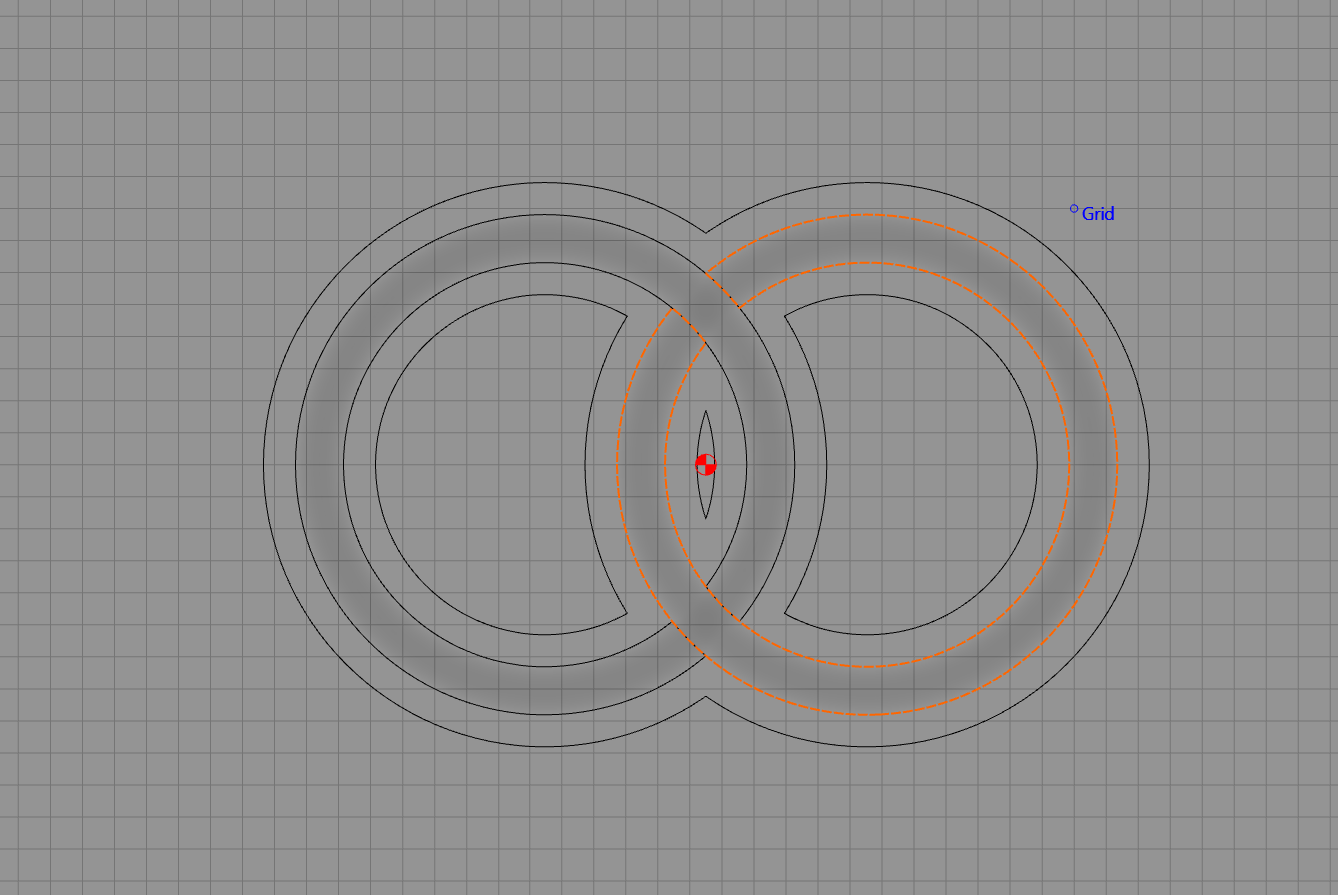

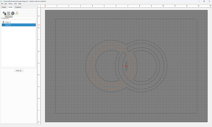

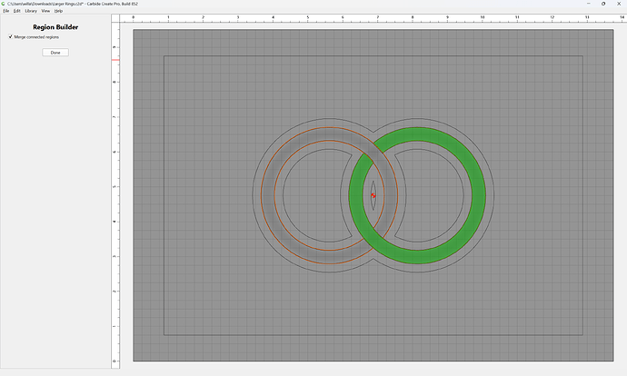

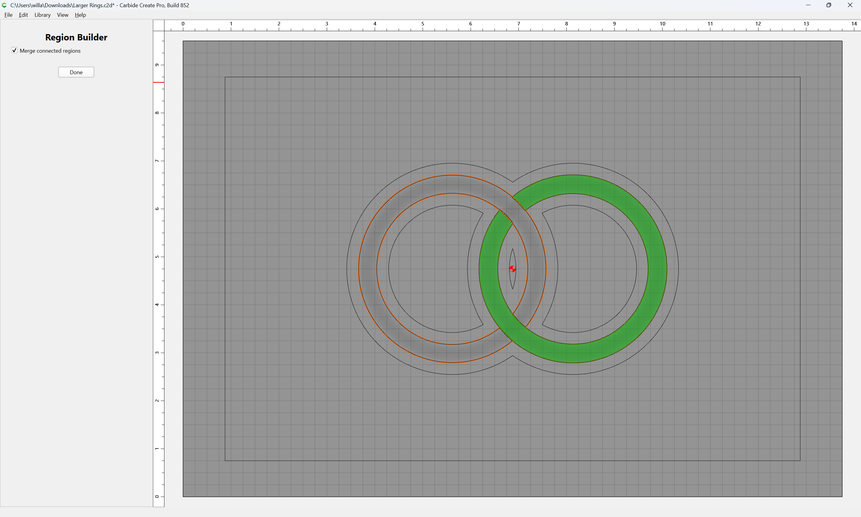

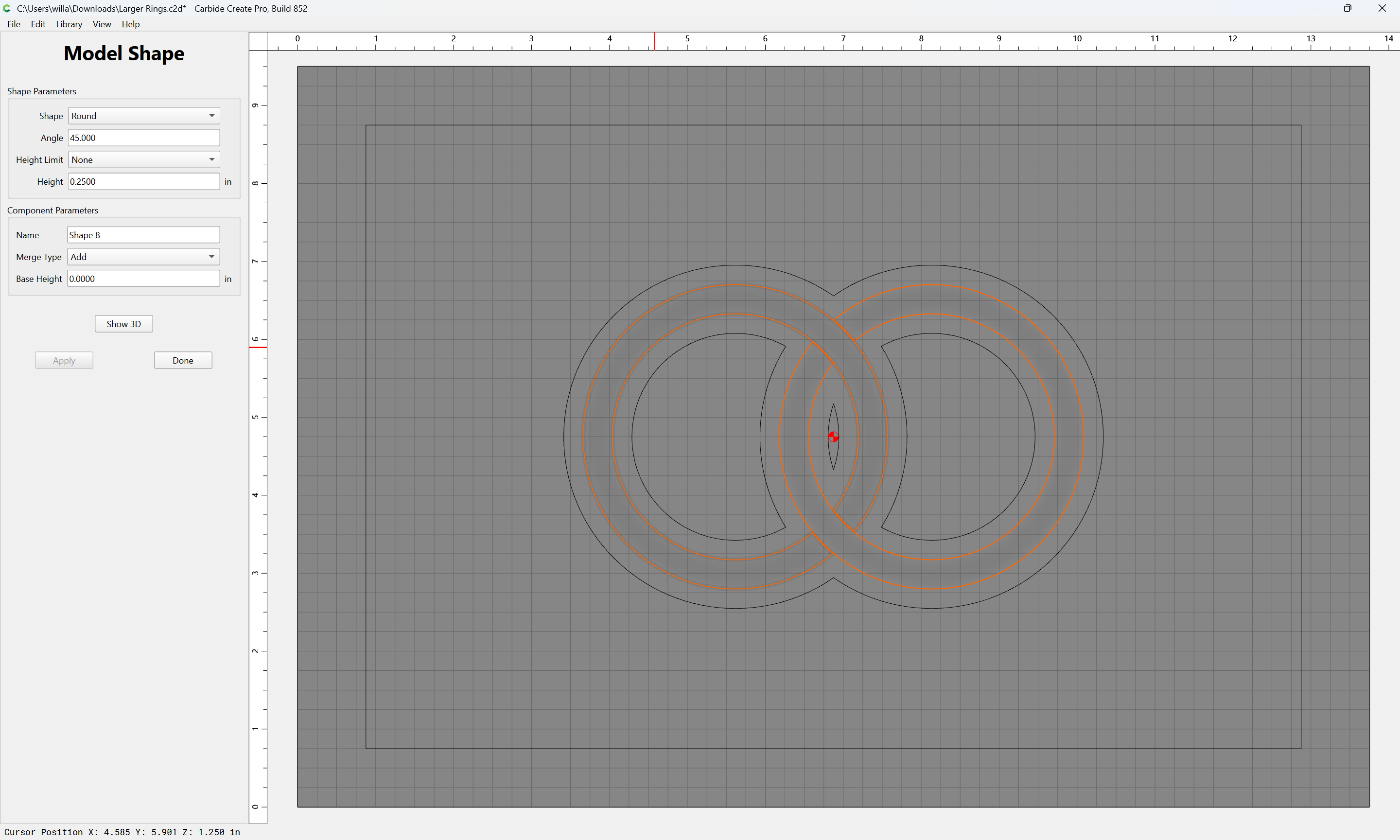

Things are so close that it is being treated as a single object:
If you adjust things so that there is a clear separation:

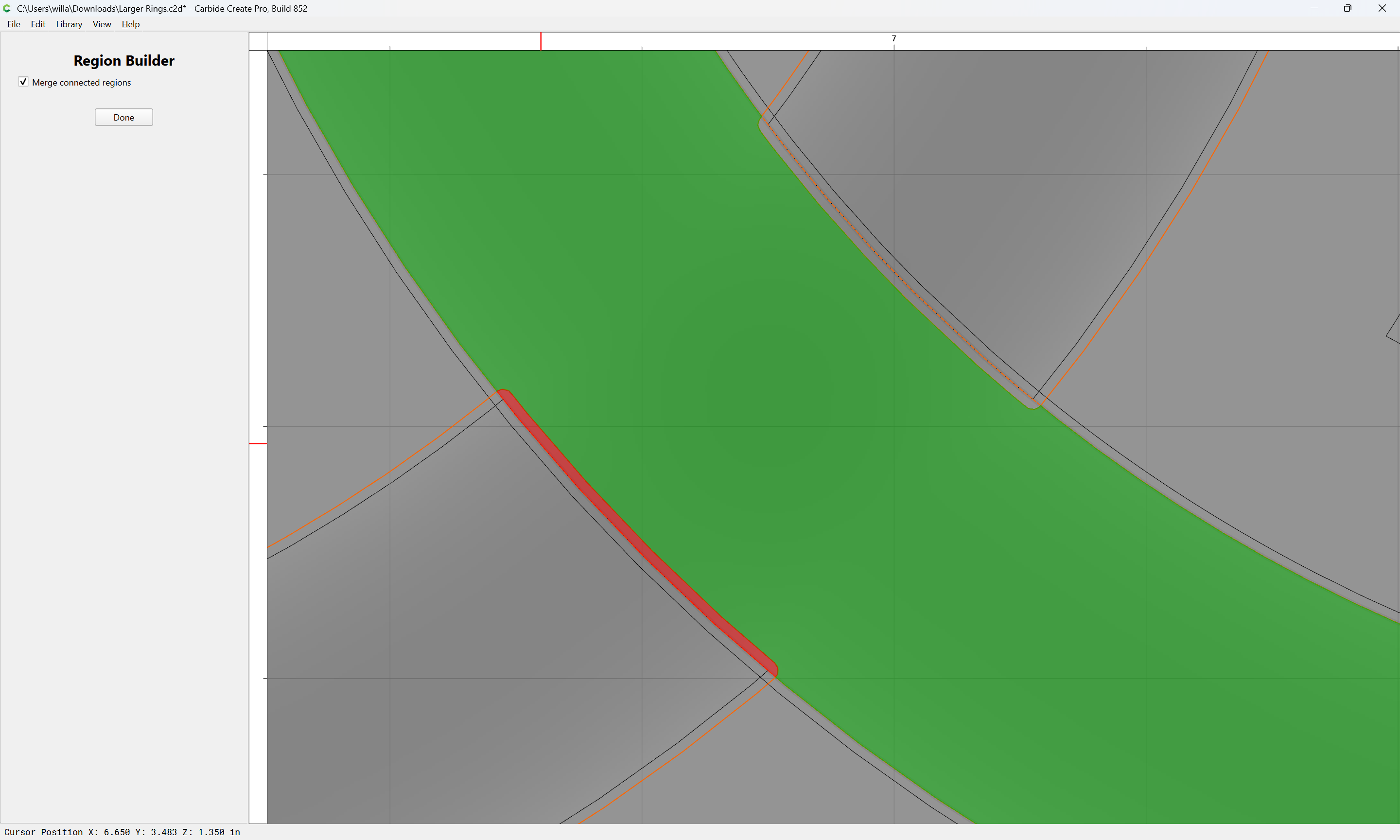

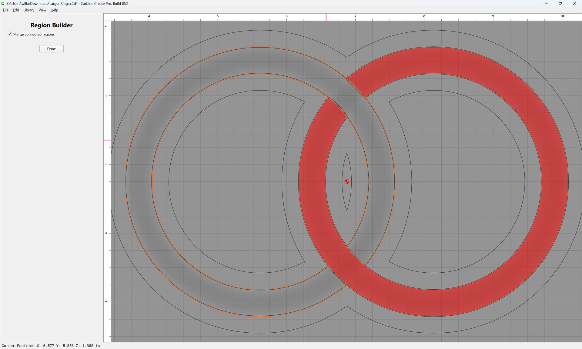

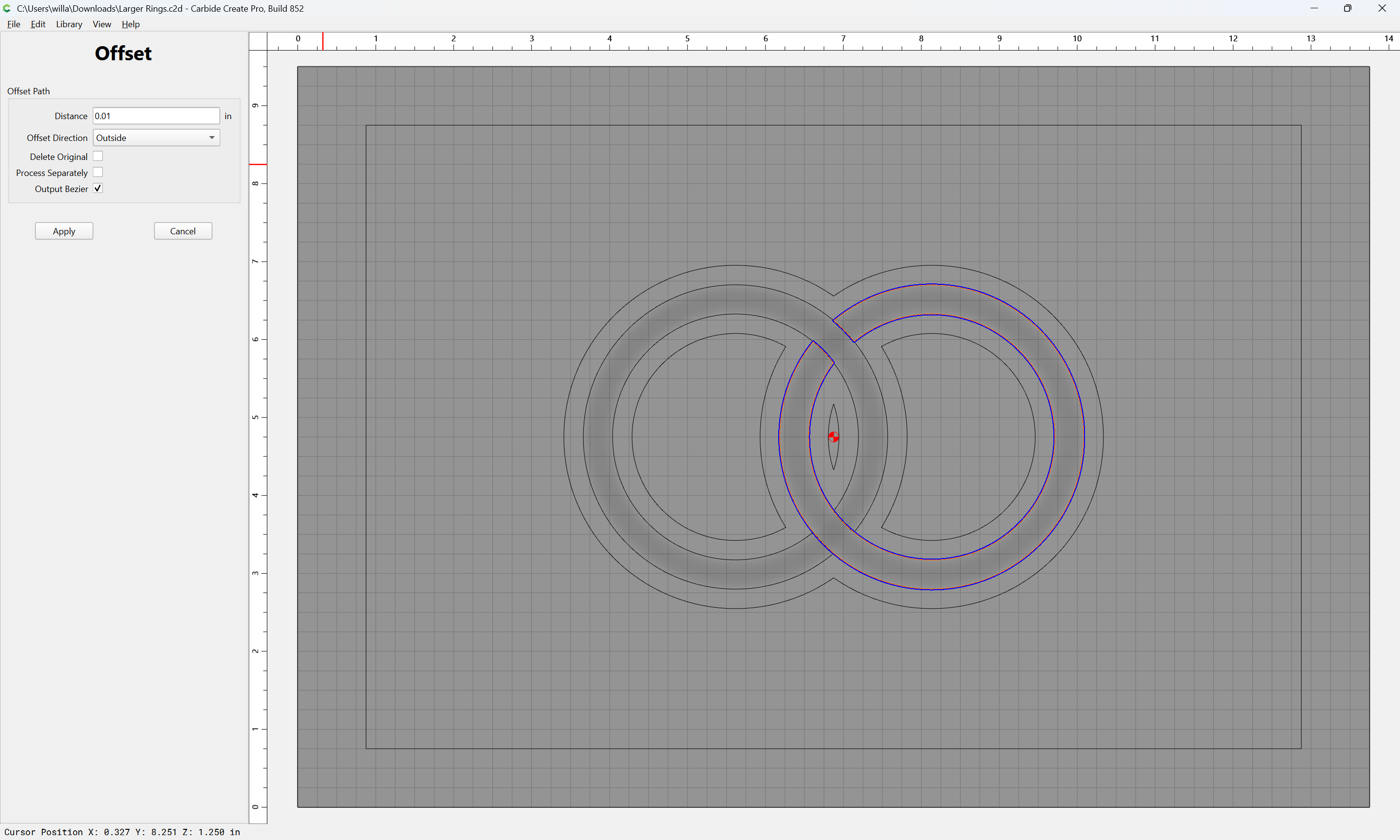

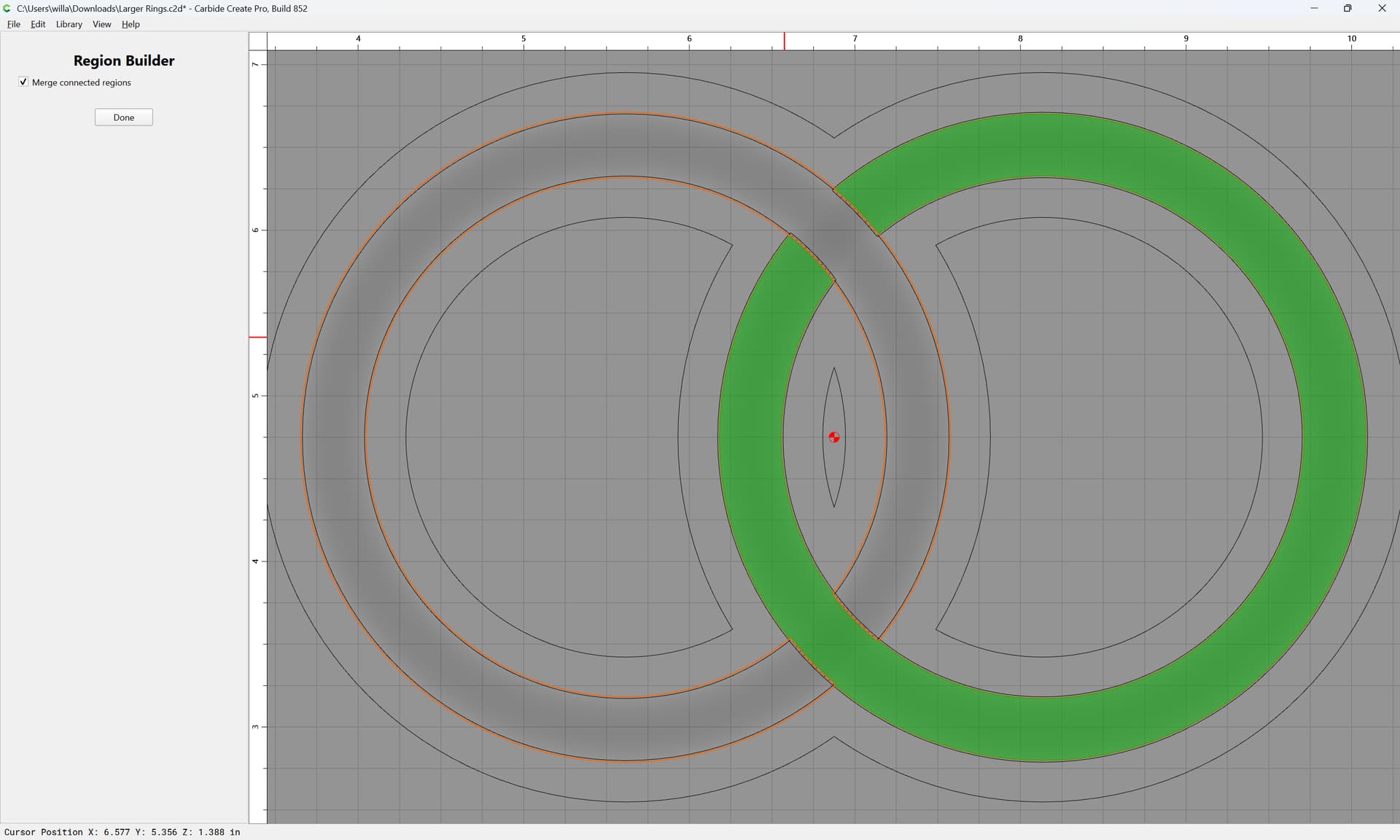

using Region Builder for example:
Yes
Done
Repeat for the other side and then delete the original geometry (or hide it on a reference layer)

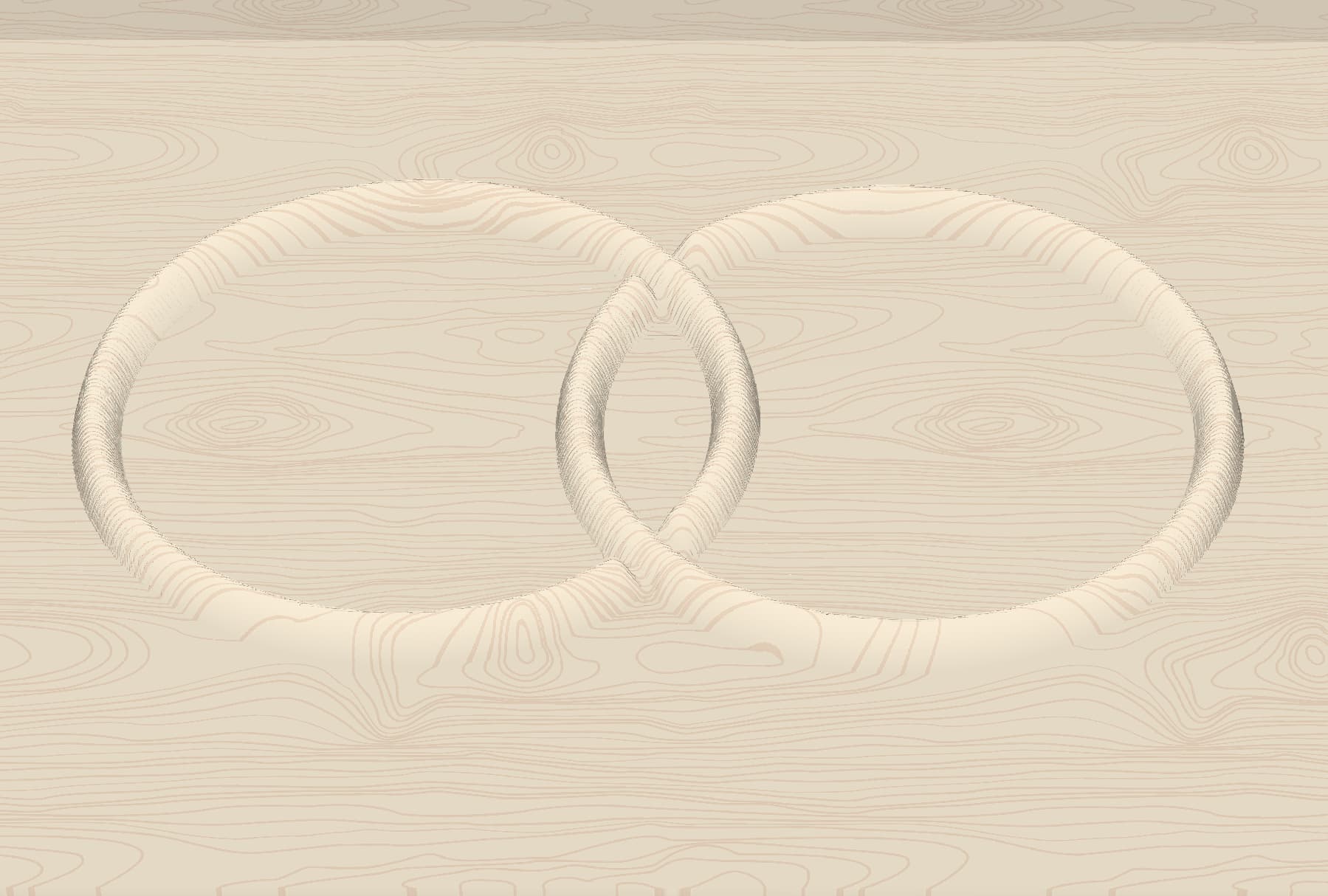

It will then work as expected:
Alternately, you could make two separate 3D components which would prevent the interaction.
I originally created my rings (in the two files that I uploaded) using Region Builder…exactly the way you did.
It worked once. Didn’t work the next time.
They are not one object…they are clearly two objects…and you can pull them apart just by selecting them and moving them - so why is CC treating them as one? That’s a defect in my book.
As I mentioned in my original post…I tried that in the file that failed. Separated the objects, modeled them independently then moved the models back together … and yes… that works - except it’s REALLY hard to move model shadows around much less align them correctly. You can’t use centering tools, you can’t nudge them. It’s an untenable solution
This sounds like this behaviour here:

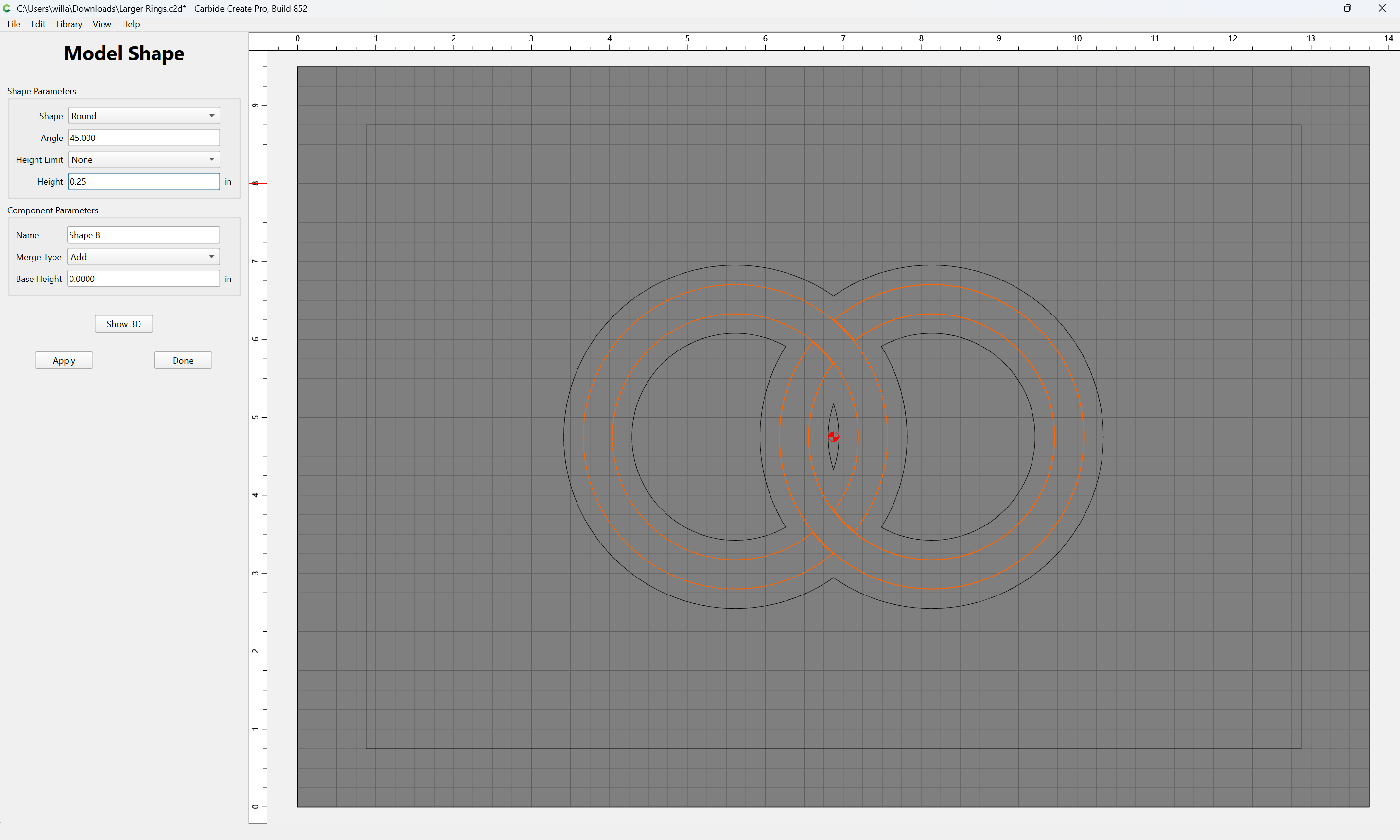

Separate selections and components seems to work as expected:
Apply
Done
Show 3D

Now…just going back to the rings…even if CC thought they were “one object”, it actually doesn’t behave that way…it’s treating the overlap as though BOTH circles existed in the entire intersection space. It’s not showing a single height across the intersection area (as i t would if both circles were joined before the model was done), it’s adding two circles together…so it’s closing the circle on the ring that doesn’t have anything there. That’s not the same behavior as treating it all like one object. It’s actually treating it as two objects…two contiguous circles that overlap. Even the explanation of them being too close, doesn’t account for that behavior.
Am I right?

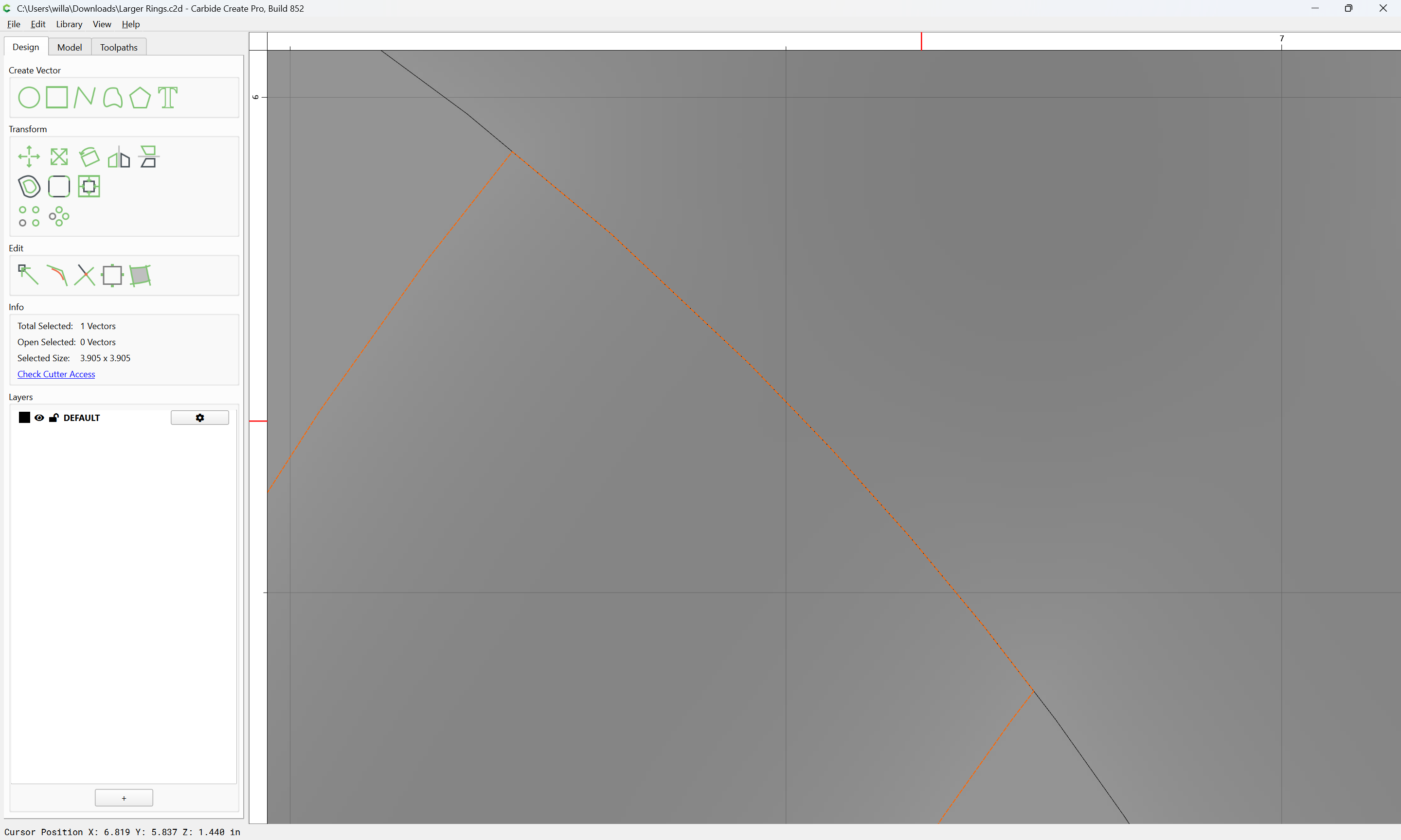

No, the algorithm interacts with the region being wider on the diagonal at the intersection — because of this, I’ve taken to doing multiple objects for V-carving (so as to get crisp interior corners) or 3D modeling (so as to not get a greater depth than is wanted).
So…the next question is…since the two rings were created using the Region Builder tool…why is there an overlap? Shouldn’t the regions automatically be independent?
They don’t overlap, they are adjacent, which is treated much the same as an overlap.
OK. Sounds like a defect. Adjacent is not the same as overlapping…The code knows that these are separate objects.
Thanks.
As noted, it is a conscious design decision to treat adjacent as overlapping/unioned — it should be pretty easy to offset a bit, then remove an essentially invisible sliver using Region Builder.
