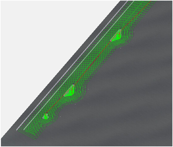

I have na “issue” with pocketing toolpath.
When I set pocketing toolpath of quite deep pocket there are two different ways a path is created. I have only one toolpath and on one side it first clears the small parts, which i think is ok, and then clears the rest, but on the other side of the part it leaves small parts out and then cuts them at the end. I am affraid, those will chipout in the middle of work.
Any ideas how to change that ?
Correct on the left side :
But on the right side of the same tollpath :
Any ideas hot to avoid those ? Ok, I can make it clear out those before the final pass with a separate pocket drawn inside of existing pocket. Any other ideas ?
With best regards,
Miha
This behaviour was adjusted in a recent version — please try the current beta:
If it still happens in the current beta, send that in to support@carbide3d.com and we’ll do our best to look into this with you.
