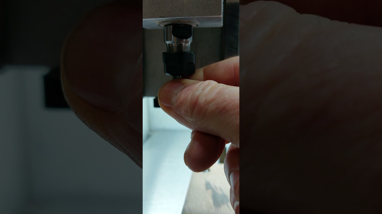

When I waggle the collet but I hear a rattle. I’ll video it in a bit.

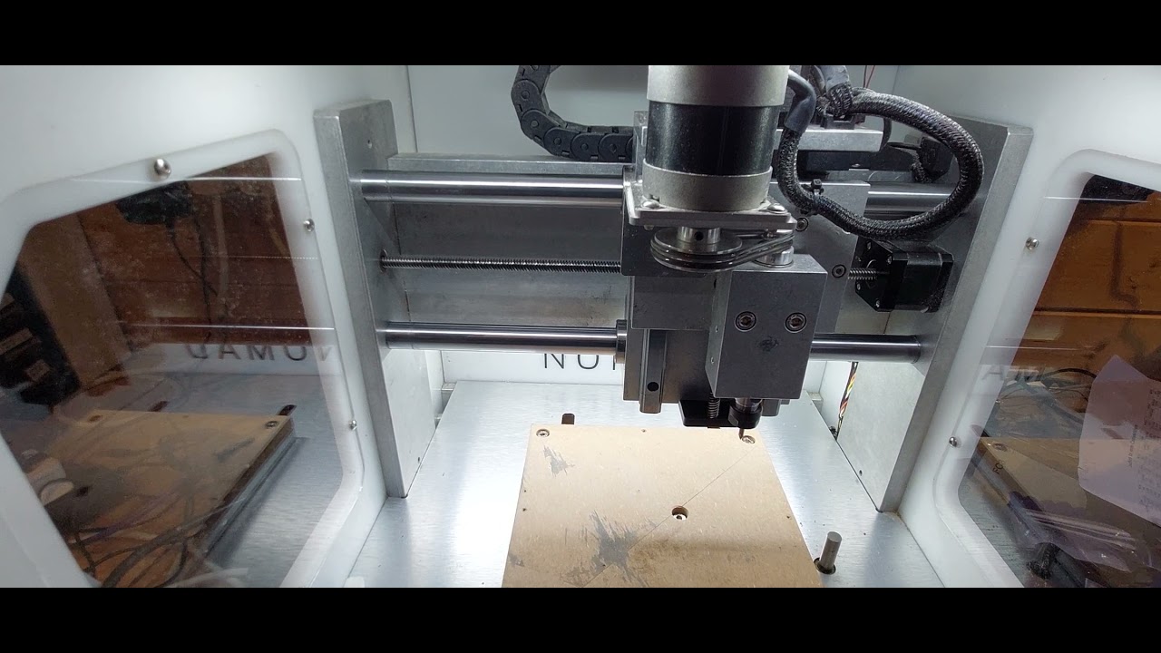

Video of what might be a wobbly spindle on youtube link (I hope it works)

I don’t have a Nomad to compare but I would not expect it to do that (thing from the video)
Does the body of the spindle itself have any wiggle ?
Just thinking out loud about tests you could do to confirm that it’s something wrong with the spindle/bearings: if you had a way to attach a precision pen to the spindle casing, and repeat those tests, and they turned out ok, it would definitely incriminate the spindle bearings. It’s not a super easy test to do correctly (i.e. without any play in the pen attachement itself…) but maybe worth trying while you wait for the answer from support.

When manually jogging the machine around the work area, do you see/hear/feel anything not smooth in the axis movement ? Did you inspect the couplers on the ballscrews, looking for anything loose/any wiggle anywhere ?
Looks like excessive backlash in one axis. I recommend service.
I’m not sure what a good or bad sounding Nomad 3 is as I have nothing to compare it with.

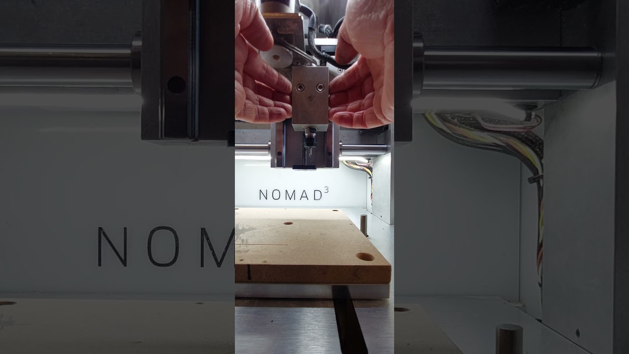

Not sure what to expect but:
(1) tried to move the table back/forward by hand - no movement
(2) tried to move spindle left/right by had and had some play - see the video. Is this expected? I figure not as the table is solid. How do I correct? I’ve heard nothing from Carbide3d support since emailing them and getting the auto-message back 4 days ago. “…We will do our best to respond to your ticket within 3-4 hours M-F during business hours (7 am - 3:30 pm PST) and within 6-8 hours Saturday and Sunday.:cry:
There shouldn’t be any play — let us know at support@carbide3d.com
