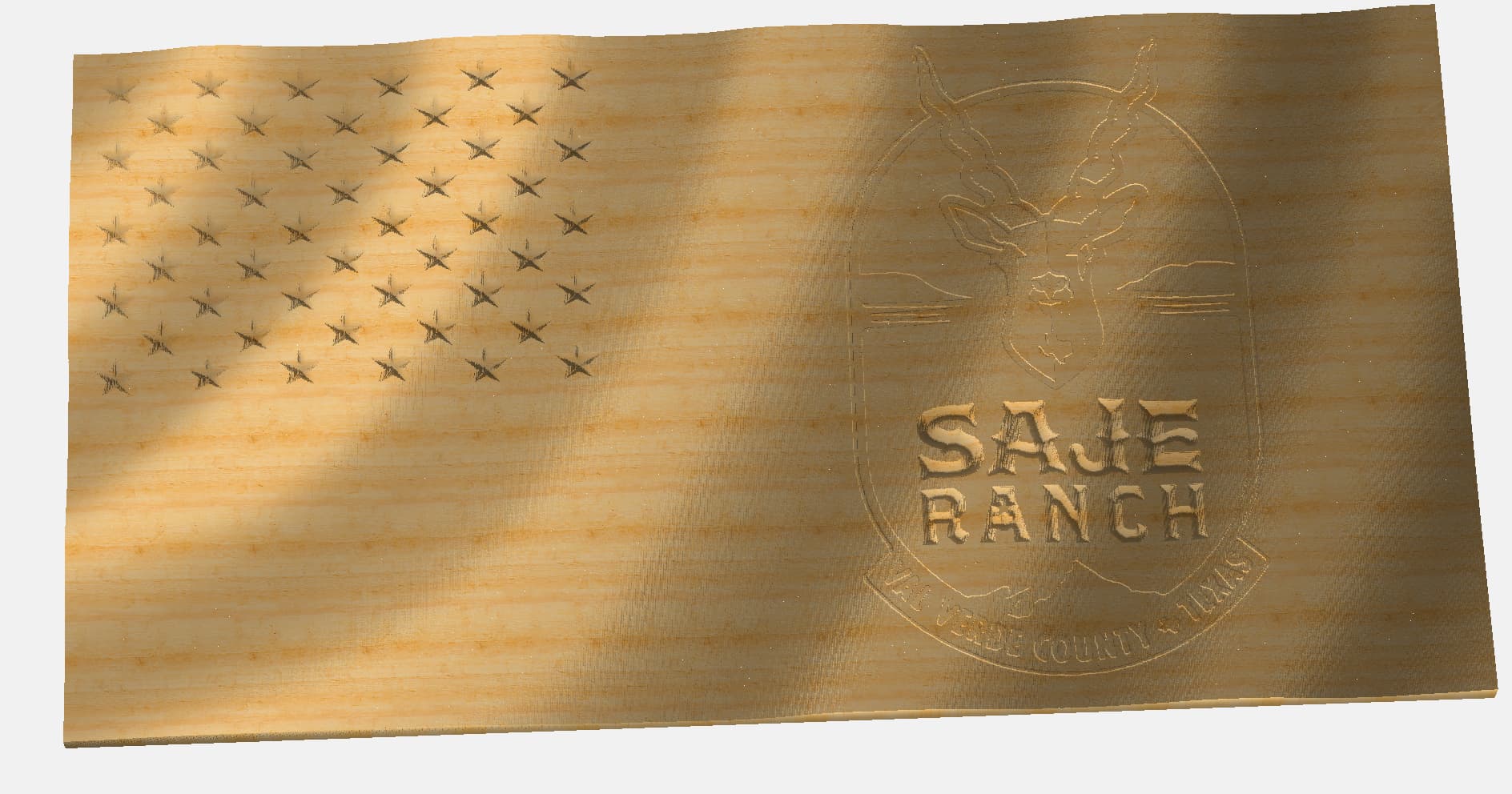

Here is an example, 24" x 45" (Std flag aspect) with the waves cut with a 1/2" ball because I included the stripes. And just the details (logo & stars) cut with a 1/16" ball.
Tod, Thank you, but I feel that cutout of the image by itself doesn’t help me as I want the image to flow with the waves. But I’m still a little new to how the Toolpaths work in conjunction with the 3d modeling.

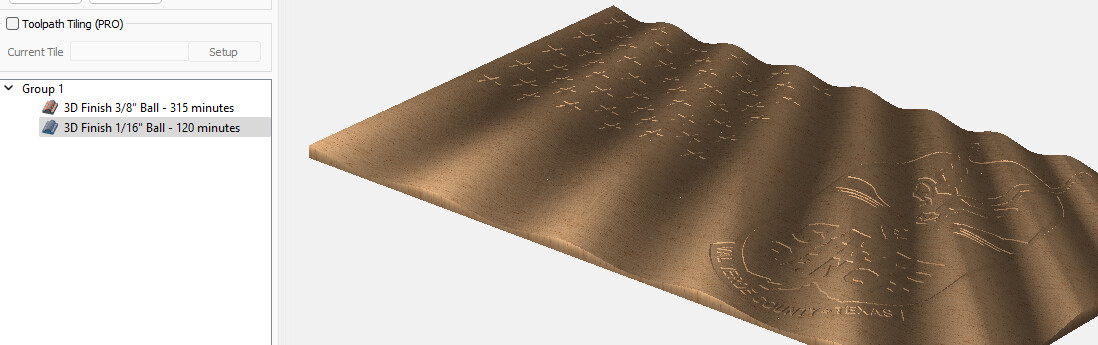

Will, Attached are screenshots, but I previously deleted the Toolpaths because they seemed excessively long.
SAJE Flag
Not sure what you mean by “flow with the waves” ?? The logo in my example is not flat. It’s the 2D logo modeled into the 3D model & cut with a 3D toolpath.
I just modeled the waves (& stripes in this example) and cut them with the larger tool. Then saved the toolpath. Then I modeled the stars & logo and subtracted them from the current 3D model. Then did a 3D finish on just the stars & logo.

Well, I don’t know what my deal is then. My rough public math tells me if I used a 1/4" mill it should double the time you’re showing, but I’m still getting 20+ hours cut time.(Or less because I’m not cutting stripes - I’m using the natural lines of laminate wood panel I built.) I’m assuming it must have to do with my 3d detail somehow. Maybe because my depth of wave is 1/2"?
The stripes and depth of wave should have no, or very little impact on the time.
I removed the stripes, increased the depth of the wave, depth of stars & logo is 0.050
3/8" 0.030 stepover 120 IPM
1/16" 0.010 stepover 120 IPM

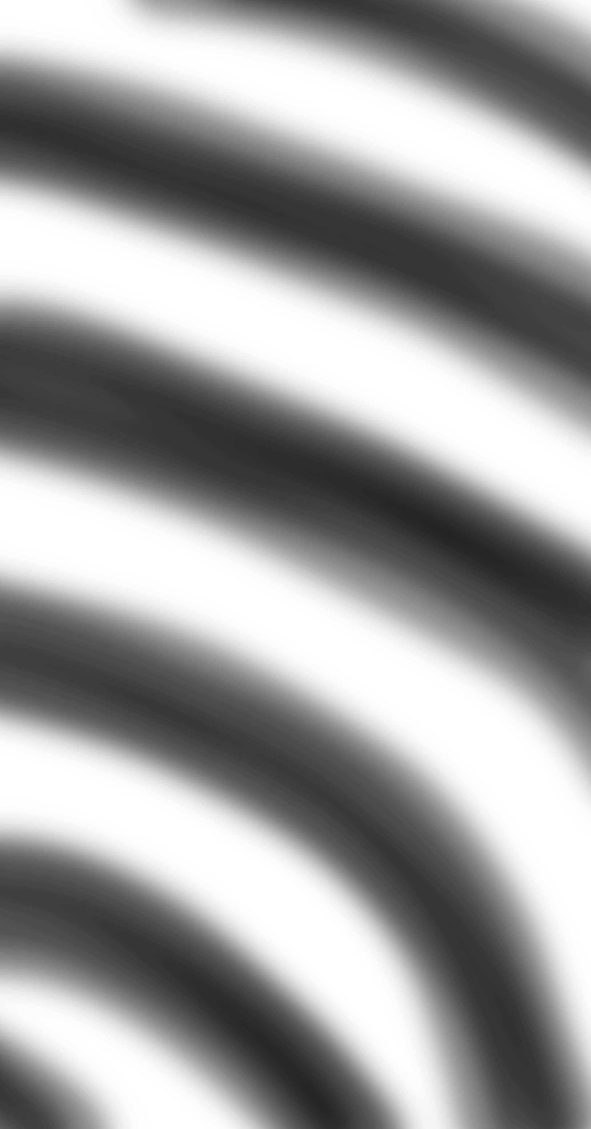

Do you have the gradient image you used for the wave? (without the stars, stripes & logo).
Yup. Here it is.
