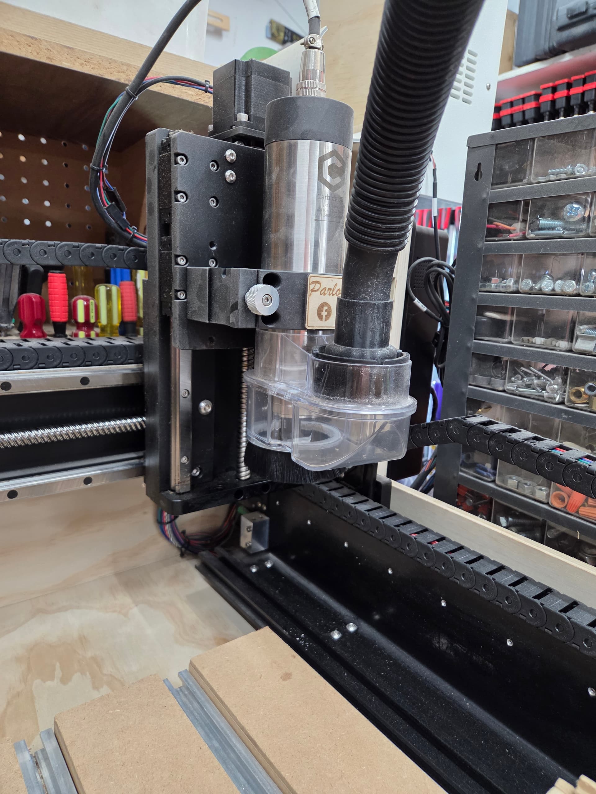

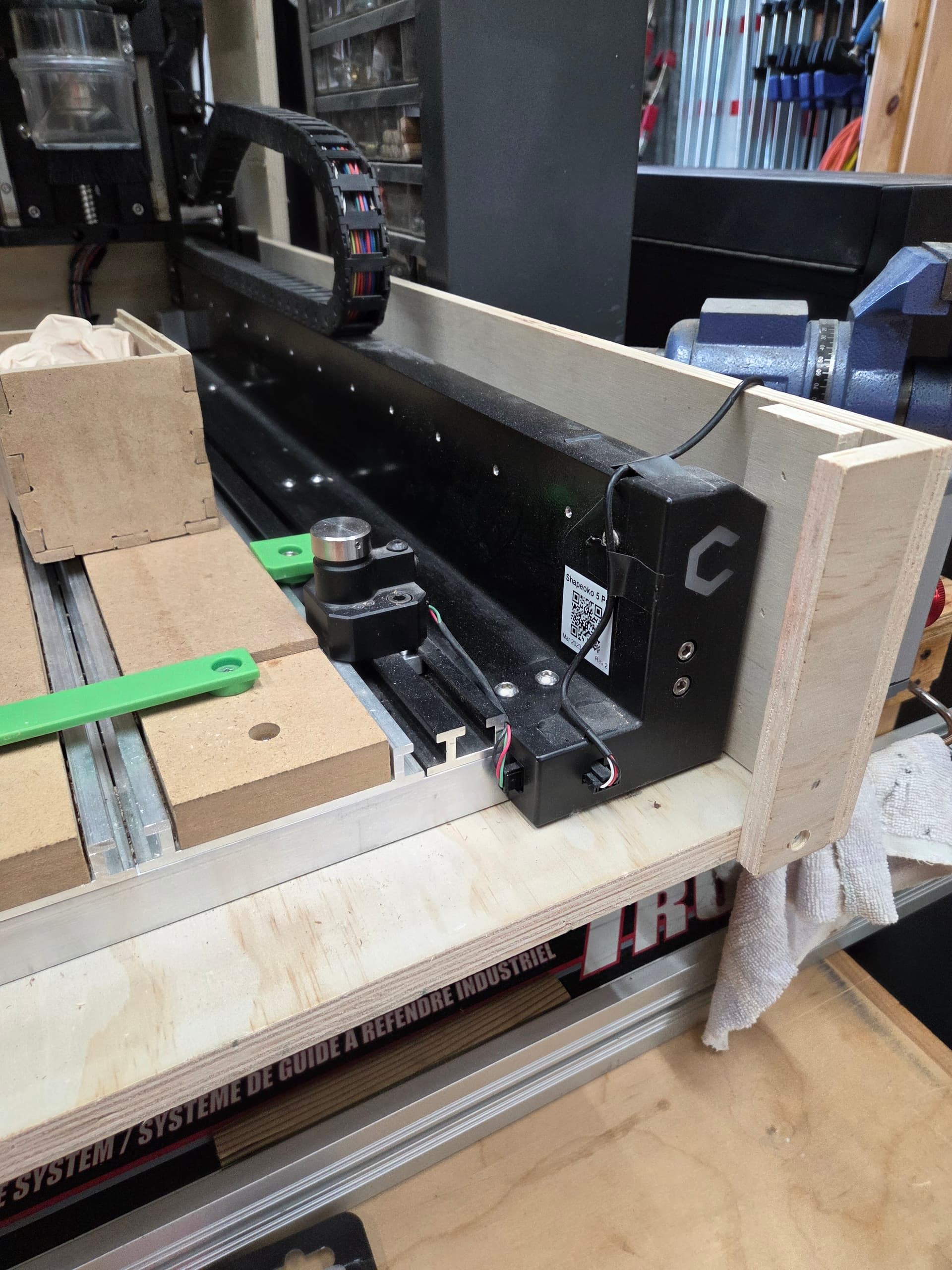

Here is a picture of my spindle and Bitsetter (Or bit zero, I am always comfuse)
Right, you have the deep sweepy there, not the pro.
Take a look at this and you will get a better idea of the issue.
Ok thank you, You are right, I don’t have the Pro.
Good for me. :slight_smile:
I got frustrated and took my Pro off and went back to the plain old amateur sweepy. :man_shrugging:
