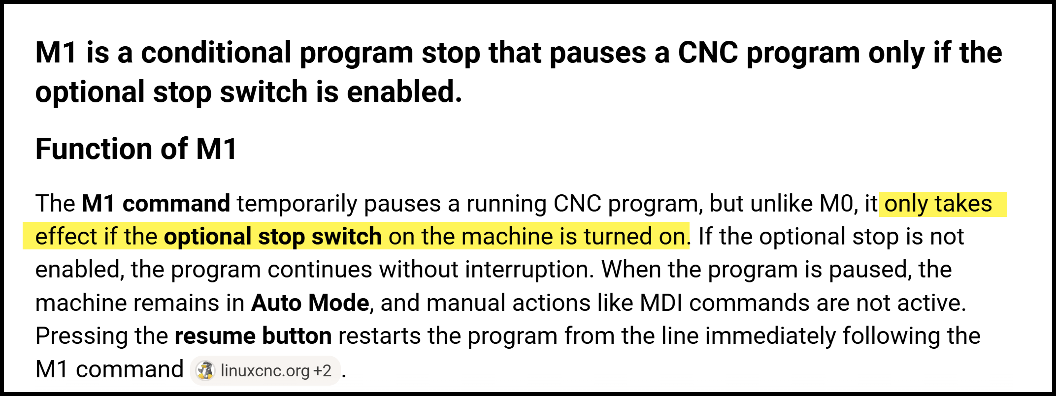

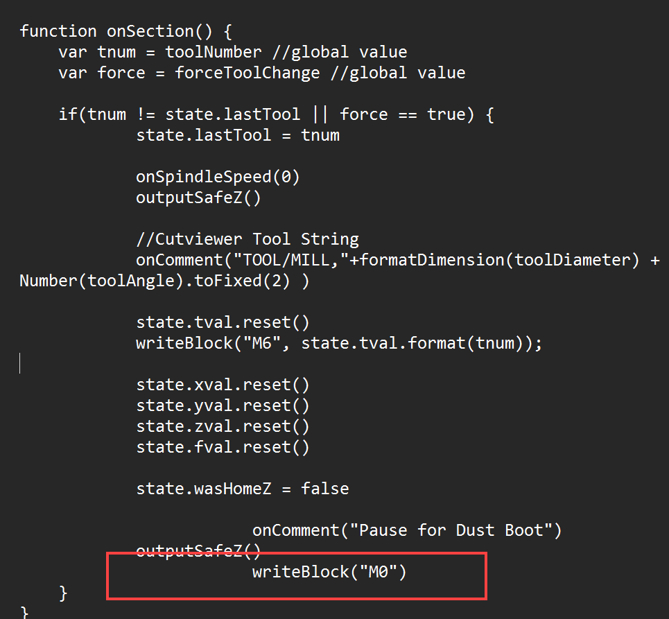

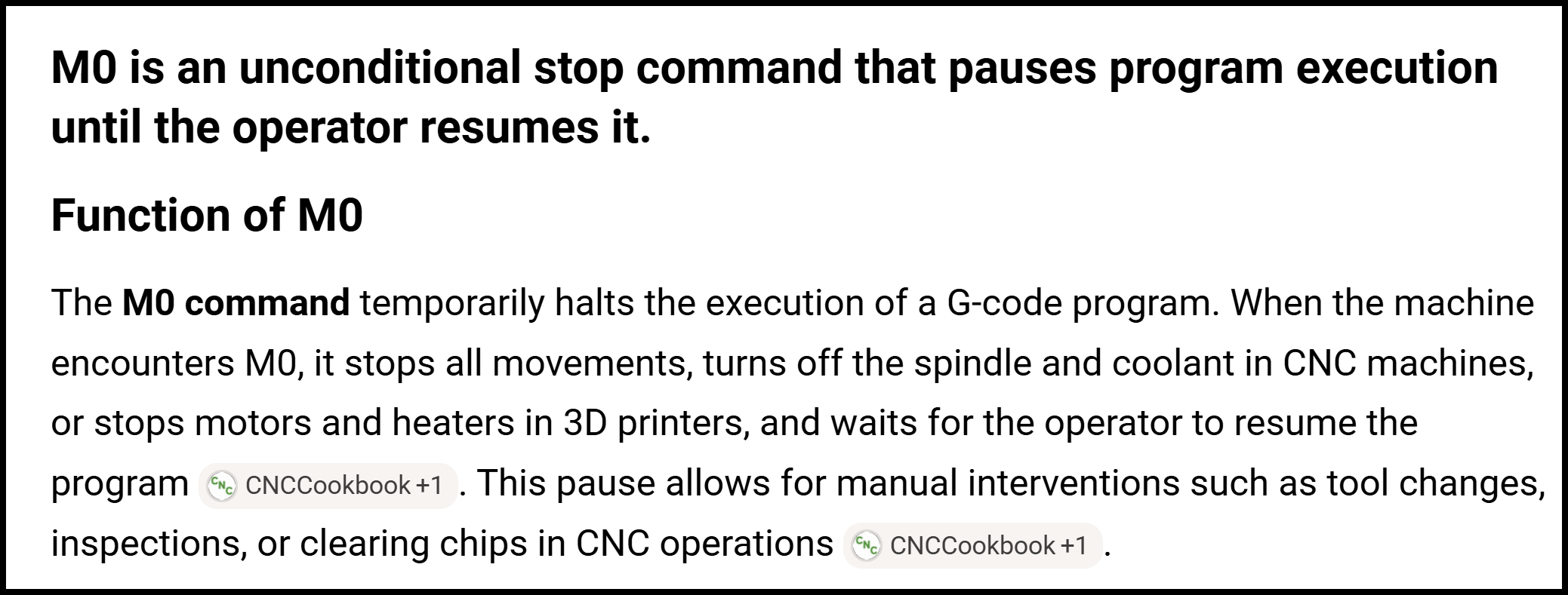

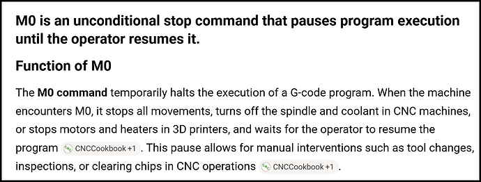

Thanks for the pointer to that, its not exactly my solution but may help. I use Vectric VCarve and the PP from @Allen44
@Tod1d modification to the CC Post uses an M0 command:
In the one from @Allen44 there is an M1 command:
I am not sure what the “optional stop switch” is in context of the Shapeoko machines.
I can try switching the PP to use M0 instead and see if that fixes the problem.

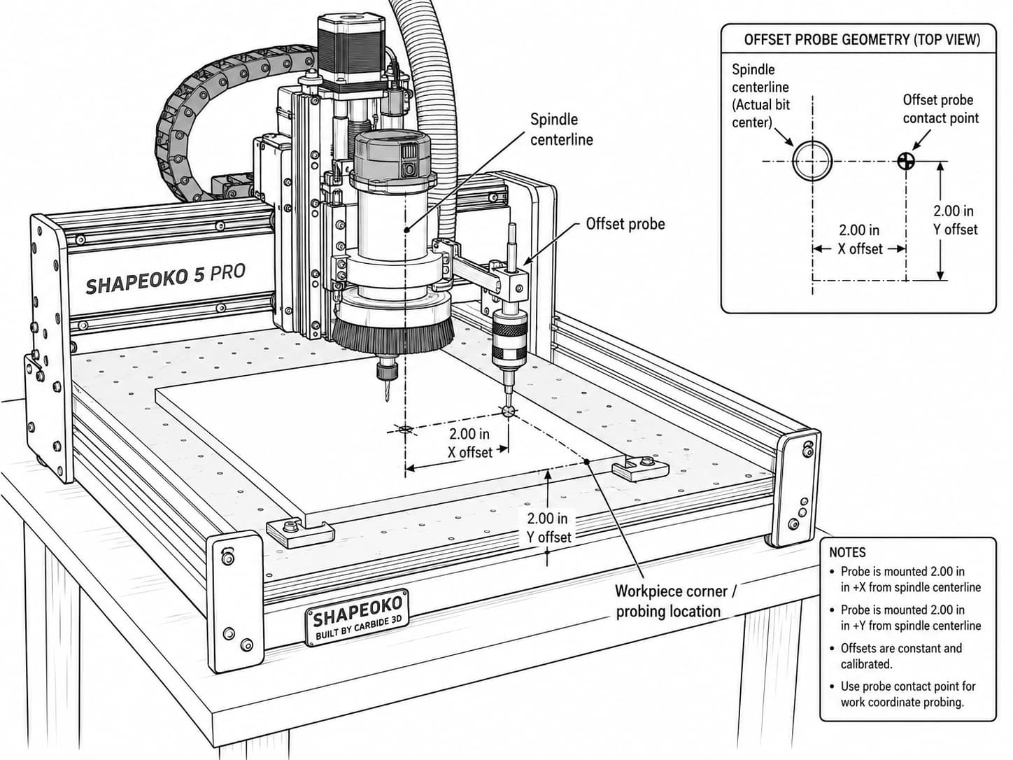

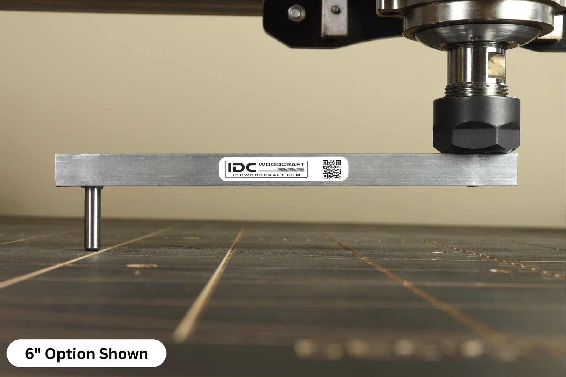

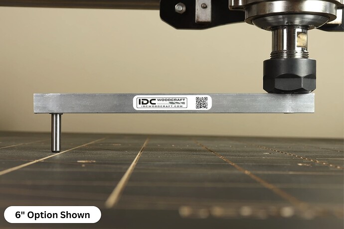

Another potential solution is to use an offset probe. Which would only work for the XY.
Basically, make a fixture that you attach to your spindle mount that offsets where the probe lands.
Then adjust for the offset in your custom post processor.
For example: Make a probe that sits off the center of the spindle by 2" x 2". Then, in your post-processor, adjust for this offset. You’d have to create your own custom post processor for this.
G10
L20 P1 X-2.000 Y-2.000
Alternatively, paste this near the very top of the .nc file, after the initial setup lines like G20/G21, G90, etc., but before the first X/Y cutting move:
(2 inch x 2 inch offset probe correction)(Use only after probing with the offset probe)
G20
G90
G10
L20 P1 X-2.000 Y-2.000G0 Z1.000
Make something like this:
I asked ChatGPT to render something based on my description.
Thanks for the feedback. You can’t use a solution like that with the sweepy pro. And even if you could it would not be ideal given the money invested here. I would rather switch to the sweepy.

@Allen44 sent me his latest post processor for Vectric to test where he replaced the M1 with an M0 and made a few other tweaks. I can confirm that after measuring the bit it moves slightly to the left (a little more would provide more room to get the Sweepy Pro thumbscrews in) and then pauses. It displays a message to put the boot on and press start.
After pressing start it runs through the spindle warmup procedure which I would rather not have since I do that before any jobs for the day and don’t want to do it as part of every job.
Once the warmup is complete it stops the spindle and then moves to the start position and pauses with a prompt to verify position and press start. Once you press start there it spins up and begins the job. I would prefer a single pause and like the idea of it being over the start position which makes setting the boot height easier. But the double pause is OK.
This is a huge improvement to the workflow when using the Sweepy Pro. Kudos to @Allen44, thanks for your efforts on this.
If you guys use Vectric I highly recommend his post processor.
Thanks Cullen! Version 7mW has the 1-minute Warm-up; version 7m does not. Again thanks for testing this version for the 5Pro. I will post the 7m update under the original Vectric Post-processor thread in a couple minutes for all access.

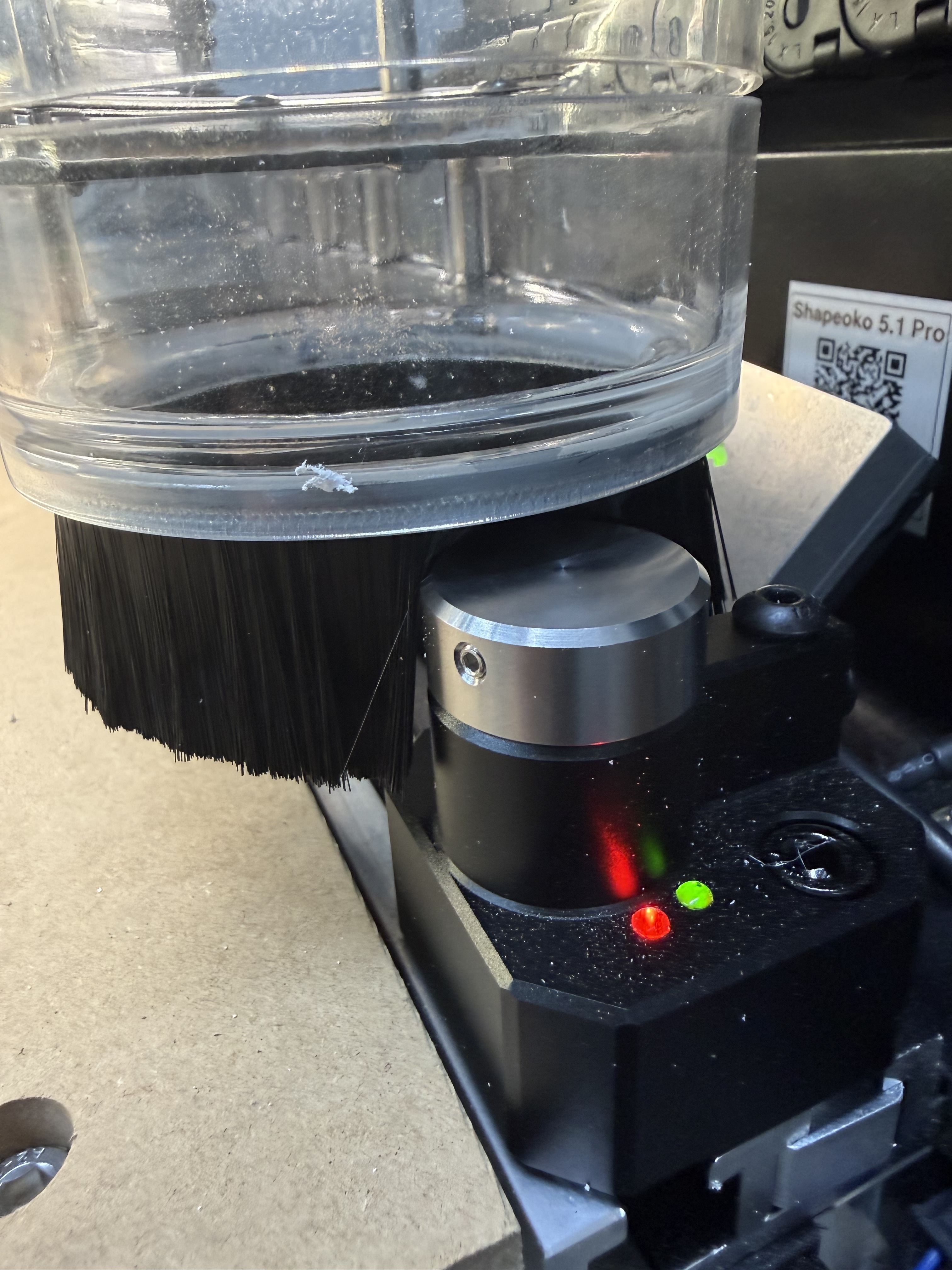

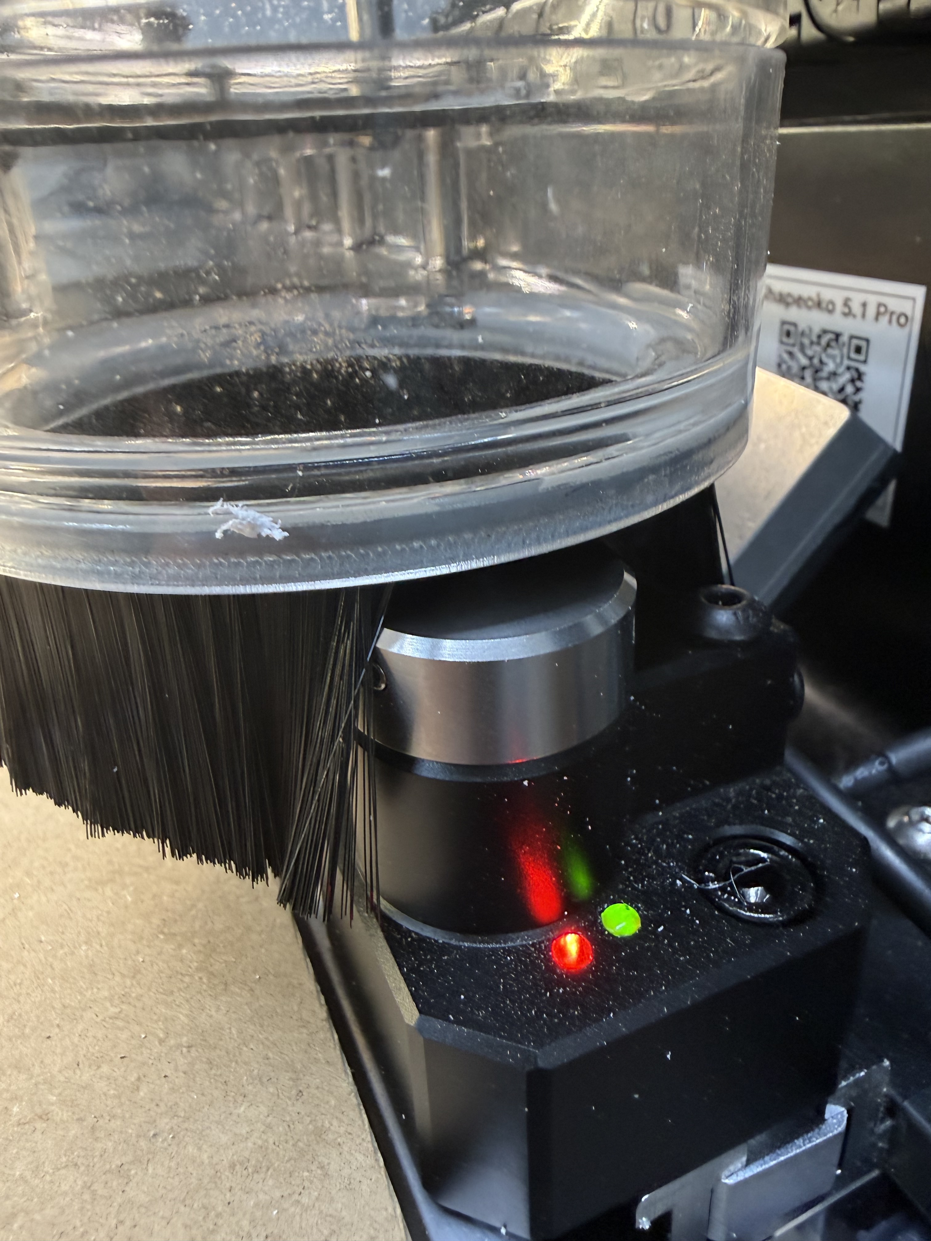

I made an accidental discovery today.
When building the 5.1Pro I installed the 30mm riser blocks from PwnCNC.
Thanks to that the Sweepy Pro just barely clears the bitsetter even when set at its lowest position.
I forgot to take it off during an initial tool measurement after a restart of CM and found that it just barely slides over. The brushes do press the button down but once centered the button pops up and works fine.
As mentioned previously though the downside of the risers is that the brushes on the sweepy only get about an inch from the spoilboard. So, 3/4 is iffy and anything thinner has much less cleanup capability.
