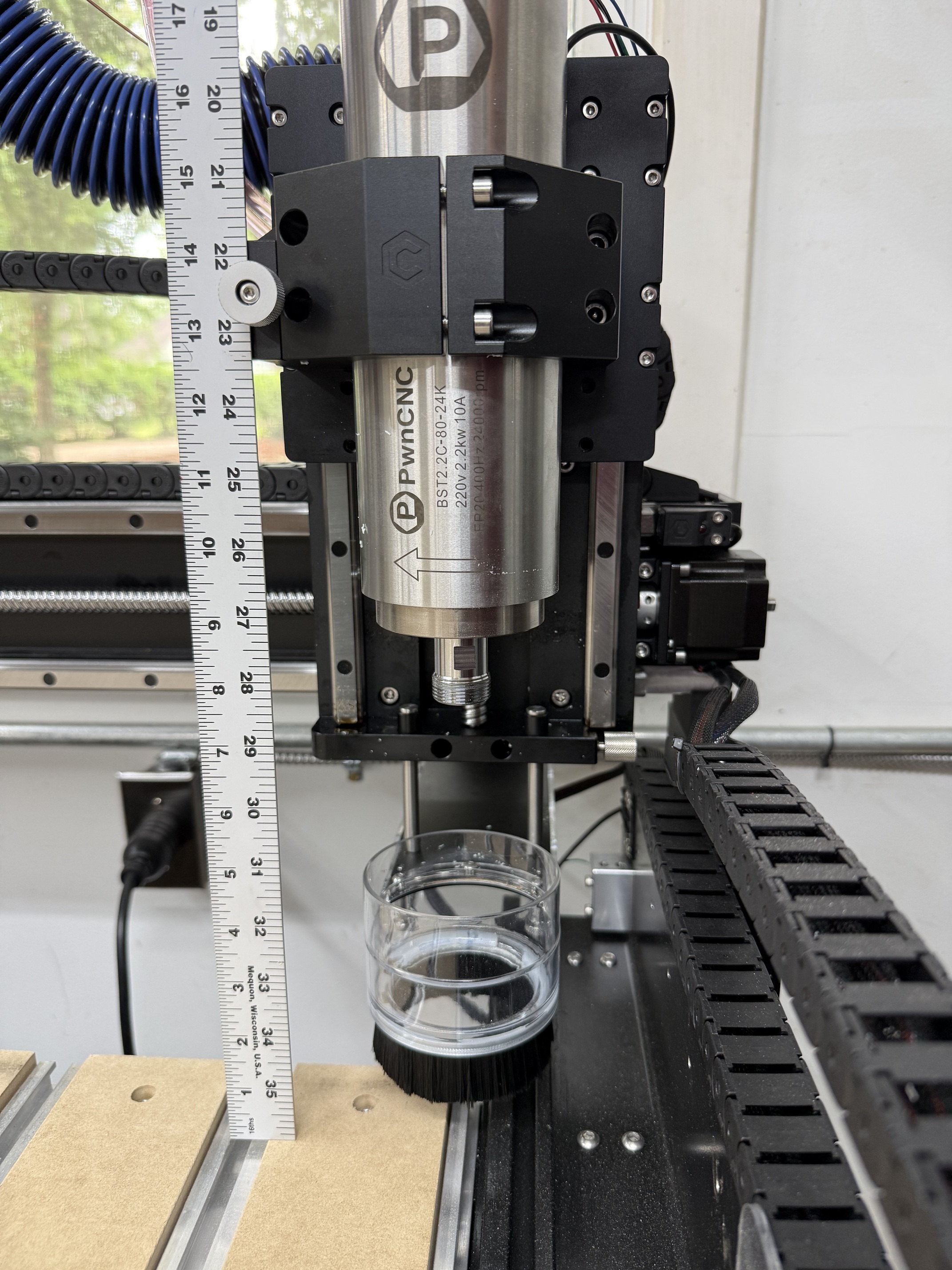

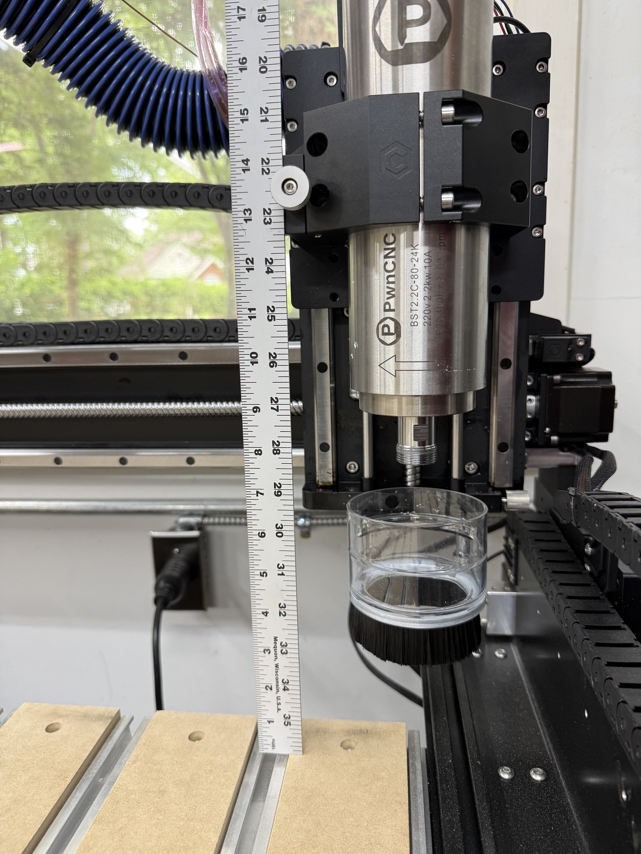

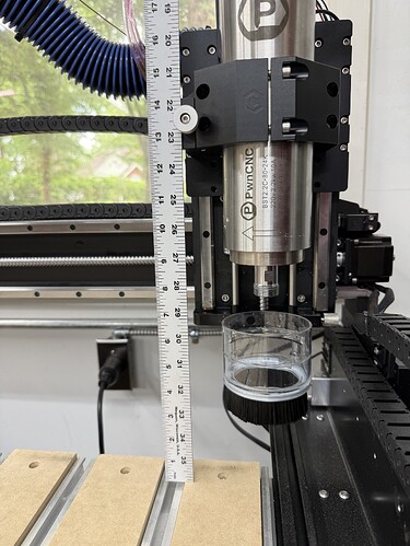

Here are some pics showing my sweepy pro in the highest and lowest settings. Remember that I have the rider blocks installed.

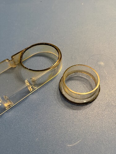

I used my laser to cut the flange out of the insert that had no brushes. It’s not pretty and not exactly centered I doubt that it would let the full body of the spindle through but it should allow the lower section through OK. The width of the overall piece is 80mm so cutting an 80mm circle in it wouldn’t really work.
I will think about the brush attachment next. I will have to see if I can find a jar the right size as suggested by @WillAdams
