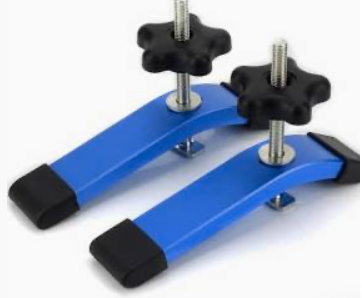

I agree. I once had t-tracks, but they never seemed to be in the right spot. And traditional t-track clamps like those shown below were always in the way and a collsion risk. I’ve since switched to a threaded spoilboard and low-profile homemade clamps made from thin wood.

The same problems with the t-tracks haunt the hybrid spoilboards on the newer C3D machines. But that is why there are red, green, blue and other color cars. If you like the t-tracks great, if you dont like them great. Between painters tape and superglue, the cam clamps, the tiger and gator clamps I am set.

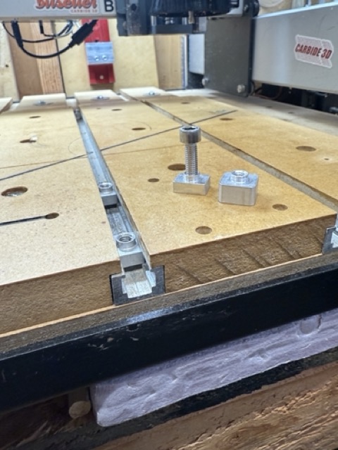

The last set of MDF strips I made were undercut with a relief to accommodate the top edge of the t track. That added a little more strength to the t track mounting. My older S3 uses the original particle board base board with the MDF strips and t track screwed into it.
The nuts in the t tracks are the C3D Teez-Nutz after they were resized on the S3.
