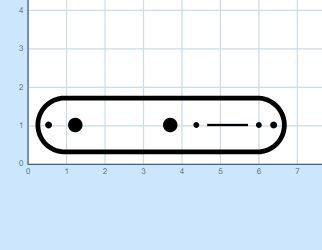

Here is the control plate. I did this in two sections where I milled the initial stuff with a 1/8 bit, made a copy of the project and did the smaller with a 1/16 bit.

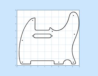

Pick guard
