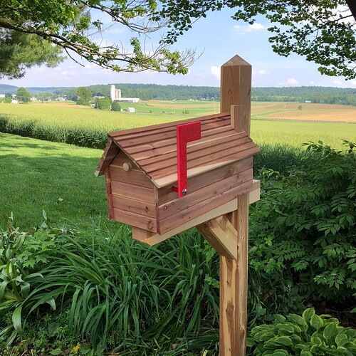

Texture mailbox / birdhouse roof
How to create a textured roof similar to this mailbox
Well, there’s an STL for this sort of thing:
Another option might be to angle your board and do a series of straight cuts.
For some geometries this trick can make things much simpler. I can also make some jobs go much faster than having to interpolate steps with progressively smaller tools.
