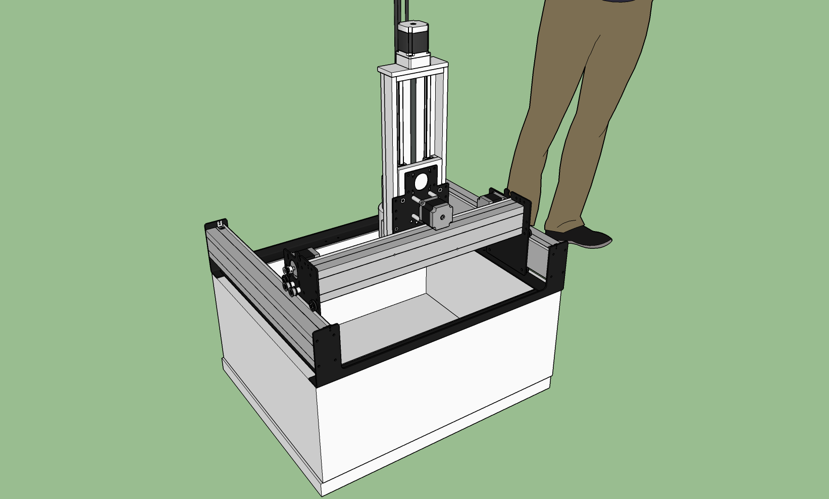

Hi, I’ve discovered the woeful inadequacy of the shapeoko z axis with a 2.2kw spindle. The x and y seem to be doing alright, but they don’t have to lift the spindle weight in the same way… I saw your HDZ ballscrew actuator while fishing around for a solution. I’ve been thinking a bit about it, and I wonder if anyone can tell me why I shouldn’t try something along these lines? Please bear in mind this a very quick thrown together model to demonstrate what’s in my head…
Advantages over conventional ballscrew mounting are:
  • useable cutting travel all the way down. This drawing shows 300mm of travel
  • better shielding of the sensitive parts of the Z axis from the mess produced by cnc routing. You could even put bellows on to cover the gaps above and below the X axis extrusion.
  • good stiffness at short cutting heights - where the work is close to the x axis.
Problems:
  • worse stiffness when cutter is far from the x axis through torquing the x axis extrusion. Could it be lessened by an angle iron screwed to the x axis extrusion or a second box extrusion?
  • motor has to lift itself and the weight of the ballscrew linear actuator and the spindle and do several kilos of cutting… I see many ballscrew kits with 50kg lifting capability for a z load. I think all of this is maybe 15kg estimate?? So seems do-able?
  • would the shapeoko’s delrin v-wheels be up to dealing with this sort of weight hanging off them? (I guess so? the HDZ is not very different, and apparently that works)
  • not really a problem, but the z direction would be reversed. clockwise rotation would bring the spindle up… That’s a simple grbl fix I think? Also the z limit switch would need to point down to stop the spindle side frame as it comes up.
What do you think? Are the physics of a ballscrew linear actuator holding a spindle pretty similar whichever way round you have it? The rub comes if you do a long extension like I drew… But that’s down to the torquing that happens due to the cutter load hanging off an increasingly long lever… Stiffen the X axis extrusion or take increasingly light cuts as you move down could solve this?
I drew this using a shapeoko model I found on the sketchup 3dwarehouse. Mine is an XXL and has the new z plate (although that would be irrelevant in this scenario) The XXL would be the worst model for handling the torquing issue…
Again, your thoughts?
I’m running the HDZ was one of the earlier adopters of it. I also run a 2.2kw water cooled spindle. All I can say is it was worth every penny I paid. Had issues with the design of the stock z-axis have no issues with the HDZ. It’s well designed and well implimented. Luke has also sourced heavier derlin v
wheels for the upgrade, and also has heavier eccentric nuts that put the stock nuts to shame. Switching directions for Z travel is just a simple machine code edit. Along with TPI adjustment. The Z-axis will not drop on shutdown, nor slip like the origional.
Do yourself a favor and just buy one now and save you all the trouble a 2.2kw spindle on a stock z-axis will give you.

That would be nice to start planning out the next reiteration of ShapeOko. The issue is though the ShapeOko is and was always designed to be an affordable entry machine. And they have done wonders, they have gone beyond entry level as a whole for an entry level price. But as you try to get more accuracy and regidity the price goes up exponentially. Most people agree the z-axis is ShapeOko Achilles heel and thats where people like Luke come it with aftermarket modes to make a good product better. I doubt ShapeOko would incorporate something like the HDZ because of cost, but who knows maybe an upgrade to the people who really want it. I am very happy with his design myself and am working on the belts next (steel reinforced) to make it more solid. Then on from there. The beauty of ShapeOko is you can make anything you want out of it.
