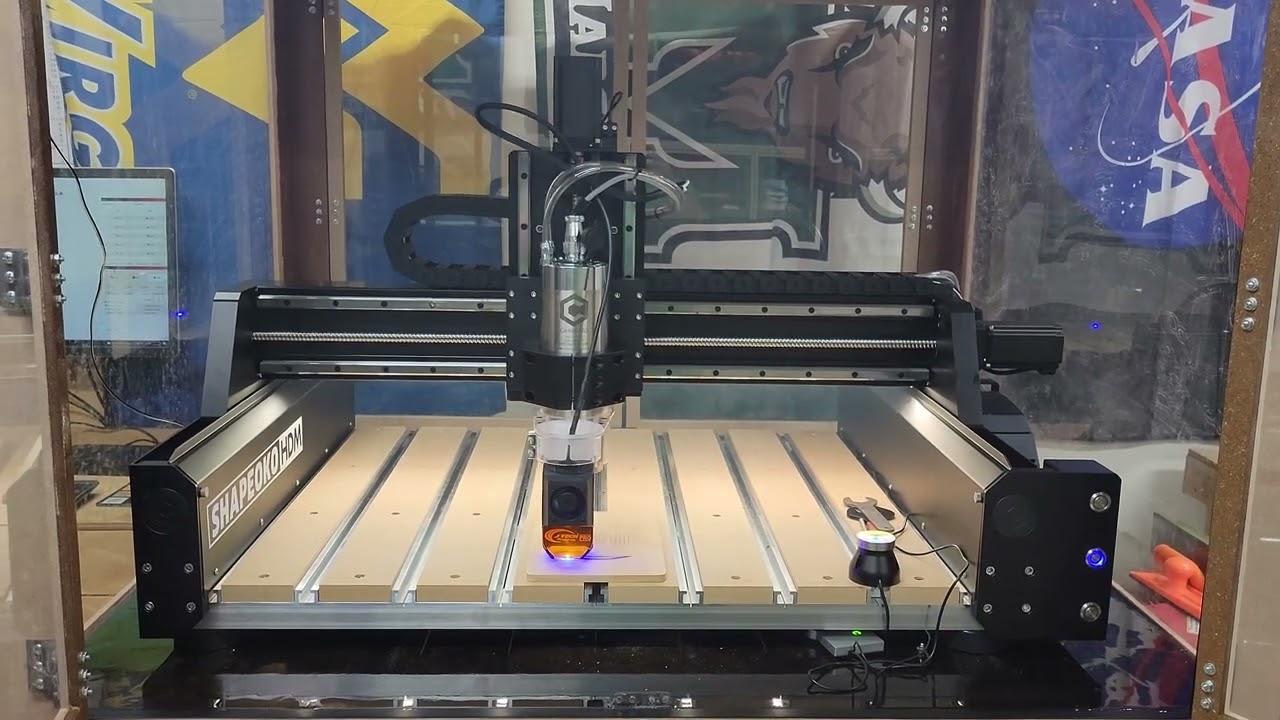

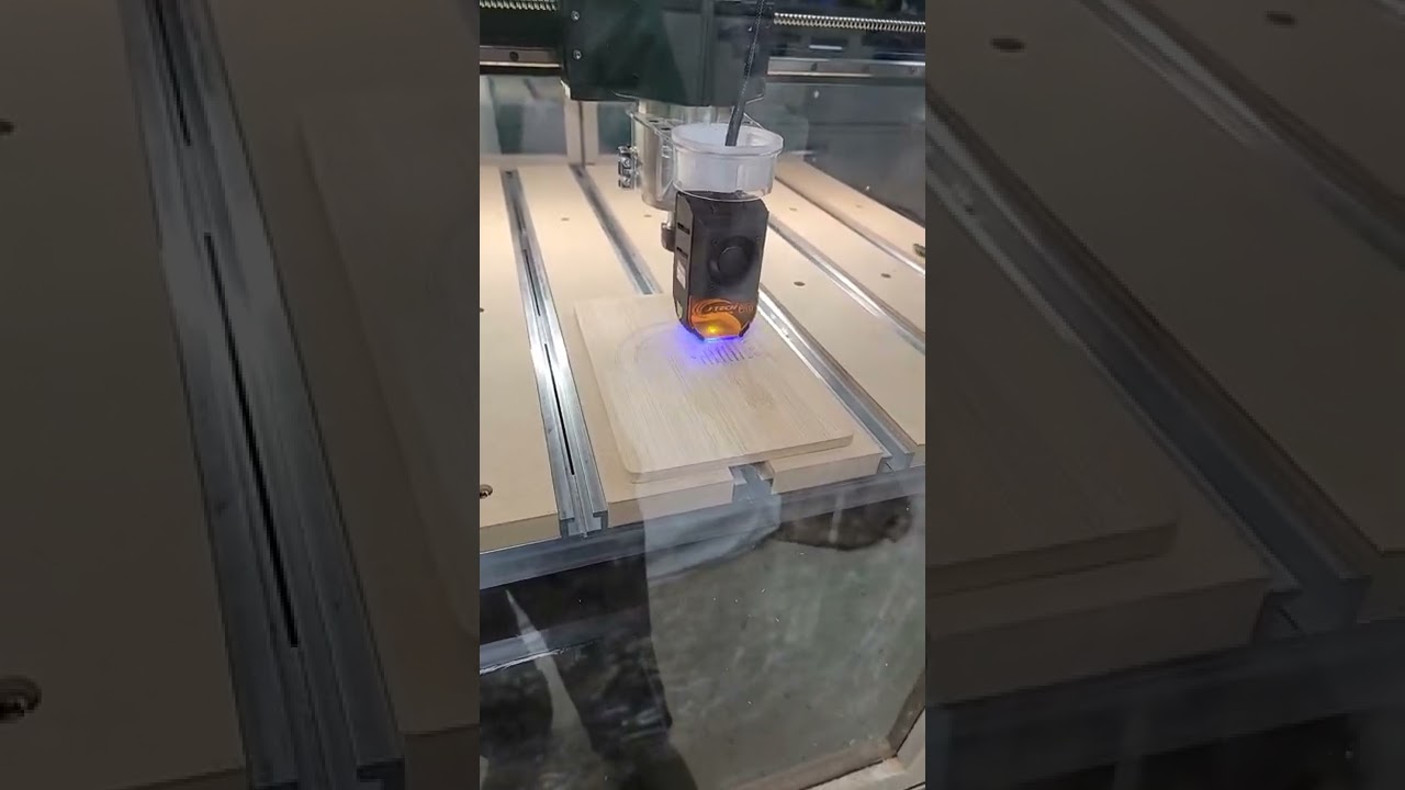

Obligatory first laser work
After some initial testing I’ve found that lowering the X and Y Accelerations from 500 mm/s^2 to 200 mm/s^2 make for a much much smoother machine. Yes I’m sure the HDM can withstand 500 mm/s^2 accels but it’s too violent for my taste. There isn’t a marked difference from 250 to 500 so I personally see no need for it to be above 250 even.
Addition 2
-I’ve integrated the JTech Photnonics Laser. Very simple. There is an unpopulated spindle header that you can install a standard .100 2 pin header into and everything works just fine from there. Just be sure to lock out spindle when in laser mode. I’ll update Jay’s mounts to fit once he sends the files and post my mount once It’s done.
-X and Y accelerations are too high for my tastes. Someone with nicer test equipment can chime in but I notice no difference in accelerations until below 250 mm/s^2. I’ve settled on 200 mm/s^2. Machine is much less violent.
-The electronics box really, really, really needs aviation plugs or some polarized disconnects. And the cabling needs to be either longer or we need the option at time of order to order longer cabling. I need longer cables for the Bit Setter and Bit Zero Also. I guess I’ll end up extending them so I can actually use them.
-Also Hockey Pucks make for a great stable noise isolating base.
M3S1000 is the command it’s sending. This should be updated to M3S8000 or greater.
