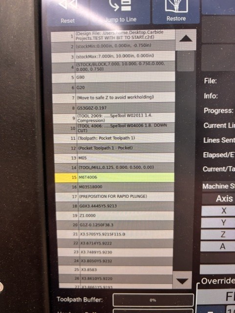

Hey Group does any one have a link or file I can download for a tool changing custom post processor. I made a post many months ago about custom post processor, with me using Carbide and my onefinity with Redline HMI. I was having issues with it wanting a tool change and spindle wait at the start of a project, that was sorted out but now I’m looking to edit or use a different post which will add in tool changes. If I use Basic G-code Or GRBL it will bring me back to my original issue with the M0 tool change at the start. Ive read the section on editing the “on Section” but I’m unaware of how to properly doing this with out messing it up. Any advice would be appreciated!

Have you tried the Shapeoko post processor? It’s very generic and uses M6 for tool changes, which is the standard way to do them. I would be surprised if it didn’t work as-is. If not, send over the error messages, and we can probably figure it out.
SHAPEOKO TEST TWO BITS.nc.zip (2.1 KB)

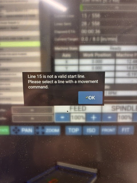

This is the Shapeoko file simple two tool letter and a pocket. Im getting a stoppage at line 15 and it saying its not a movement line.
Line 15 is:
M6T4006
and I believe that matches Carbide 3D Shapeoko.
What happens when you try the Masso post?
I get the same pause. The only way I have gotten the tool change with no issues when I want the tool change it with this Post, but I don’t care for the tool change at the start after I have already set my X,Y,Z so was curious if someone would have the means of writing that out?

The way I read that error message, it seems like you’re trying to restart the program on that line, and starting on a non-movement line is not allowed.
If that’s the case, can you run it from the start of the program?
I tried multiple times to run it from the start it jumps to line 15 then waits, restarting it doesn’t make a difference
