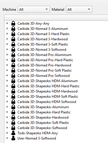

I have been mostly (aside from maintenance and a project for the wife) away from using my CNC machine for almost a year (medical reasons) and at that time I had created a Duplicate Tool Library with a new name and then drastically reorganized and eliminated many of the end mills that I would not be using to make tool selection easier.

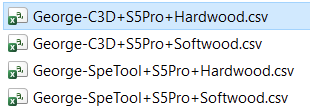

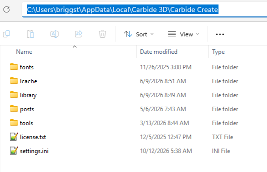

I may have screwed something up last year in that I can’t seem to find the separate default tool .csv files that only have my truncated list. I see the library file I created and in that .csv file I can only see the Carbide Create default tools under the name i created and not and of my updates . I do think I am in the correct folder since I can see the duplicated library names. Within Carbide Create itself, I can select either the default system entries or my truncated library by selecting a different “Machine” name for tool selection.
I also seem to have duplicate CSV file names that appear to be backup names (with only a tilde symbol as the first character). I think I should be able to safely delete them.

The “Carbide Create” folder and path match mine. So I do appear to be looking in the same location. No problem there.
For the filters:
If I select ALL, I can see Carbide 3D items, the new library that I created with entries, and any 3d party tools (like SpeTools). No problem there.
If I select ANY, it is a weird list of just a couple of Carbide 3D entries as seen here.
If I select my library name I do see only my new entries. So no problems there.

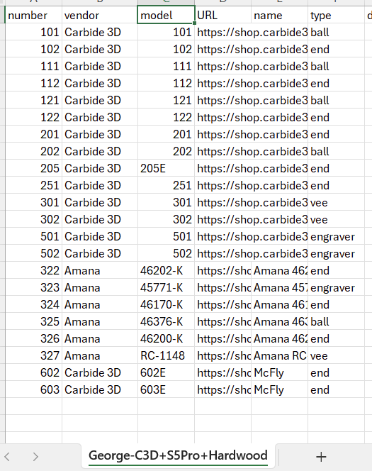

BUT … when I look at the CSV files, I see the below sniplet:
What I don’t see is the default Carbide Create standard tool file names – only the data!! I see the below for one of my custom libraries:
Note that only the standard Carbide Create items appear and none of my custom ones! And this is only under my unique name. HENCE my confusion! Where are my shortened tool name list and why do i see the the Carbide Create listings without my additions?

Note that the internal Carbide 3D libraries are just that — internal — they are not exposed as .csv files, unless one copies them one tool at a time:
and rebuilds them.
Even then, the official Carbide 3D tool #s have a special status and additional information in the apps.
List of those tool #s at:
Will … so why am I seeing the data for the Carbide 3D Tools in my copy of the CSV files even though I deleted the unused tool names? The names are not in the tool selection drop down, but the names and data are in the mentioned CSV files as shown above? Thanks.

FYI … Uninstalling does not wipe the local data including any libraries you created. You need to manually delete the contents of the TOOL folder.

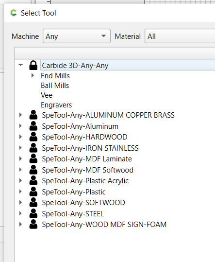

What is the difference between ANY and ALL? After the reinstall, selecting ALL for the Machine and ALL for the material shows that CARBIDE 3D-ANY-ANY library entry with only MC Etcher in it. This can be seen in one on my posts above. It still looks dumb sitting there. Why is that entry there?
Thanks.
Any means the machine, “Any”. Not the same as All
Notice all the libraries listed have the string, “Any” in the filename?
Naming Convention
++.csv
If you are editing the .csv file while Carbide Create is open, it won’t cache the file after the changes. You have to close CC & reopen it to read the latest version of the tool libraries.
However, if you edit from CC, the changes get updated immediately in the .csv
Tod /// See my post before yours … if I select ALL - ALL then I still see that entry with only MC Etcher defined.
So , for Material, ANY and ALL are not the same … though I can’t rationalize a difference … but either ANY or ALL for material still gives those silly MC Etcher selections only. Why?

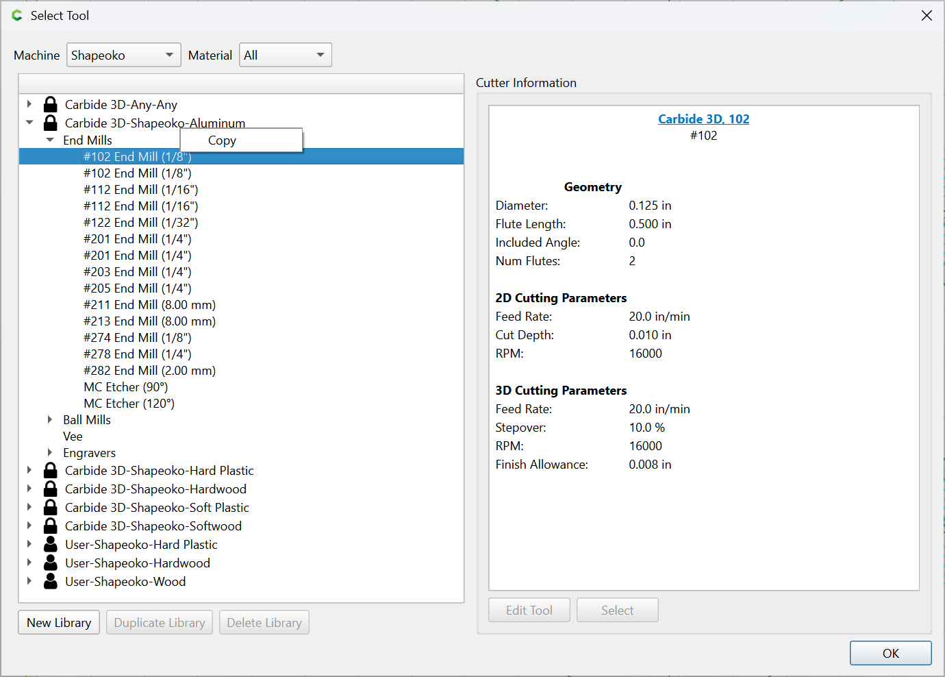

It is a little strange. If I select a specific machine, “Shapeoko HDM”, and an “Any” material, I still see the Carbide3d-Any-Any library, even though it’s not a “Shapeoko HDM” machine.
So, “Any” gets included with a specific material, But the “Any” machine is exclusive.???
Tod … Does your ANY show just the MC Etcher end mills only? Thanks.
Machine: Any Material: Any
show only the Carbide 3D-Any-Any library, which only has the 2 MC Etchers.
Machine: Shapeoko HDM Material: Any
Show both the Carbide 3D-Any-Any, and my Tods-Shapeoko-HDM-Any libraries
