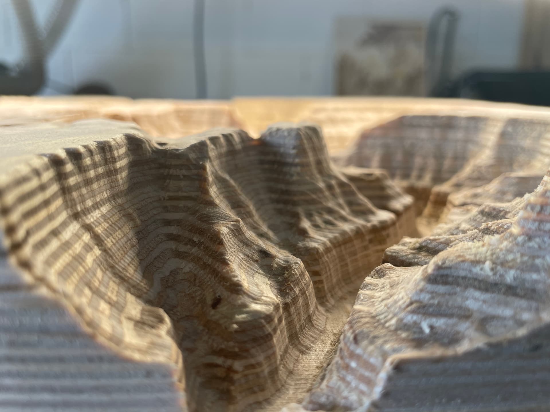

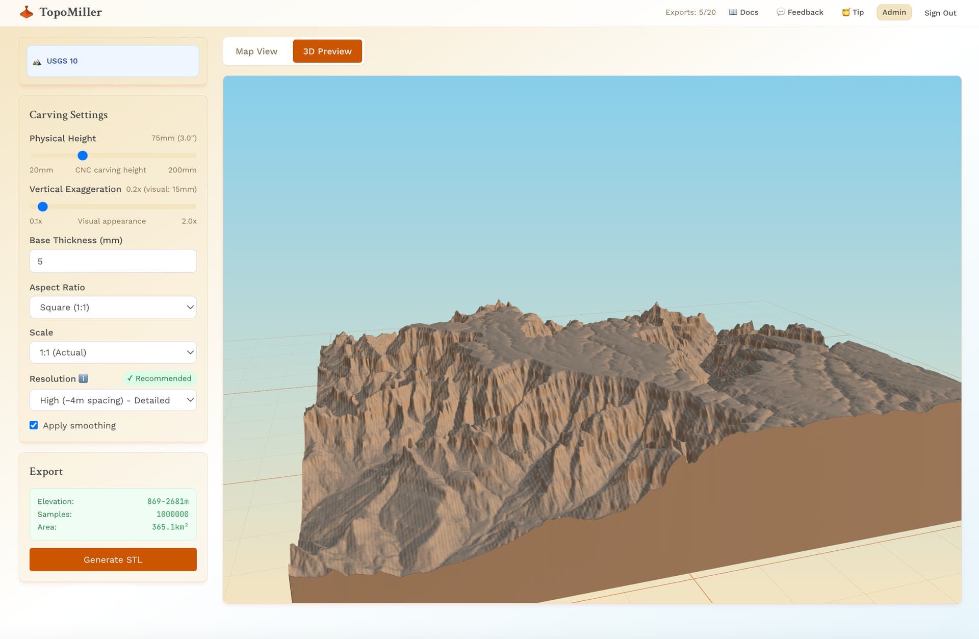

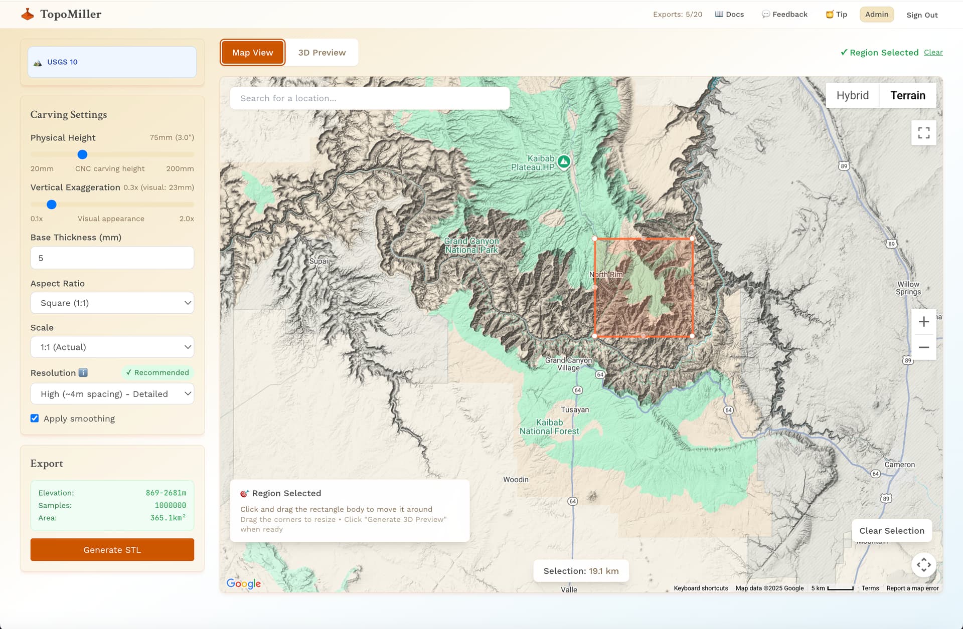

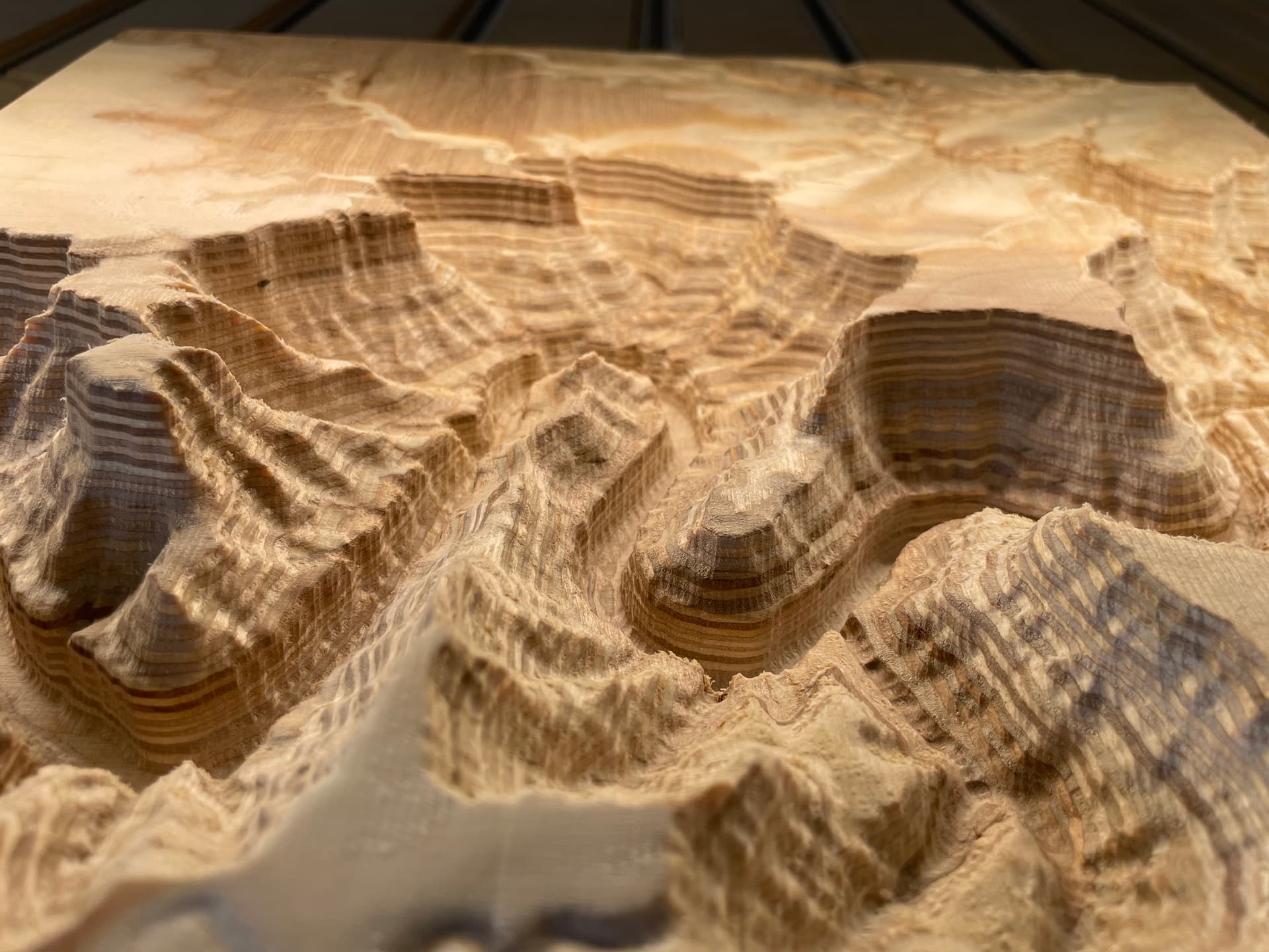

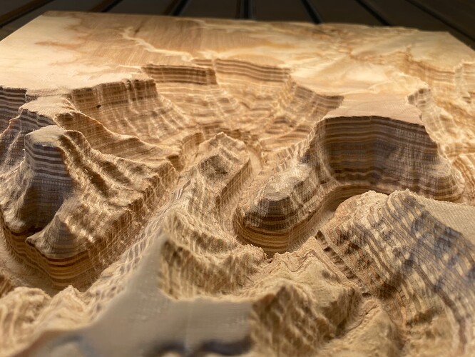

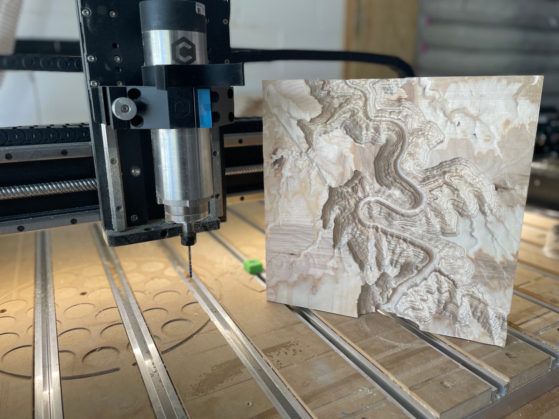

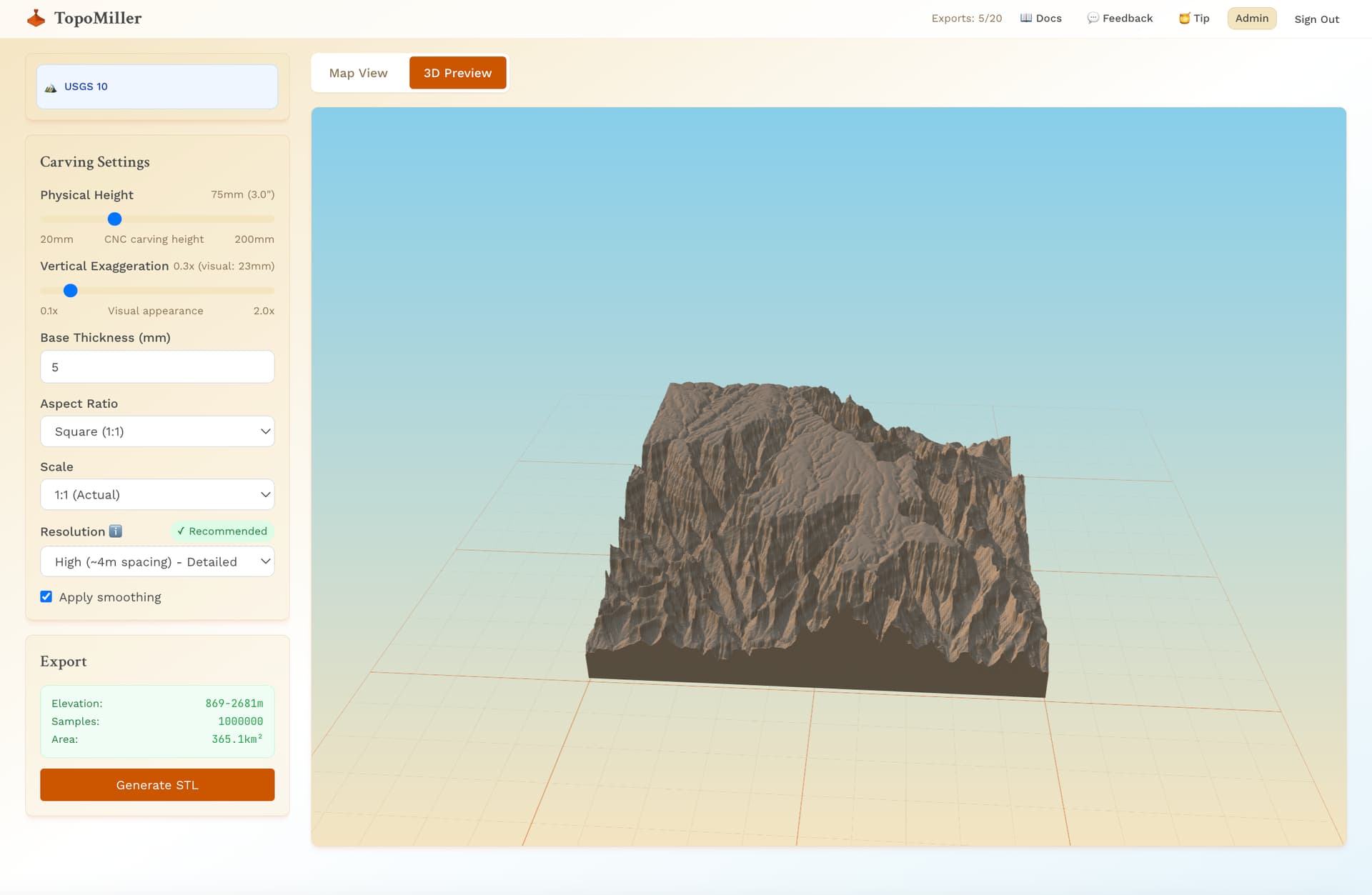

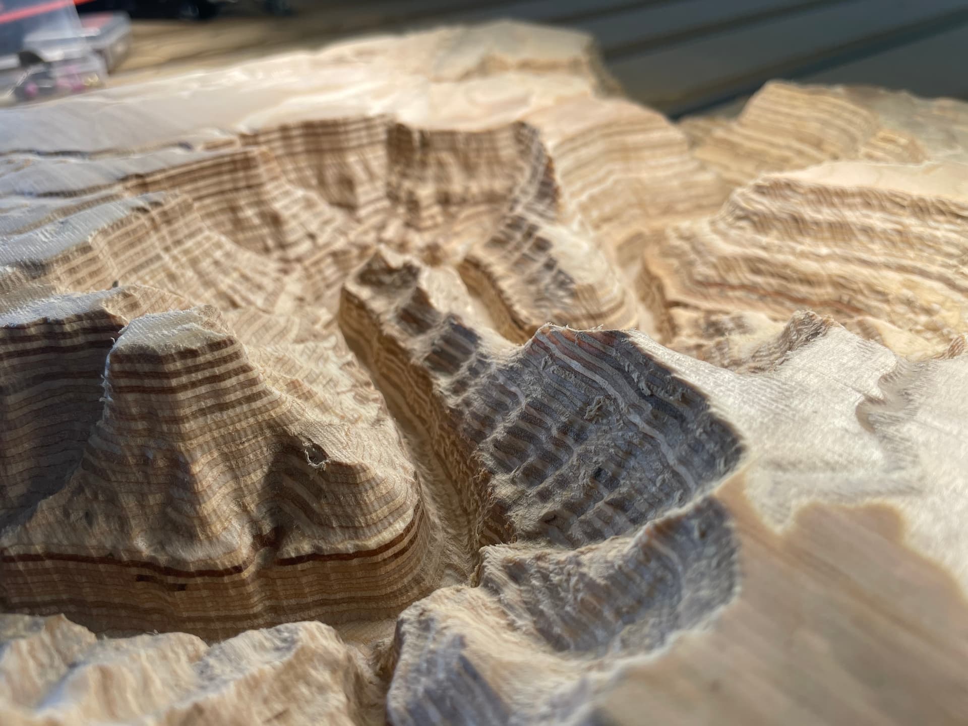

I’ve always been interested in 3D Topographical Relief carvings, but they have been intimidating. I created TopoMiller - a free tool that made it easier for me. Would love feedback for any who are interested!

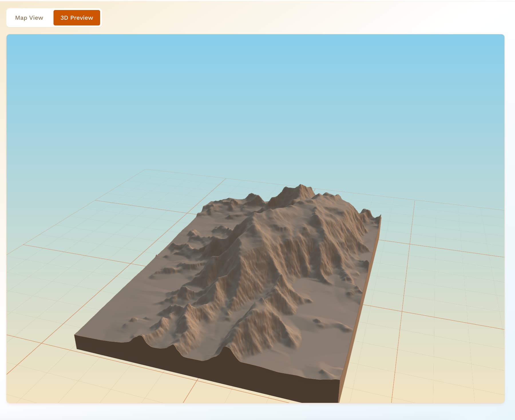

Interestingly, it does seem that at least some parts of Canada are included in the USGS 10M data set that I am using for TopoMiller. Here is Mount Logan.

I took a look at it also. Do you know recent the map data is?
Hi, @Ed.E,
I am using USGS 10M data from the USGS 3D Elevation Program (3DEP).
After a quick look up, here is what I found:

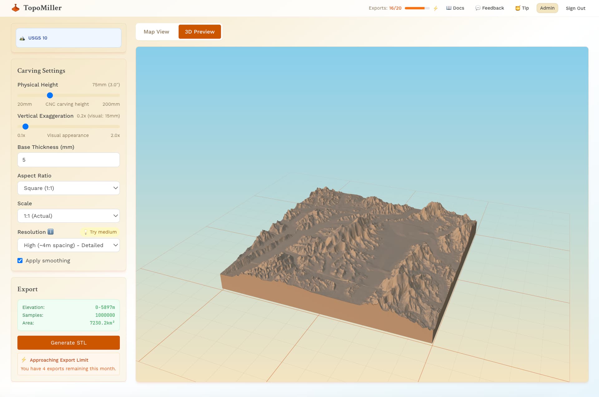

This is extremely cool! I will definitely be using this. First question/feedback is around resolution choice. The defaults work well for larger areas, but i was testing with something smaller like my suburb in Nashville. Its pretty hilly so would be an interesting job and it felt like the resolution needed to be higher. Curious if there can be some way to let the resolution max can be influence by the total area? Totally get you need to keep the triangle count down especially on dog ass slow computers, just thinking it would be nice to provide a bit more control so we can do smaller areas.
Also noticed the confirm email was still branded from Supabase instead of TopoMiller. Being a supabase user myself i knew what it was but could confuse some new users.
Bravo on this extremely cool project!
I found the verification email in my spam, and then when I clicked the activation link, it said it failed, but i actually was still able to log in after that. maybe something like that?
I would 100% agree that higher resolution data needs to be high priority on your feature roadmap. It could easily be tied to area chosen, like inversely proportional to square area to maintain a relatively stable overall file size or some such.
The option to drill down (ha!) to a small geographic feature, but model it in higher res would be killer.

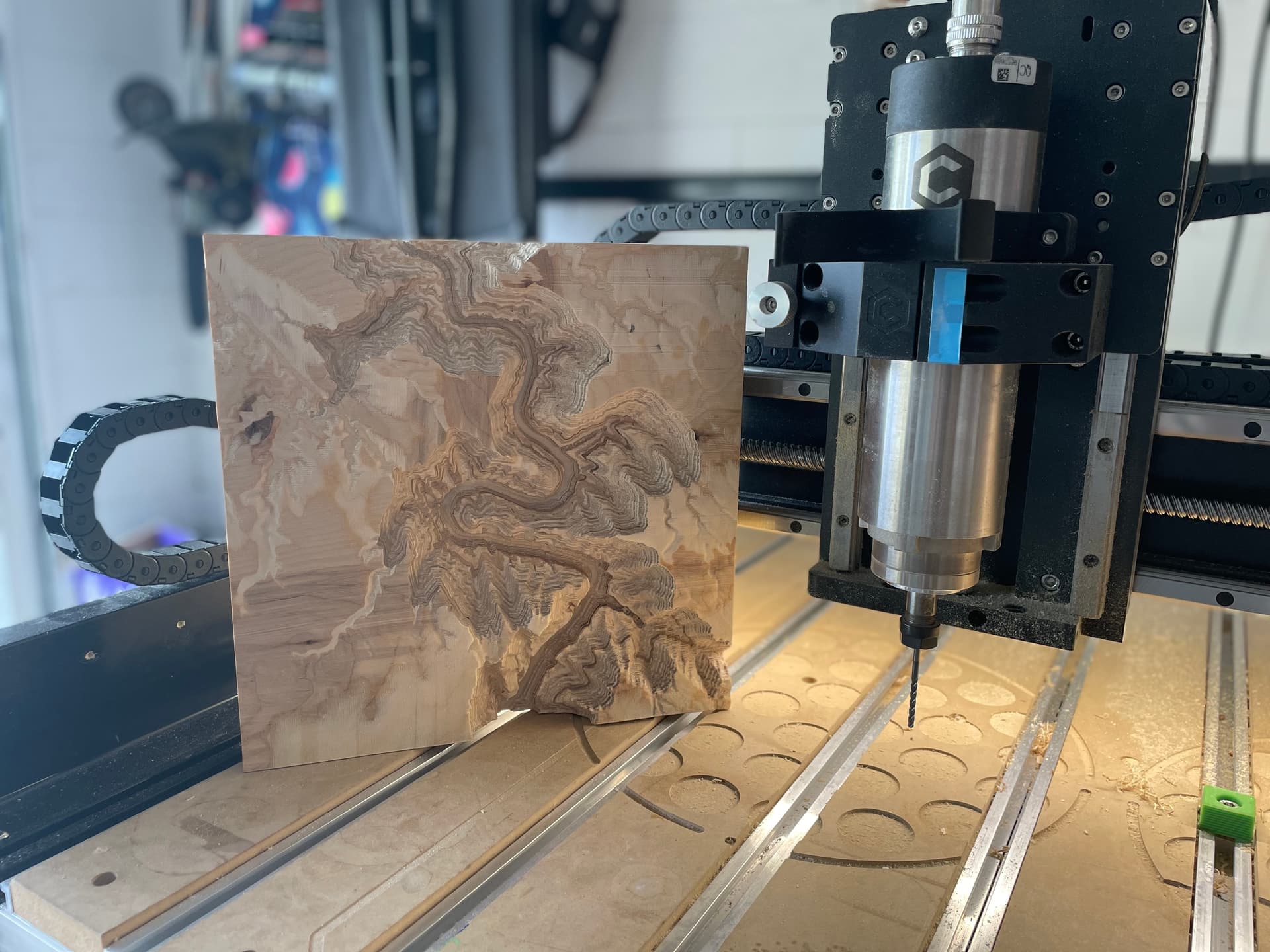

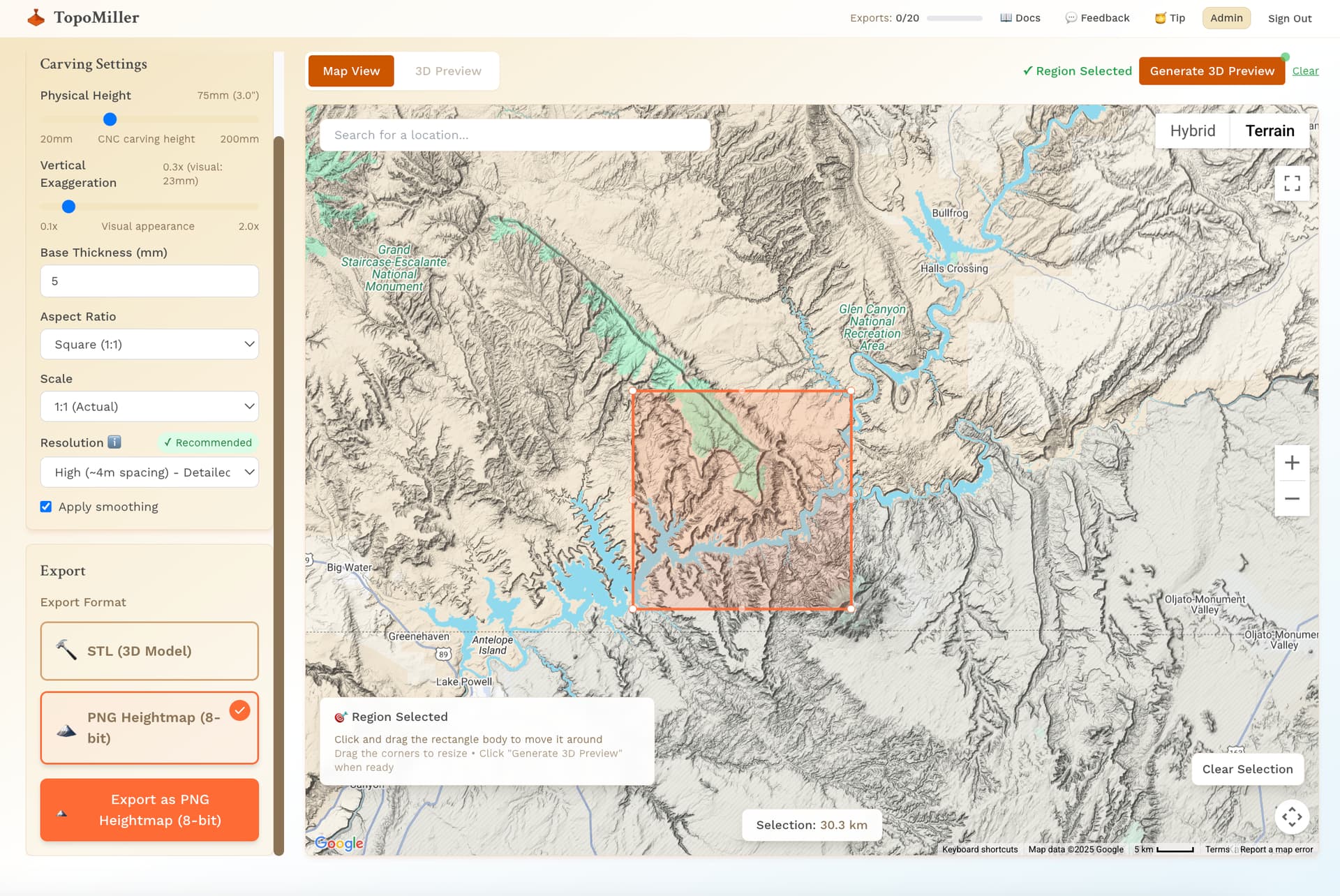

As someone who was really interested in topographic carvings, but didn’t want to be bothered to learn MicroDEM and stuff, this is awesome to see. I got two early thoughts:
  1. If you have an option to download a heightmap as a 16-bit PNG, that might reduce the file sizes people have to deal with if they have a suitable design program like Carbide Create Pro.
  2. If you can bring in boundary data (state/county outlines) this would be pretty dang powerful. Heck, if you get to the level of being able to offer a PNG + vectors for rivers/roads so I could overlay them in Create, I could see myself paying a couple bucks for credits to use this app.

Thanks so much for this feedback. If I am remembering correctly, it was one of your 3D Topographical carvings on the Youtube channel that actually inspired me. It is an honor to have you comment here.
To number 1 & 2. Yes, these are on our feature lists FOR SURE. Hopefully coming out sooner rather than later.

UPDATE:
You asked, we answered!
Per user feedback, TopoMiller now supports PNG heightmap exports in addition to STL exports. This is one small addition in a line of more changes to come.
Thanks everyone for your patience, feedback, and support… especially during these early stages of research and development.
