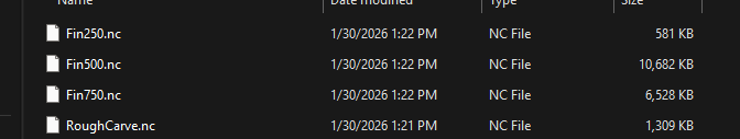

The smaller bits’ get a bit overwhelming for the PC because the REST mesh is HUGE ! I have 32 GB of memory ( and I have been whittling down the bloatware on the PC) and it still heavily uses the swap files.

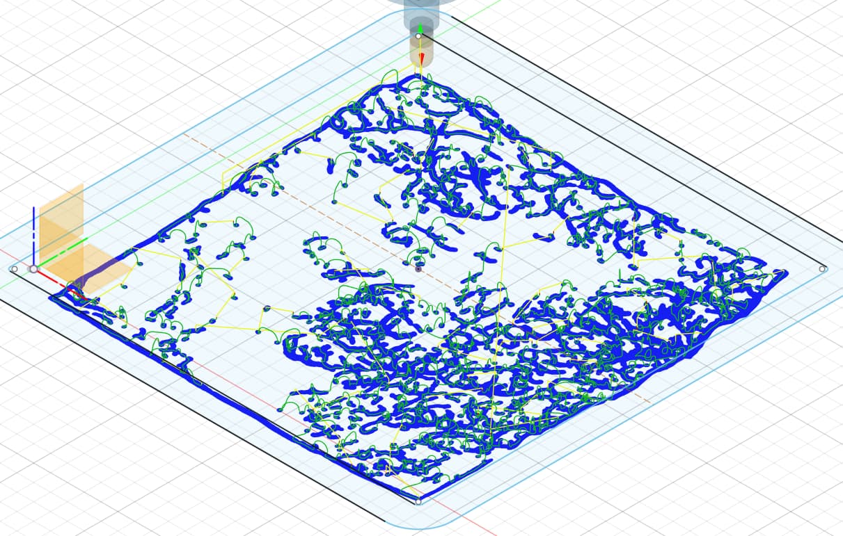

I start with a Pocket path leaving 0.010 stock.
This is the 3/4 path, full coverage

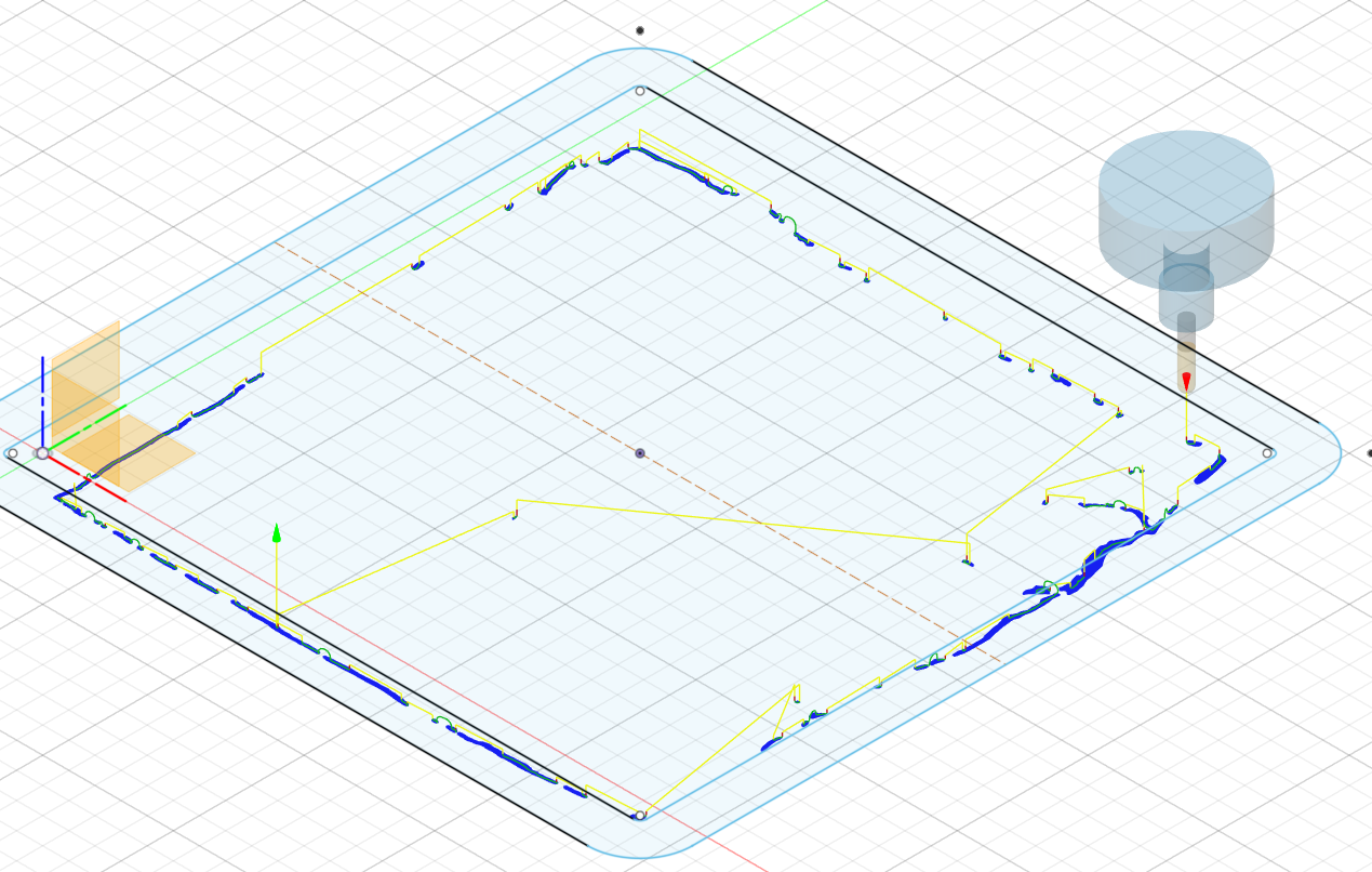

This is the 1/2 path.

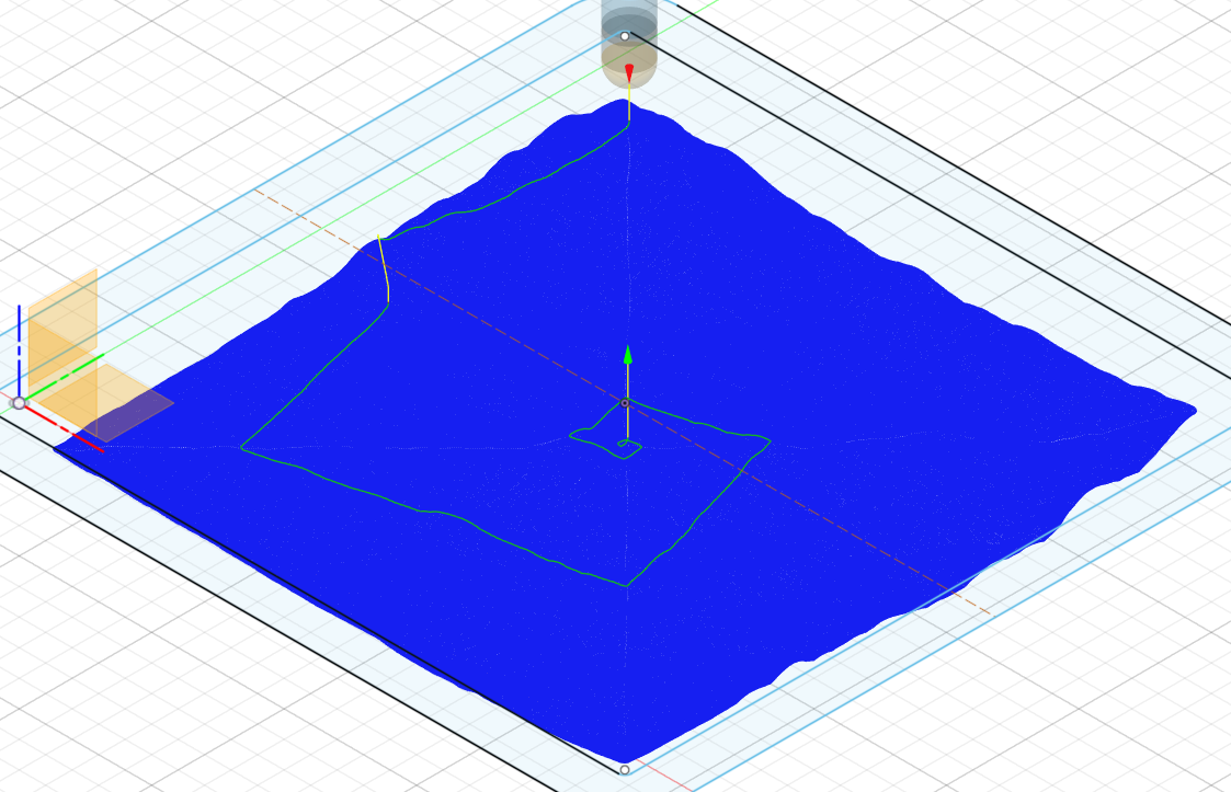

This is the 1/4 path. I had bumped up the cusp height to remove sporadic cuts.
The resulting tool paths are fairly small if your PC survives the calculations.
