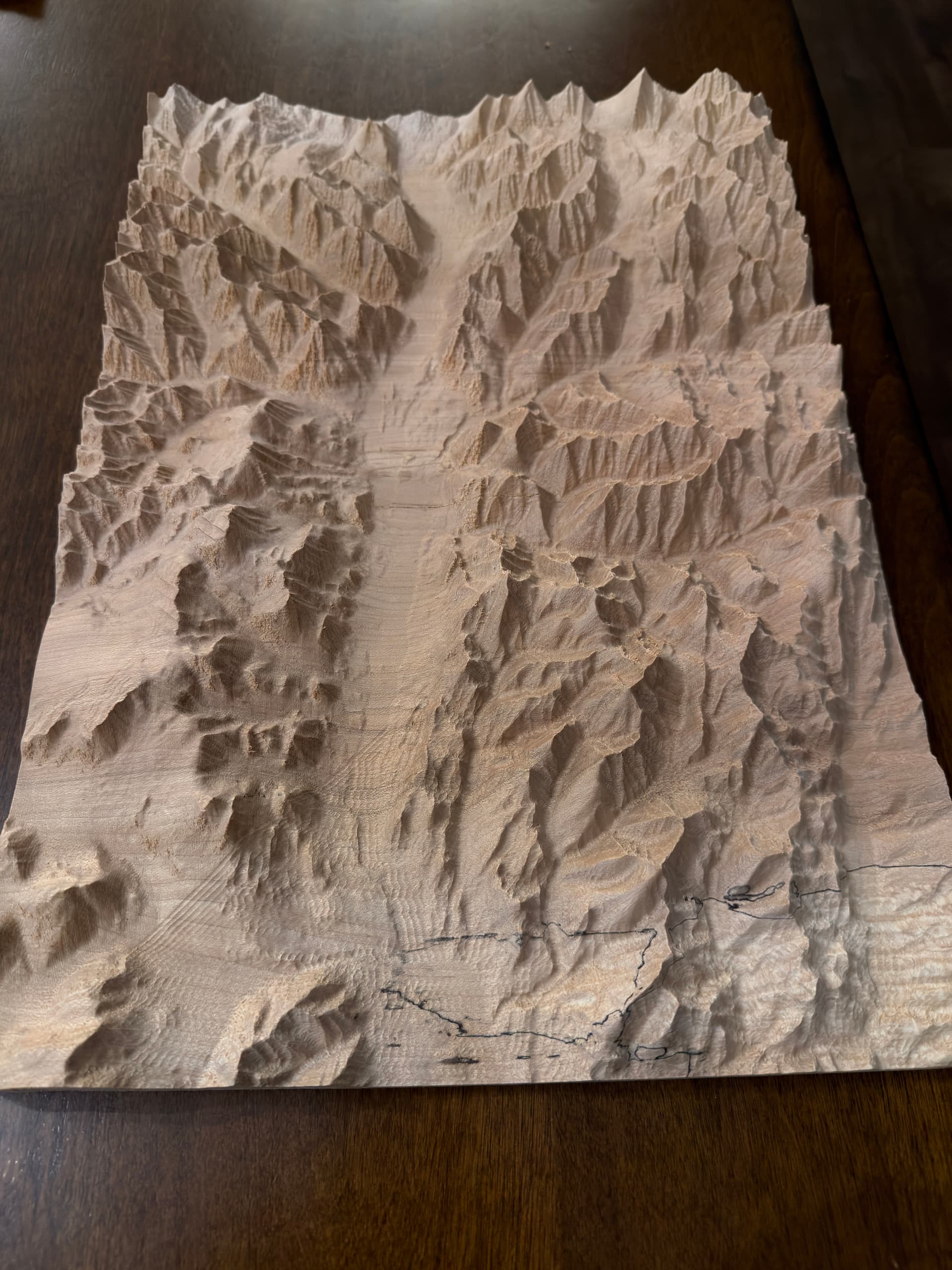

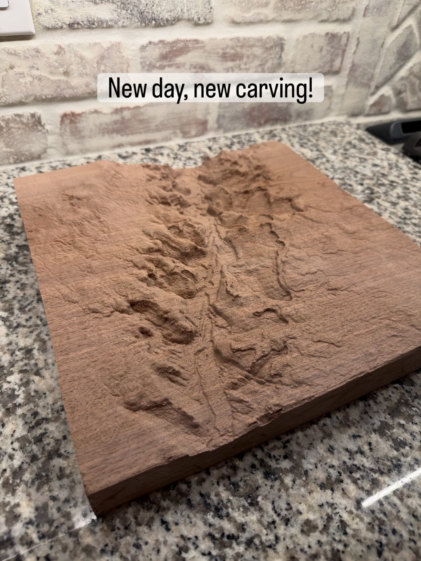

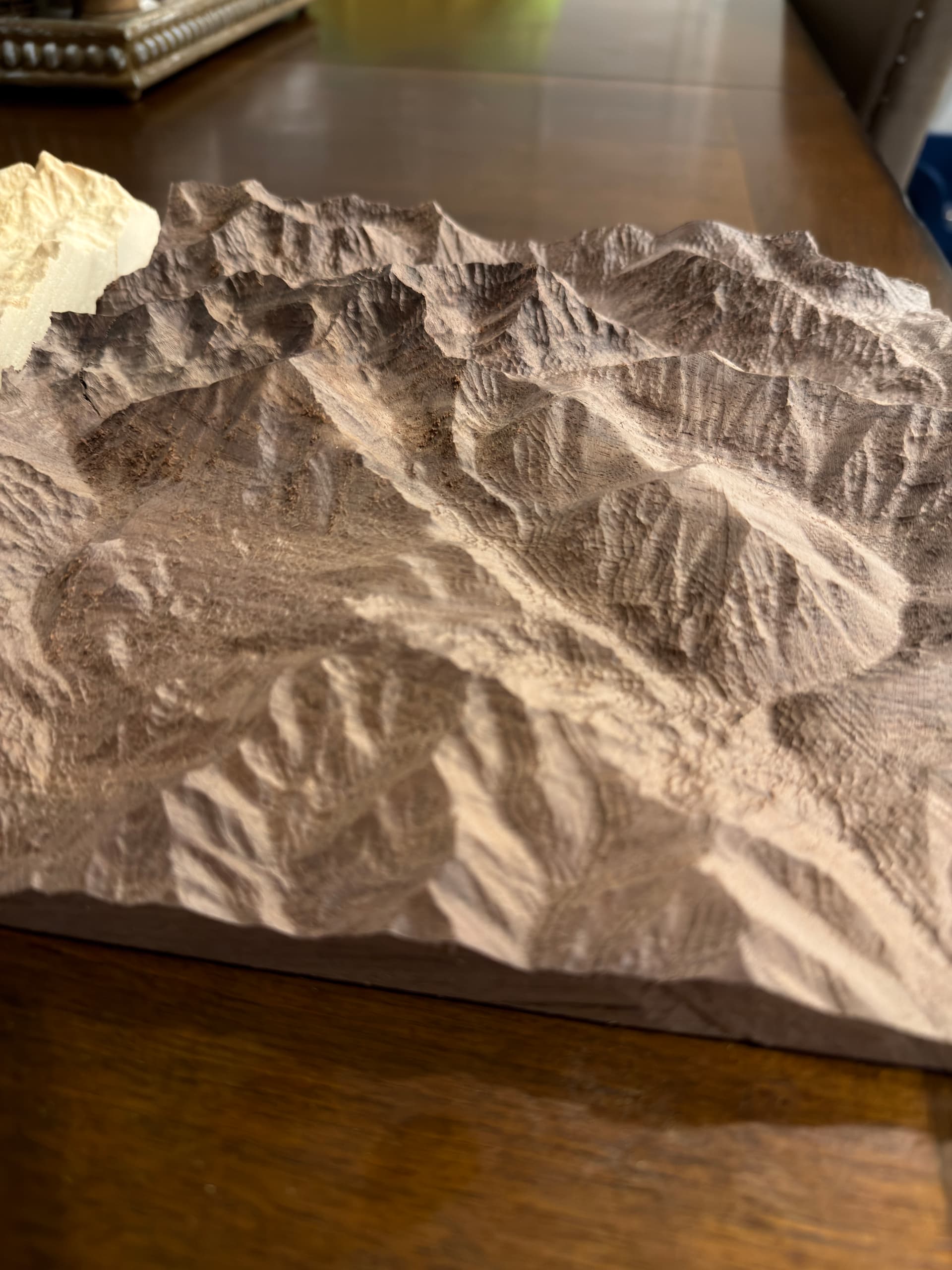

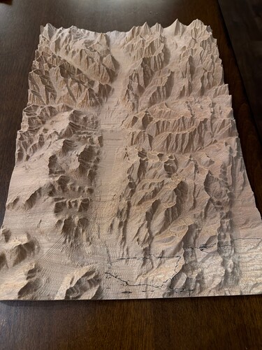

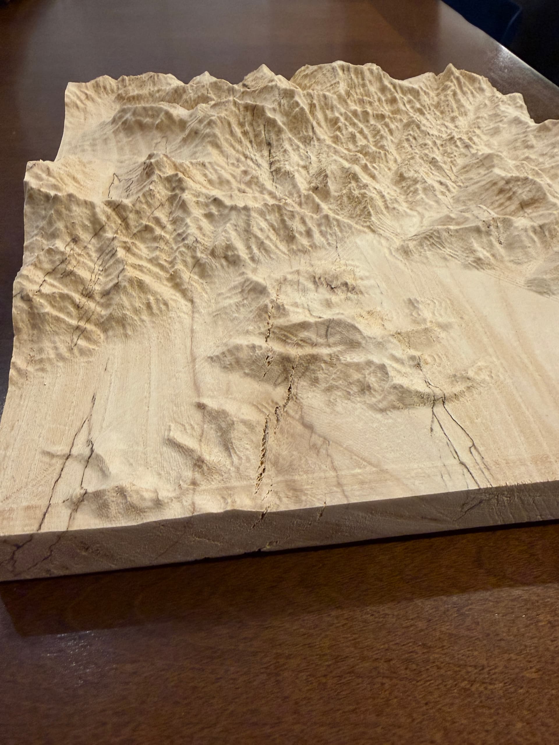

I have done a few as of late from Alaska, to Idaho and Mexico as well :

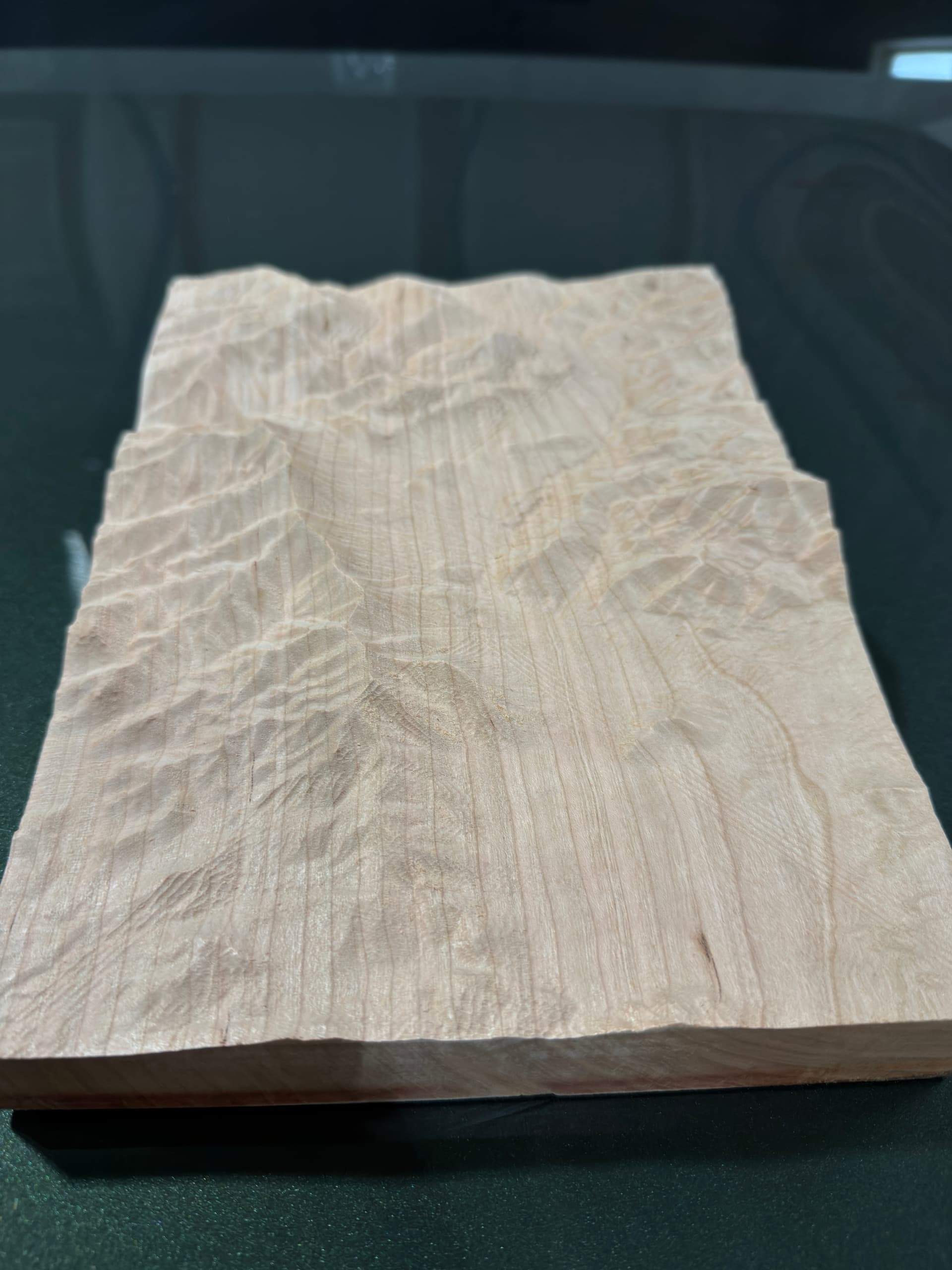

I am getting some tool marks, so I need to dial that in a bit more to see why that is happening. This is in vCarve Pro.
With regard to the tool marks, I have found that decreasing the stepover on the finishing pass is helpful. Makes the cut longer of course.
I’ve also heard of people doing a second finishing pass at a 90 degree offset, but I’ve never done that.

I found using a decreasing radii of round bits works very well. I start with 3/4 dia, 1/2, 1/4 etc with smallish stepovers.
The 3/4 bit cuts more than %50 of the finish surface. My tests have not needed 1/8 or below.
I am using Fusion with Scallop paths and REST machining. It is surprising how little is needed
for the smaller bits.
3/4 dia - Stepover 0.02
1/2 dia - Stepover 0.01
1/4 dia - Stepover 0.01

For this carve … approx 12" square.
I start with a Pocket path leaving 0.010 stock.
This is the 3/4 path, full coverage
This is the 1/2 path.
This is the 1/4 path. I had bumped up the cusp height to remove sporadic cuts.
The resulting tool paths are fairly small if your PC survives the calculations.

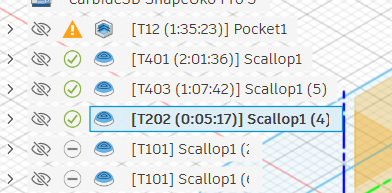

I’m not a Fusion user but I’m curious as to the total time it took to do your 12x12 piece.
Here are the times per Fusion. All paths were run around 50 ipm.
The Scallop path is fairly contiguous. I added Smoothing 0.001 which makes even longer and cleaner paths.
The actual runtimes are about %125 to %150 longer.
