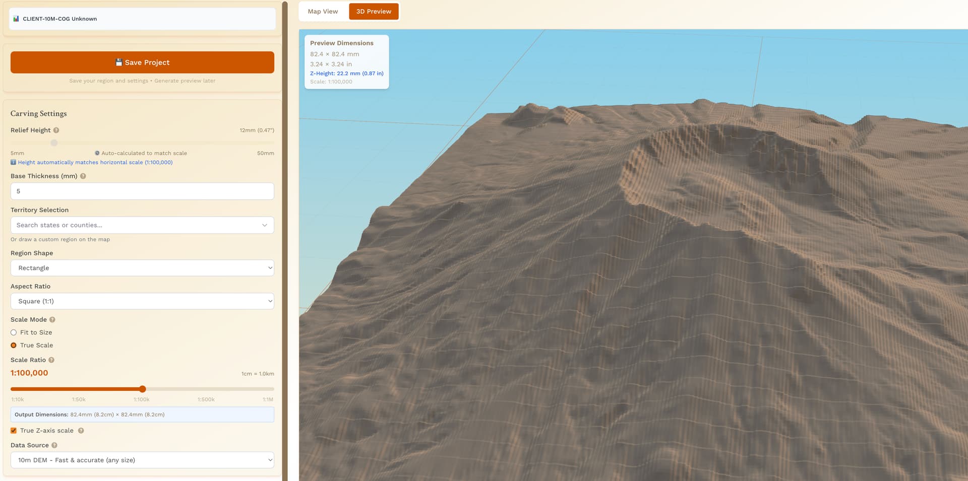

Thanks for pointing this out. I could be misunderstanding, but if you are referring to those grid lines, that happens when you:
a) select a region that does not have extremely high quality data like 1M data.
b) have selected a region small enough to have those grid lines.
It is the same effect as zooming in on an image enough so that you start to see the pixels.
If you were to select the same area, but select a larger region, those lines who not be recognizable.
I could be wrong in what you’re referring to.
Let me know and thanks for the feedback, everyone!
Also,
I need to look into why 1 meter data is not being pulled in when it should be!
Those lines show up irregardless in that area for me @mlembke1
Maybe you are saying pick a larger area and then just cut to the area I want? The only reason I am trying to get the detail is because it is a memory for a friend for backcountry hiking. The more I select, the less apparent it is for them.
Are there any post processing tricks I can do to remove the lines after the fact?

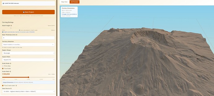

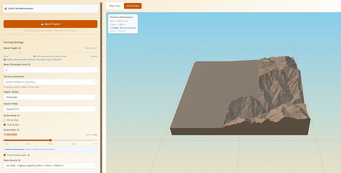

Anytime you see that jagged mesh in the rendering, it’s indicative of the 10m source data. You can see it in these two screenshots, exact same area, just 1m vs 10m. I’ve done more poking around the map in random places where there should be 1m coverage and sometimes the page just doesn’t render 1m data (based on 3D render and data source indicated on the webpage), or it renders incomplete data like the third image.

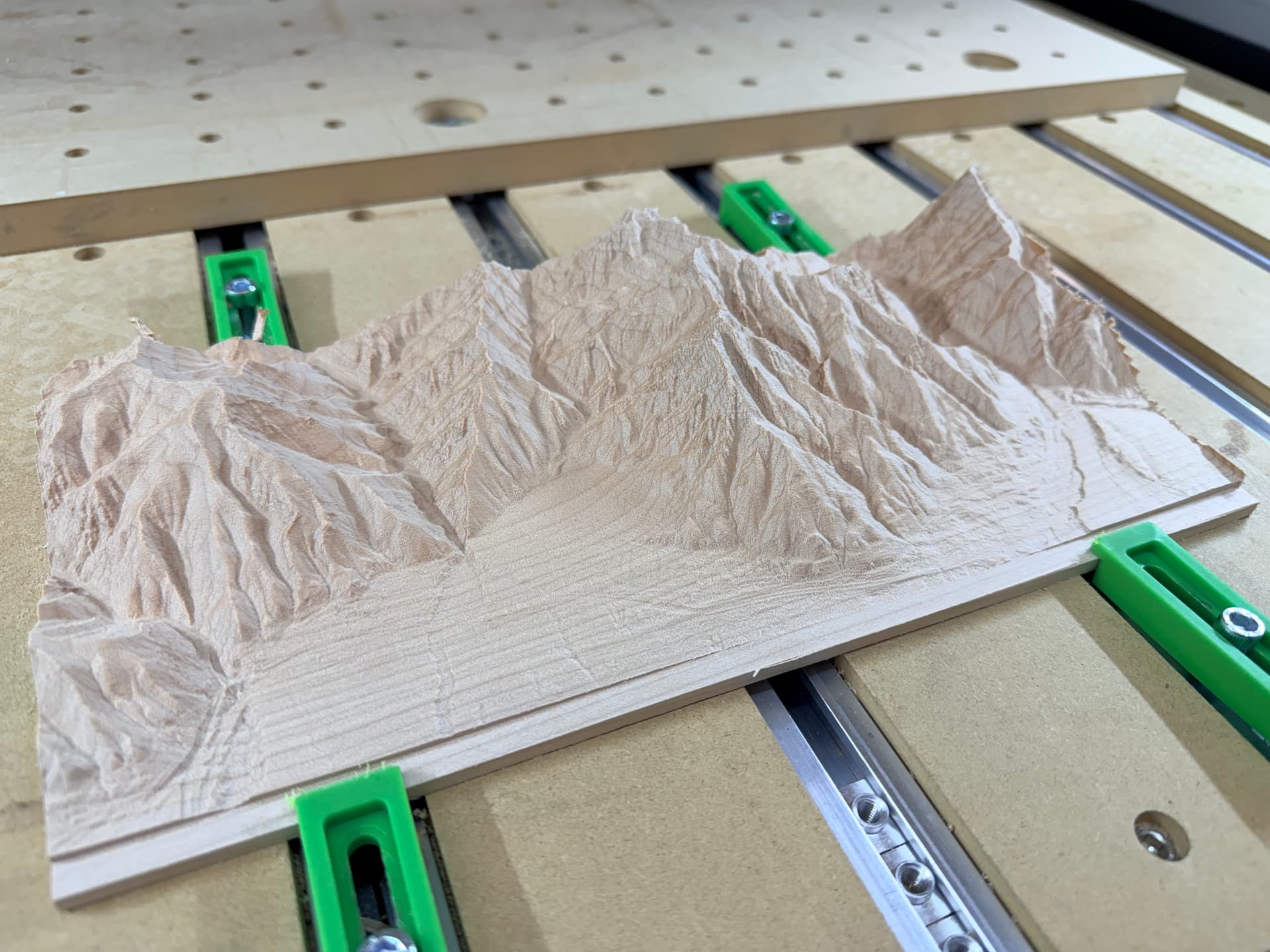

Did a new export on the new 1m data and it turned out fantastic. I was never able to get this region to correctly render in the old code/data.
1/16" ball mill in maple.
Looks great ! What tool path did you use ?
That was a good chuck of wood !
I used the conventional 3D rough and 3D finish to do the topographic removal. I used a contour path to give myself the lip on the front and back to grab with the clamps. I’ve noticed that when I mill down these 8/4 pieces of maple they tend to curl a bit due to the material removal.
While it does take longer, I actually run 2 3D finish passes, each 90 degree offset from each other. The first will often leave little fuzzies on the wood and running it 90 degree offset will clean everything up really nice.
I can believe the wood is moving. I had to mill the same outer shelf to keep the piece in place.
Try de-waxed shellac between cuts, makes the fuzzies easier to cut.
