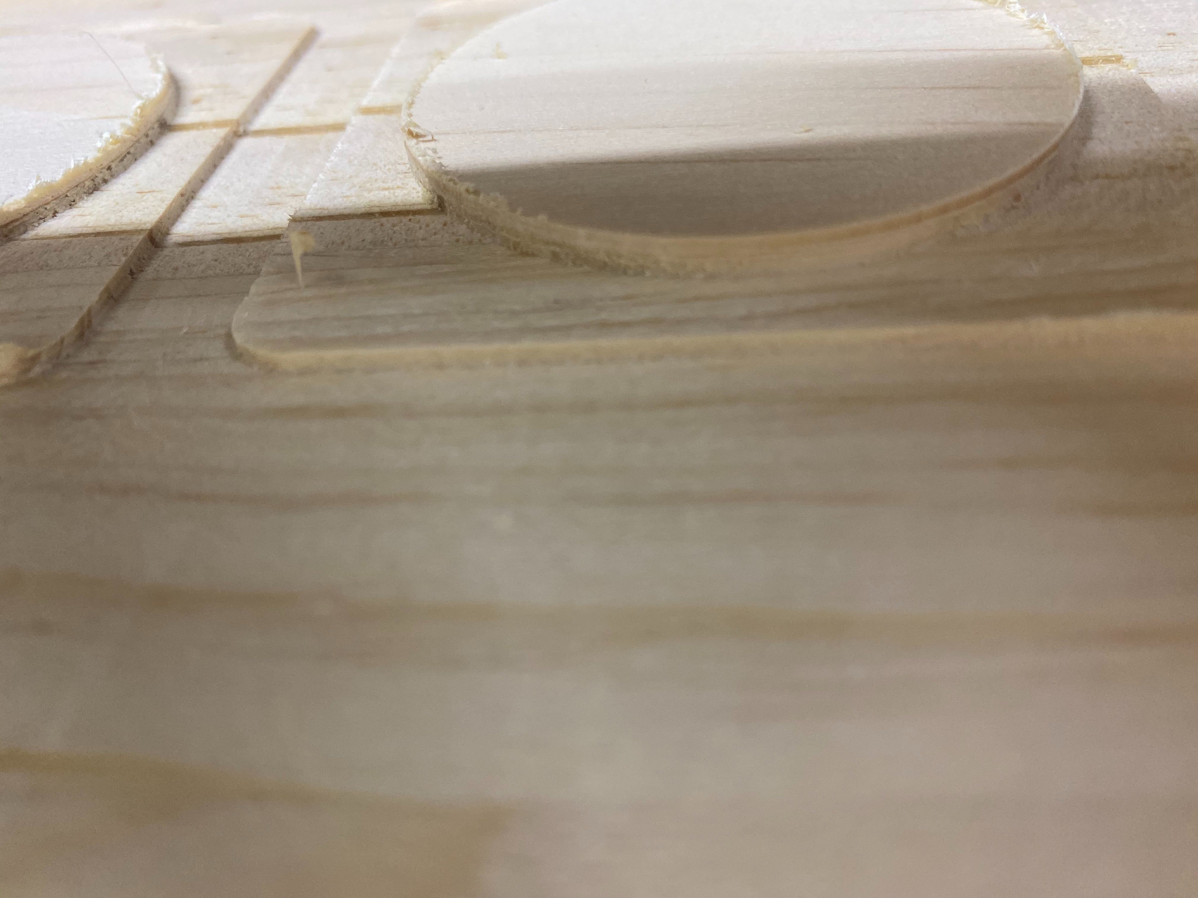

@neilferreri I just came down to check and it’s gotta be pushing a full 1/4" deep. Which is twice the depth I set. Stock is a full inch thick. Same as the last few.
@fenrus Nothing “crashed” that I’m aware of. Just suddenly started cutting way deeper than it should. All seems very controlled. Everything looks great, not sloppy or janky looking. Just a ton deeper than I wanted.
I’ll check the Z carriage and belts when this leg of the carve finishes.

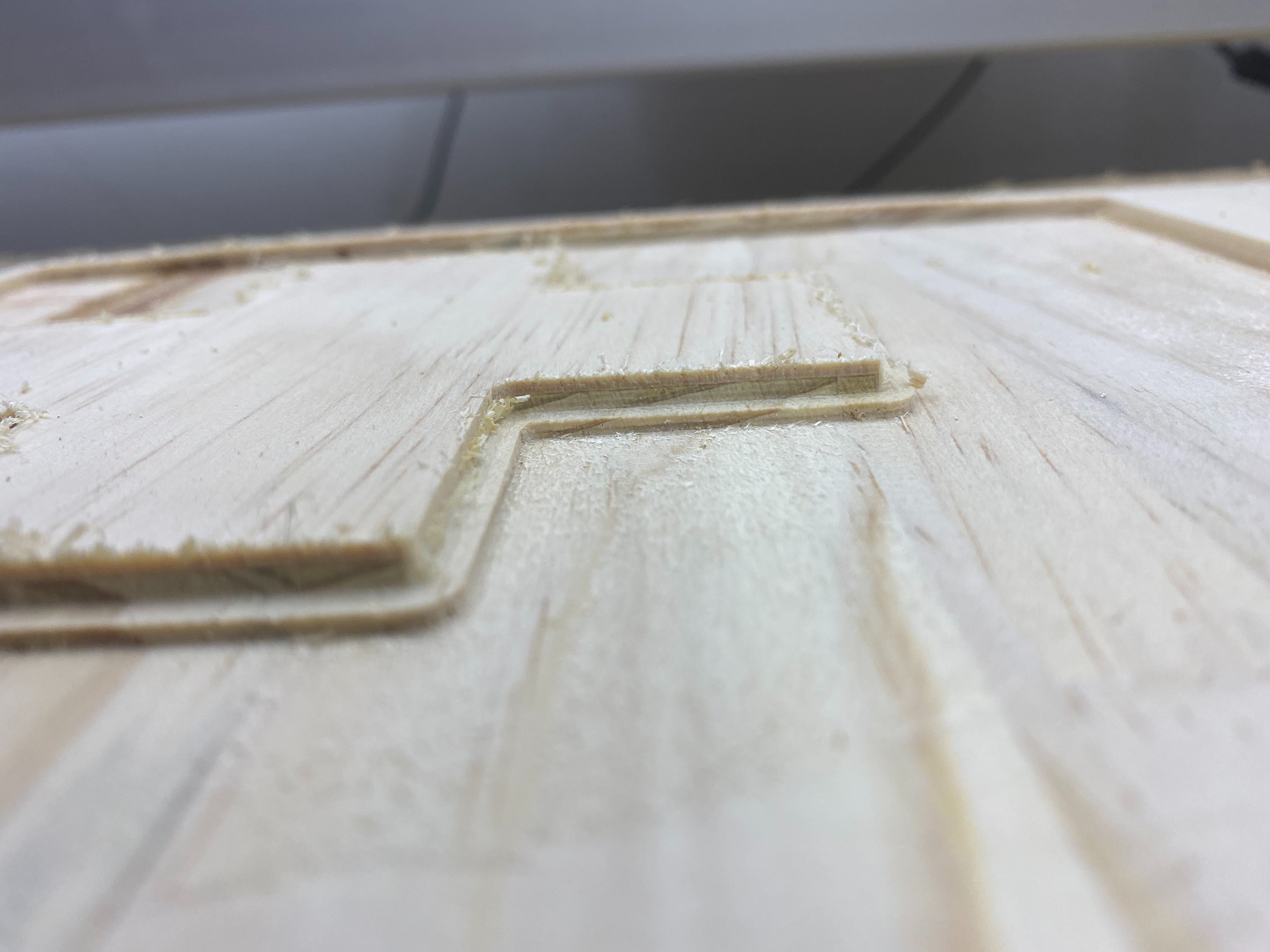

Ok, the 1/8" end mill carves are all done.
The max I had set was .125" and the final max depth according to my digital calipers is .1685".
BUT!
I only set two depths. Deepest is .125" and the other is half that, at .063". You can see that the distance from the top of the lower carve is correct, and it’s just the upper portion that’s too deep.
The zeroing seems to be the issue, as it appears the issues takes place during the initial plunge only.
Question is… how do I fix it? Cause, I’m not going to lie to you, I’m not exactly a pro at this. I’ve only had this machine for a couple months. And, it’s my first CNC.
