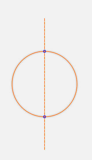

I’m trying to create an open-sided half circle. Typically I will create a circle, then a straight line, select both, trim vectors option, click the side of the circle to delete, it’s gone and then I delete the line (happy dance).
Whenever I’ve tried to do this recently, when I’m in the trim vector action it won’t delete the half circle. When I hover over the side I’m trying to delete the whole circle ‘illuminates’ (the grey shadow that indicates what will be selected if clicked).
I can trim the ends of the line, but not either side of the circle. It doesn’t matter which element I select first and has the solid or dashed line.

I created a circle and line and experienced what you did.
Then I resized the circle…just a bit…and then it worked.
It must be something about the circle not being an acceptable object type. I’m sure @WillAdams will know immediately.

After I resized the circle with the manual drag control I was able to trim the vectors I wanted.
I tried just adjusting the radius to a new size and then back to the size I want, but that was not enough to trigger the change.
Thanks @GJM at least I can move forward now with this workaround.
The problem here seems to be that the algorithm for detecting segments gets confused by coincidental nodes.
There’s definitely a nuance in Gary’s workaround; the drag and ‘snap-to’ sizing changes are not enough to make the segments identifiable - it needs to be made with the dynamic or smooth resizing.
