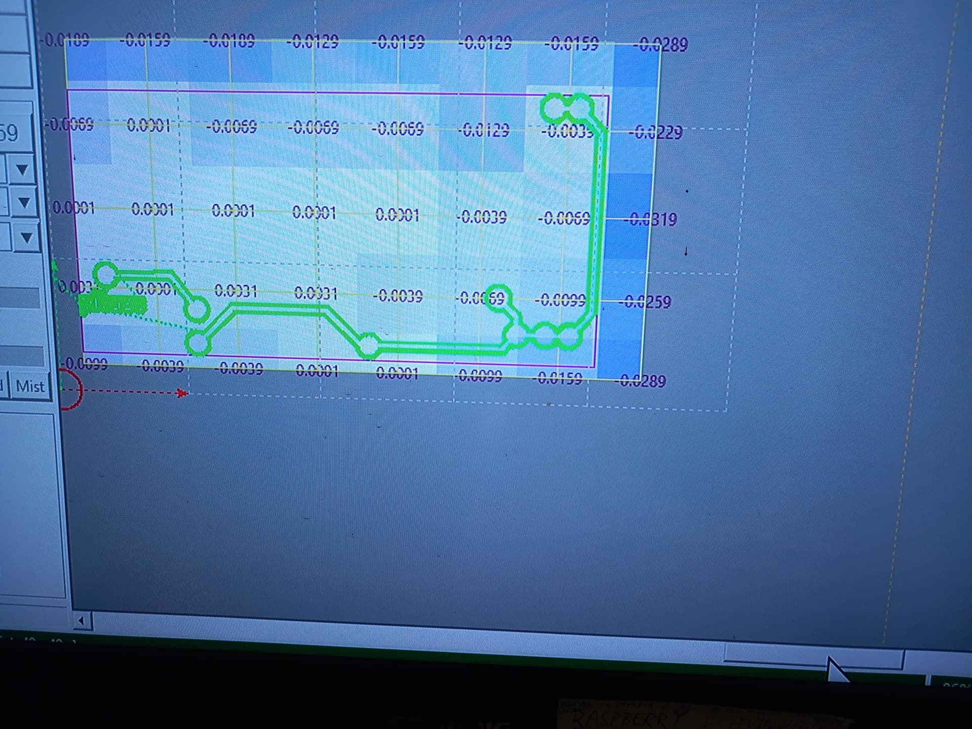

Stumbled accross similar issue w bCNC and sporadic but repeating hard reset. The sectet i was able to investigate calles me reckon single usb port to your mill. As soon i plug usb hub in or point a mouse in the workspacei get sooner or latersame an error. Anyone feel free t
o confirm. Cheers and happy milling and inventing, yeah job complete! Heeha! Finally
