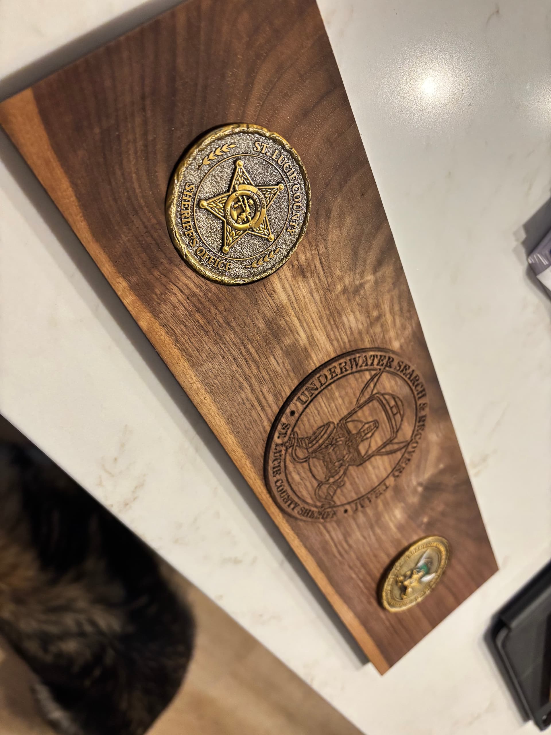

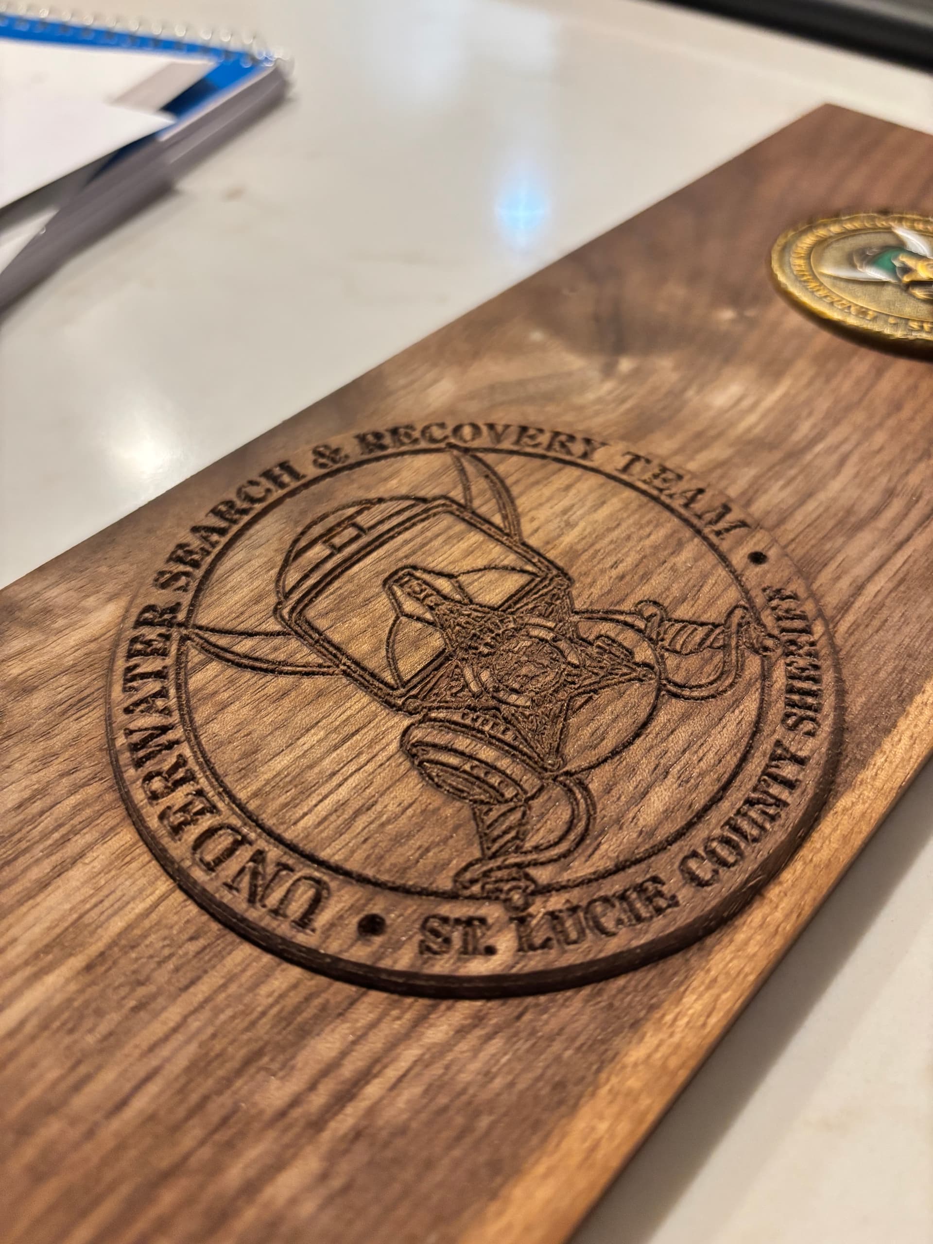

This came out great with all the hep provided. SDGuy, I would love to know how you got the final file right. I am still learning.
This will go on a perpetual plaque for all current and prior Dive team members. I will post some pictures when it’s done.
Thanks again!
