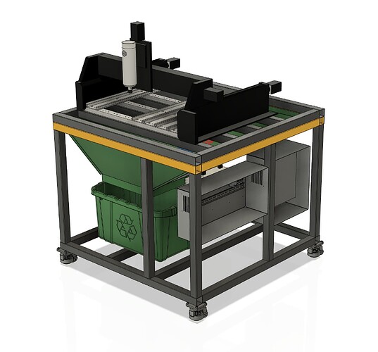

After looking at the physical frame and thinking more about the design, I decided to go way back to an earlier design iteration and include a top frame for the base frame for the enclosure. This necessitated rebuilding the hopper, which is fun with lofts. sigh.
But, this will be easier. Better, perhaps. New part is in yellow.
