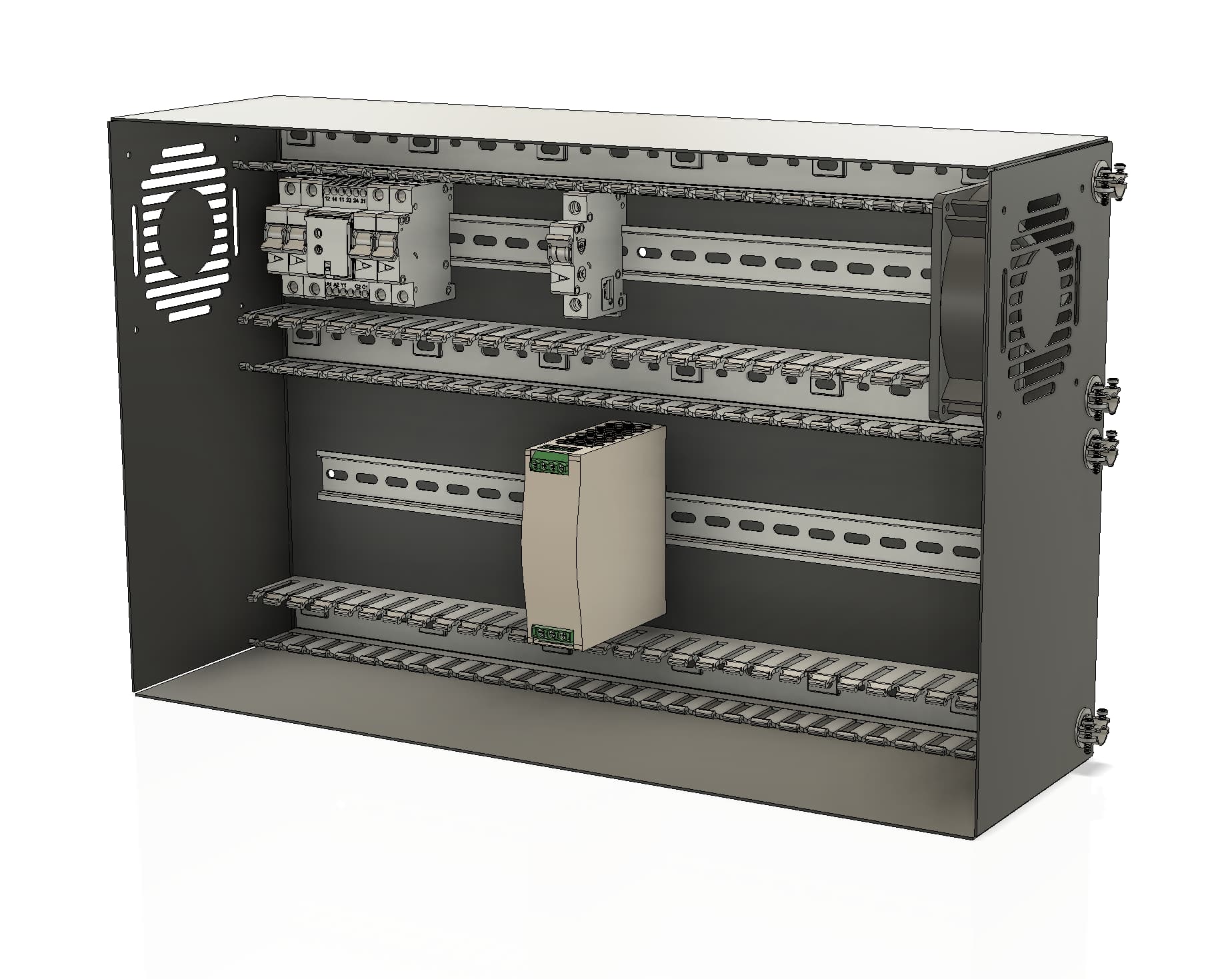

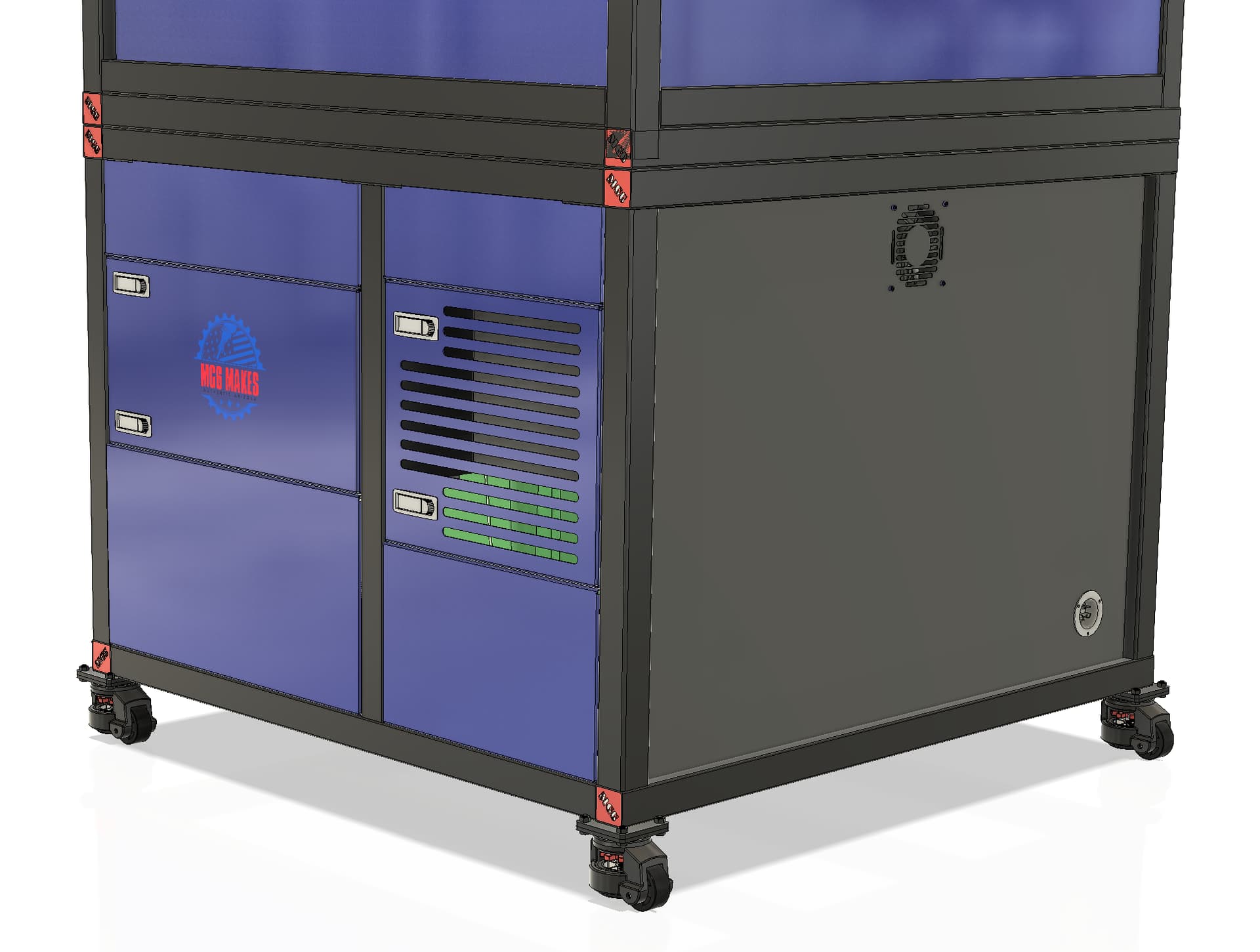

Talked to the boss. I’m not going to stop setting up the HDM. Kills me to have thousands sitting the shop not getting used. I started accurizing the body panels against the actual frame as fabricated. Back panel is done.
Next, I’m going to start designing the electronics, then the right side panels.
- Running 20A of 220v power through the female port to a bus bar where it will be distributed from the secondary electronics cabinet. I calculated that there should be plenty of amps left. If not enough, the cable I made is suitable for 40A, so I put a bigger breaker and pray on the recepts.
- 12V distribution for fans, SST lube, LEDs, other devices.
- 20A 220V internal recep for warthog
- Rewire/extend the bitsetter and bitzero wires so they can be run properly out of the way over/under the frame.
- breakers. lots of breakers and fuses on DIN rail
- Relays for turning stuff on and off
- other stuff TBD
30A 208/220v in. 30A breaker. GFCI breaker. 20A Warthog breaker. 20A recep breaker (chiller/other).
Will add the rest tomorrow. I had to make the box bigger to fit the Meanwell 12V power supply on the bottom rail.

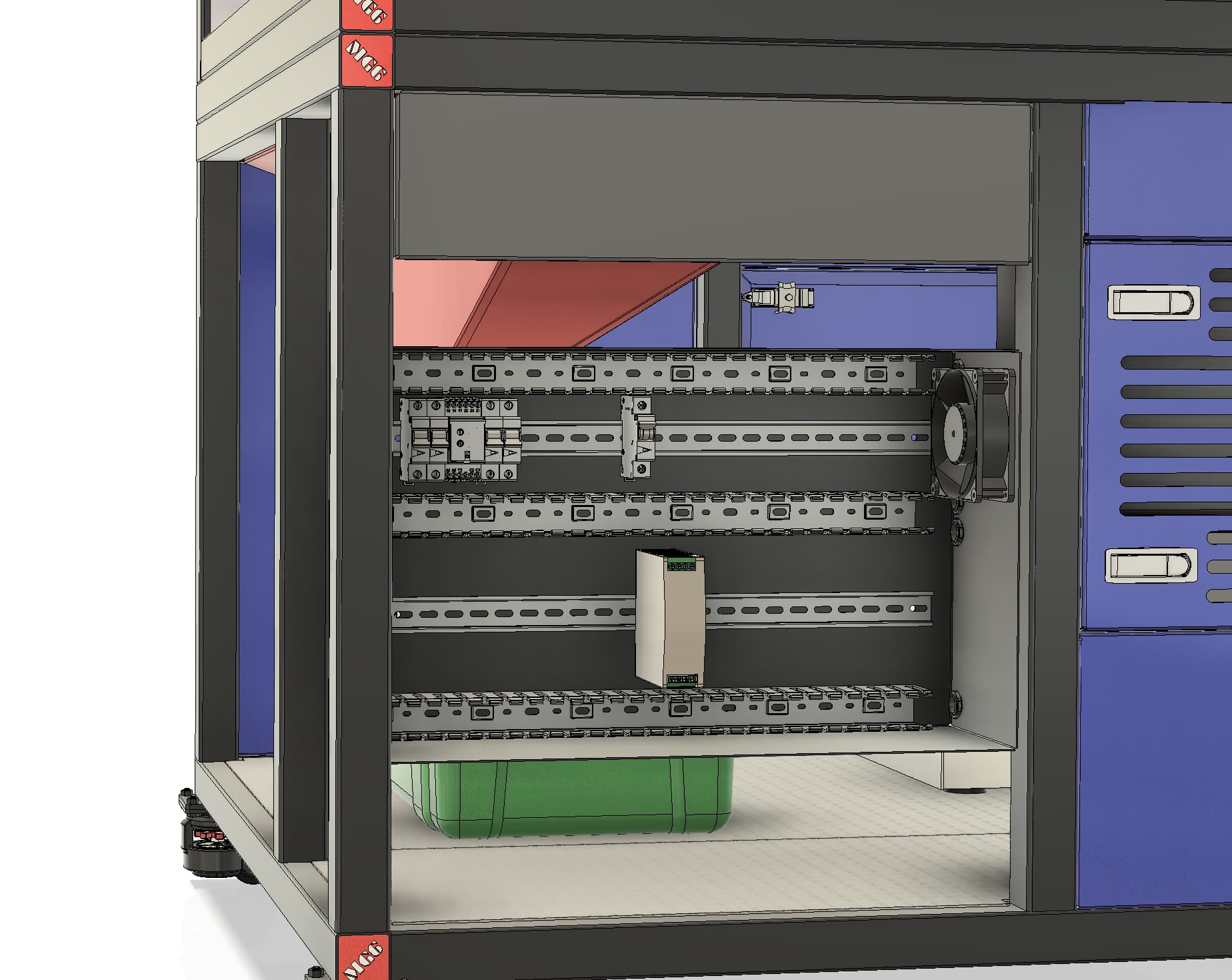

Need to adjust the size of the panel. I made the hopper inside-out from the design, so it drops on the right side IRL, not the left. This means I have to move the secondary electronics box down to avoid intersection with the hopper.
