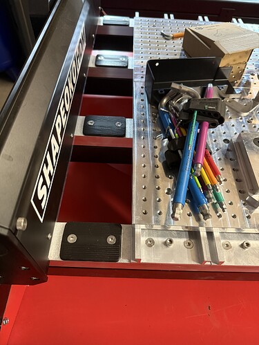

been busy with work, buy got these done a few weeks ago.
Well, I got work to do on the bed.
Must have done something wrong along the way. :rofl:

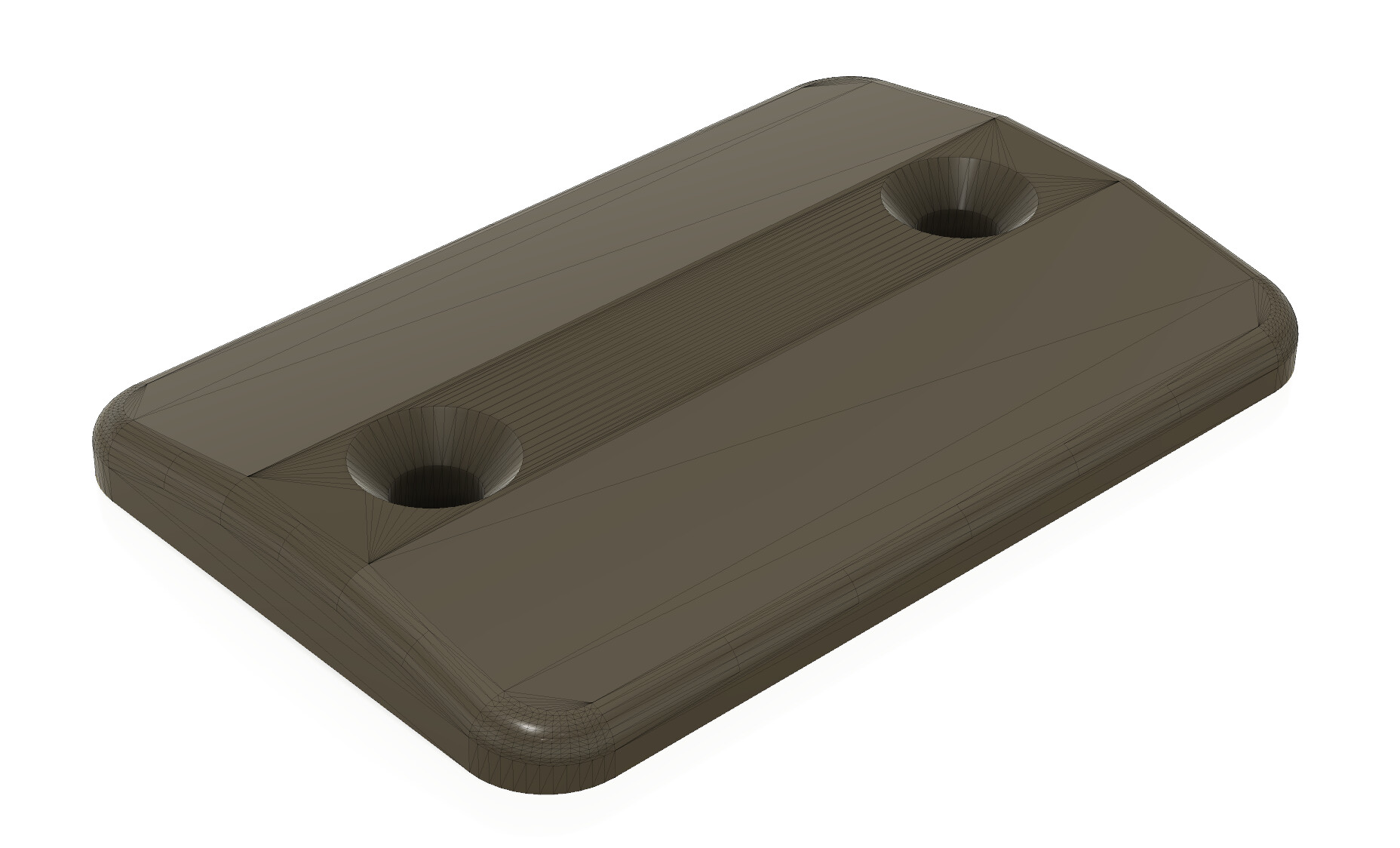

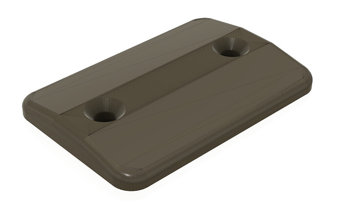

Anyone have a +12x4" format 3DP interested in printing this for me for $40 shipped to 85383? My Bambu X1C canno do this. I want the wide format so it can sit on my enclosure in my preferred location.
Community gift, I can’t print this one anyway. I made a smaller one. I could have sworn my X1C could print 12". What’s 2" between friends anyway…

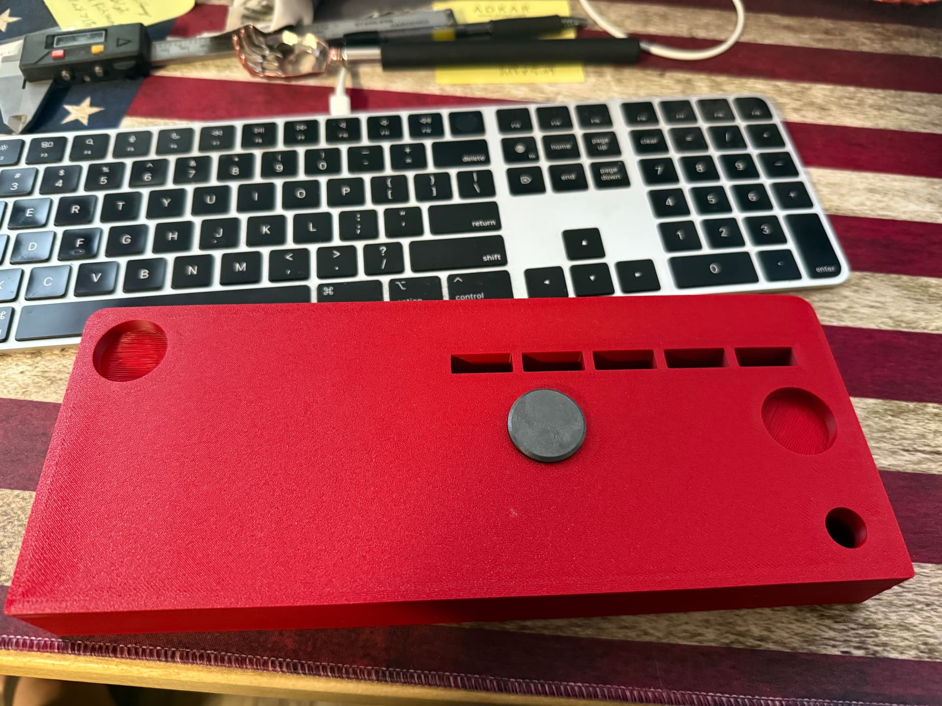

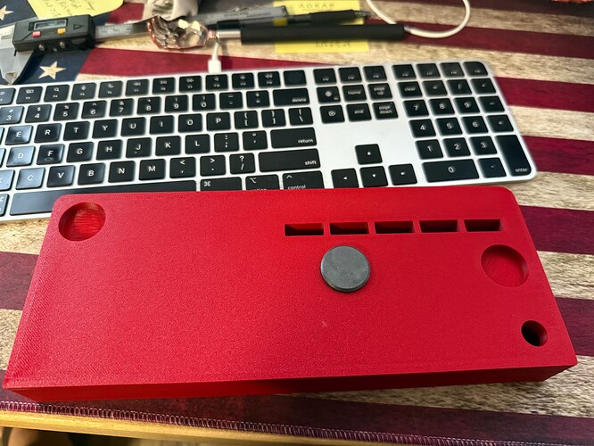

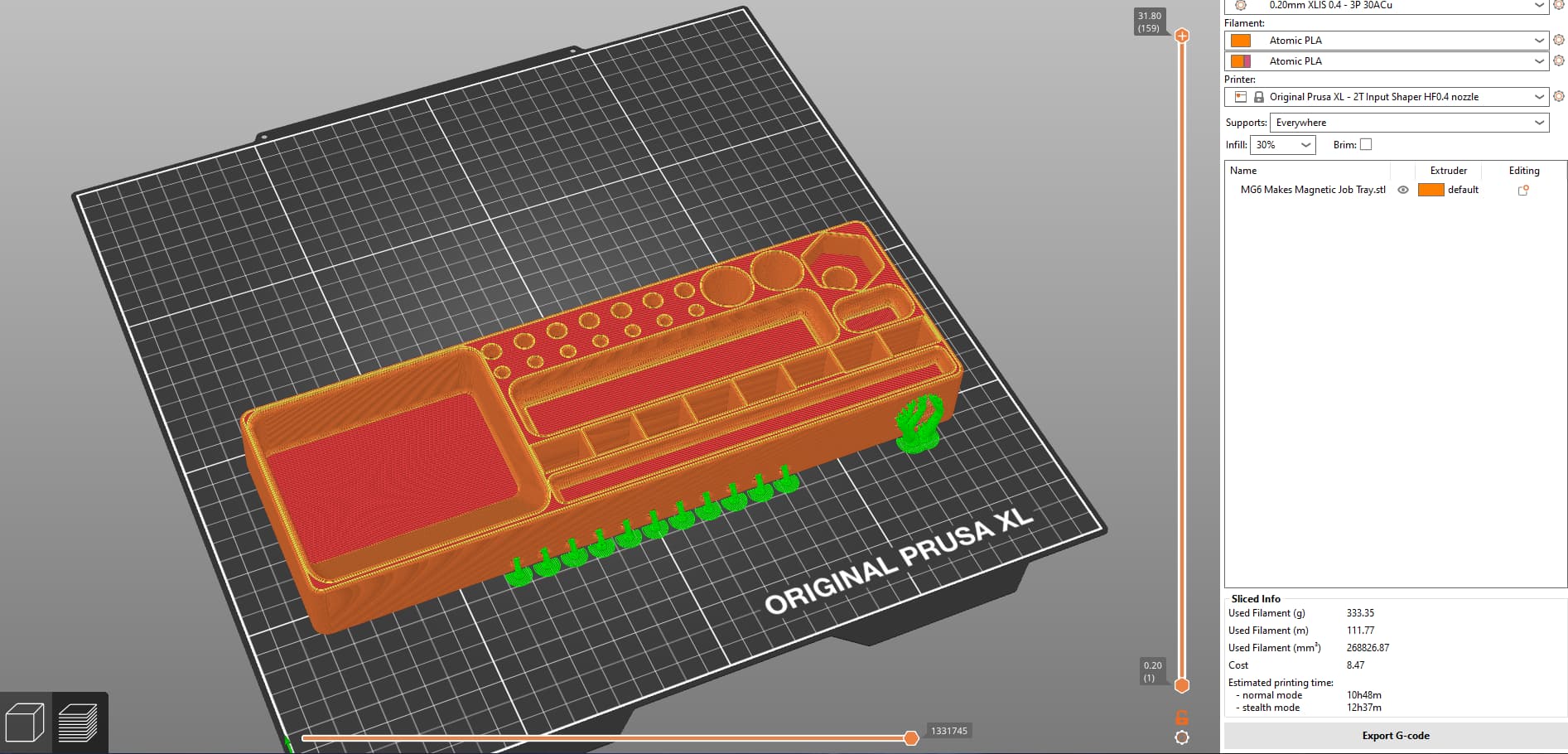

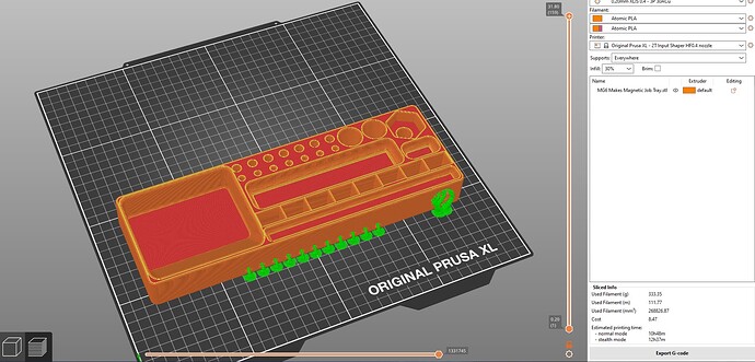

MG6 Makes Magnetic Job Tray v2.stl (3.5 MB)
10W" x 4D" x 1.25T". Has holes in the bottom for magnets. The holes in the front are for ¼"-20 bolts.
Only about 11 hours. 3 perimeters, 6 top and bottom layers, 30% adaptive cubic infill.

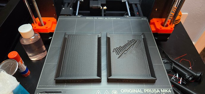

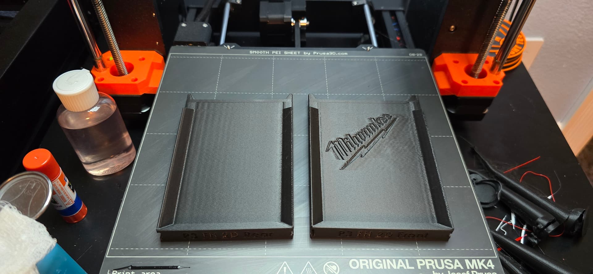

The Milwaukee logo is wonky because my filament was too hot. I had the wrong settings for that filament.

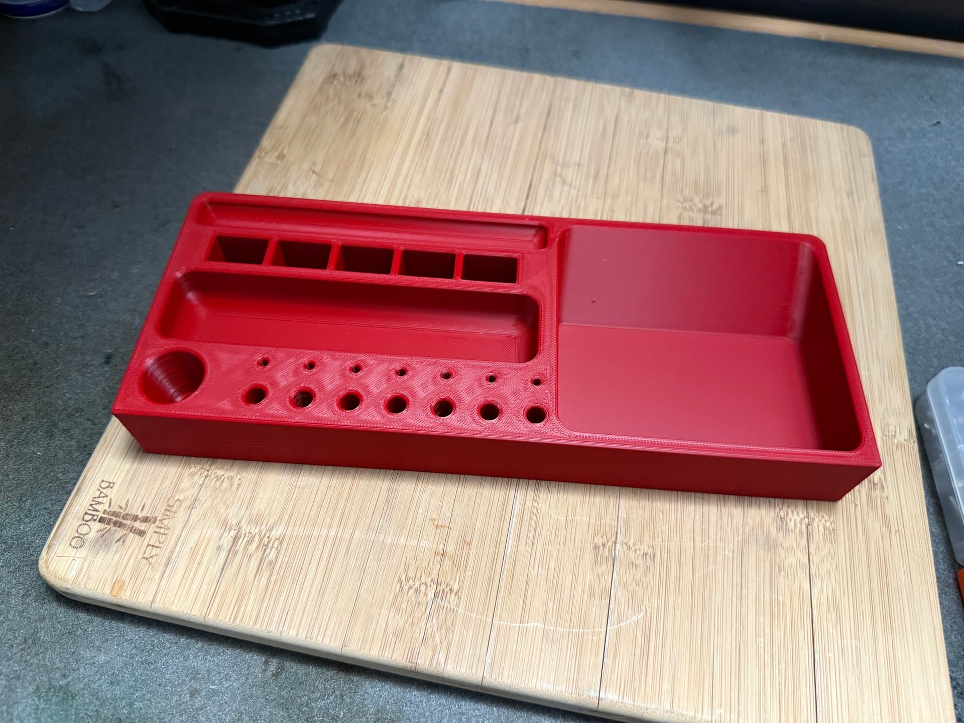

Go for it I’m not picky on the tool tray. @MadHatter I need to post a new file, I saw a defect on that one for a fillet.
Okay. I’m headed to bed now. I’ll download the new model and start it tomorrow when I get home.
That was a long print. Some ringing on the Bambu that I normally don’t get.

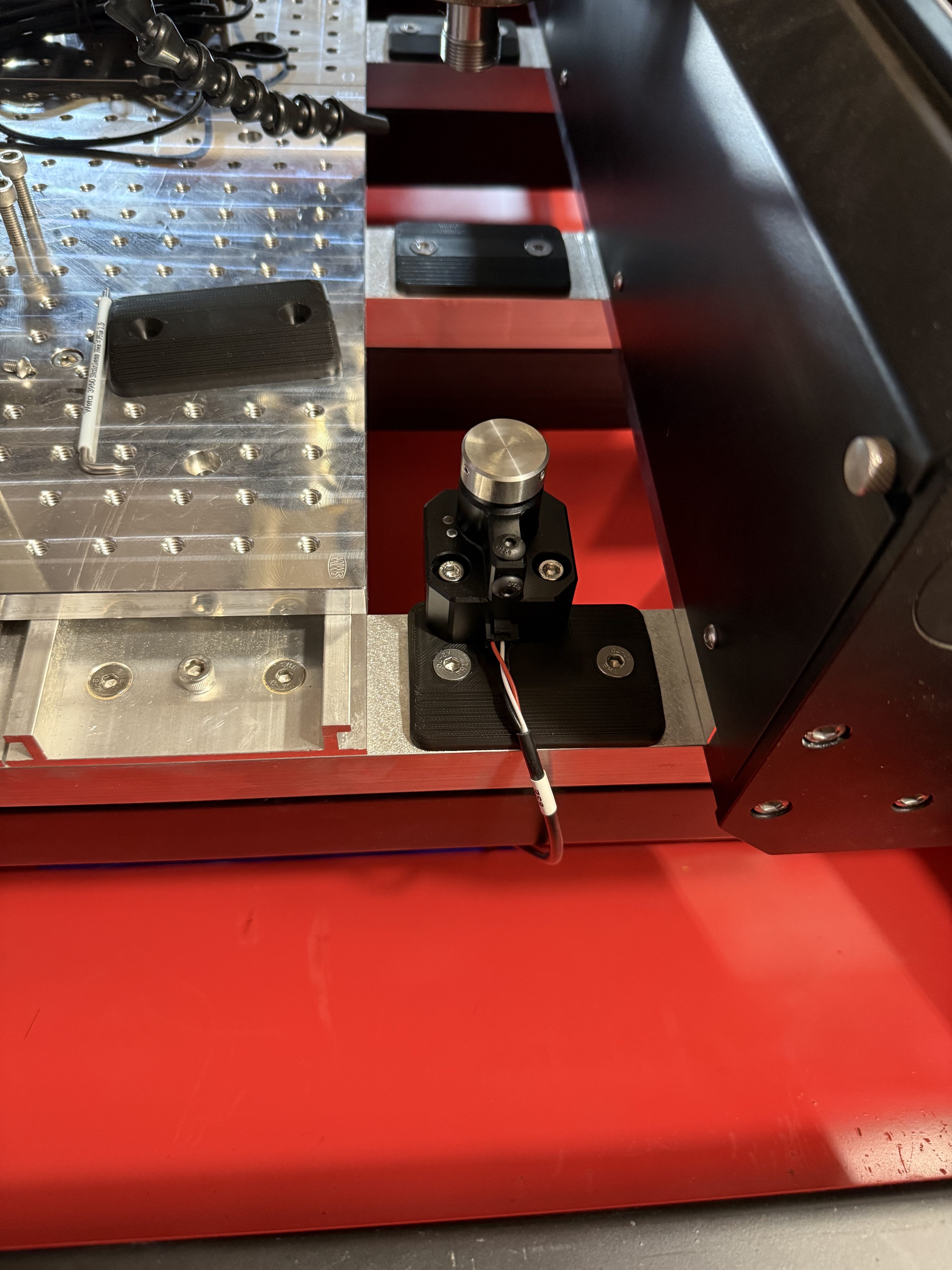

Anyone from Carbide3D that can tell me whether extending the BitZero and Bitsetter connection cables with a JST 3pin up to 48" will cause any issues?
I need the extended length to make clean cable runs in the Ultimate HDM Enclosure to the warthog electronics/vfd box as pictured above.
TIA
@WillAdams
I found another post wrt: https://www.automationdirect.com/adc/shopping/catalog/bulk_wire_-a-_cable/600v_control_cable/automation/cf6-07-04-1
What type are the connectors? PH/XH/PA/EH? They don’t look like SM, close though.
