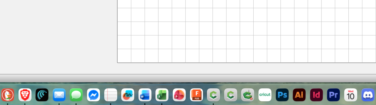

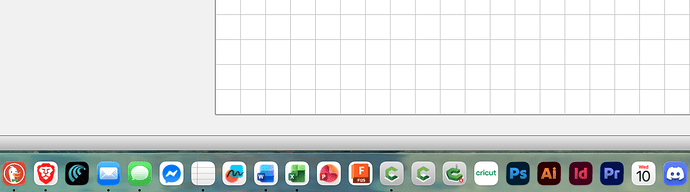

If something doesn’t open in V8, I pop open the CC V7 app in Applications, it’s too confusing to have it in my Doc, though you very well could have V7 V8 and Motion all in order left to right, and then in your mind, realize if you’re trying to open an older folder, try the one in the middle first. If you get the err message, close V8, and drop the file into V7, and you should be golden.
(In the attached screenshot, I’ve set the files up in this config.)
