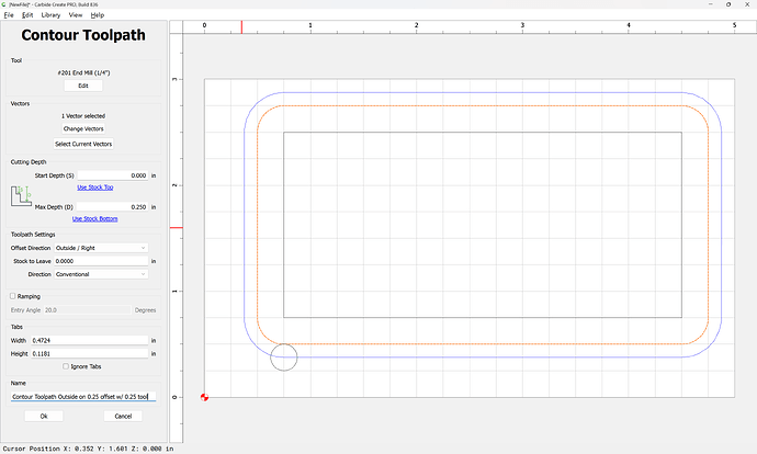

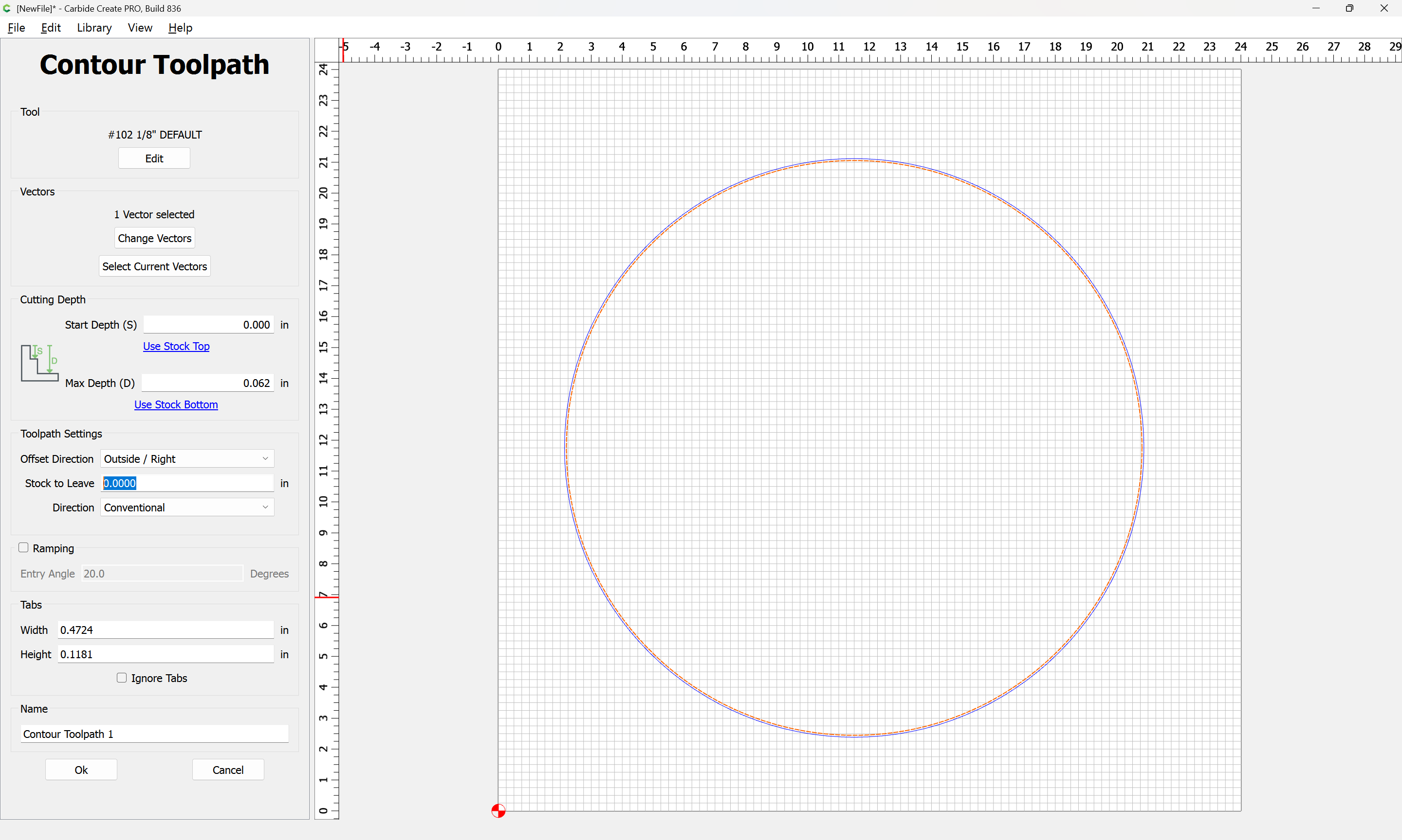

Stock to leave allows you increase or decrease the offset.
So rather than doing math & offsetting the curve, make the tool the diameter of the tool tip, and use Stock to leave move it away from the edge 0.005 - 0.010”. Then make the depth the height of the cutting edge - your small offset
If you have Pro, then there is a control for this for Contour toolpaths “Stock to Leave”

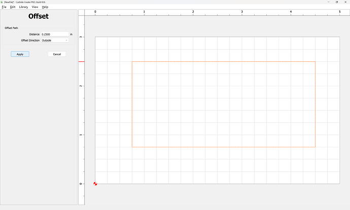

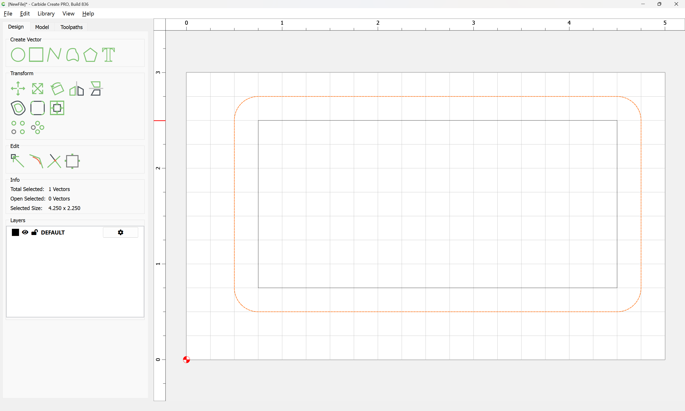

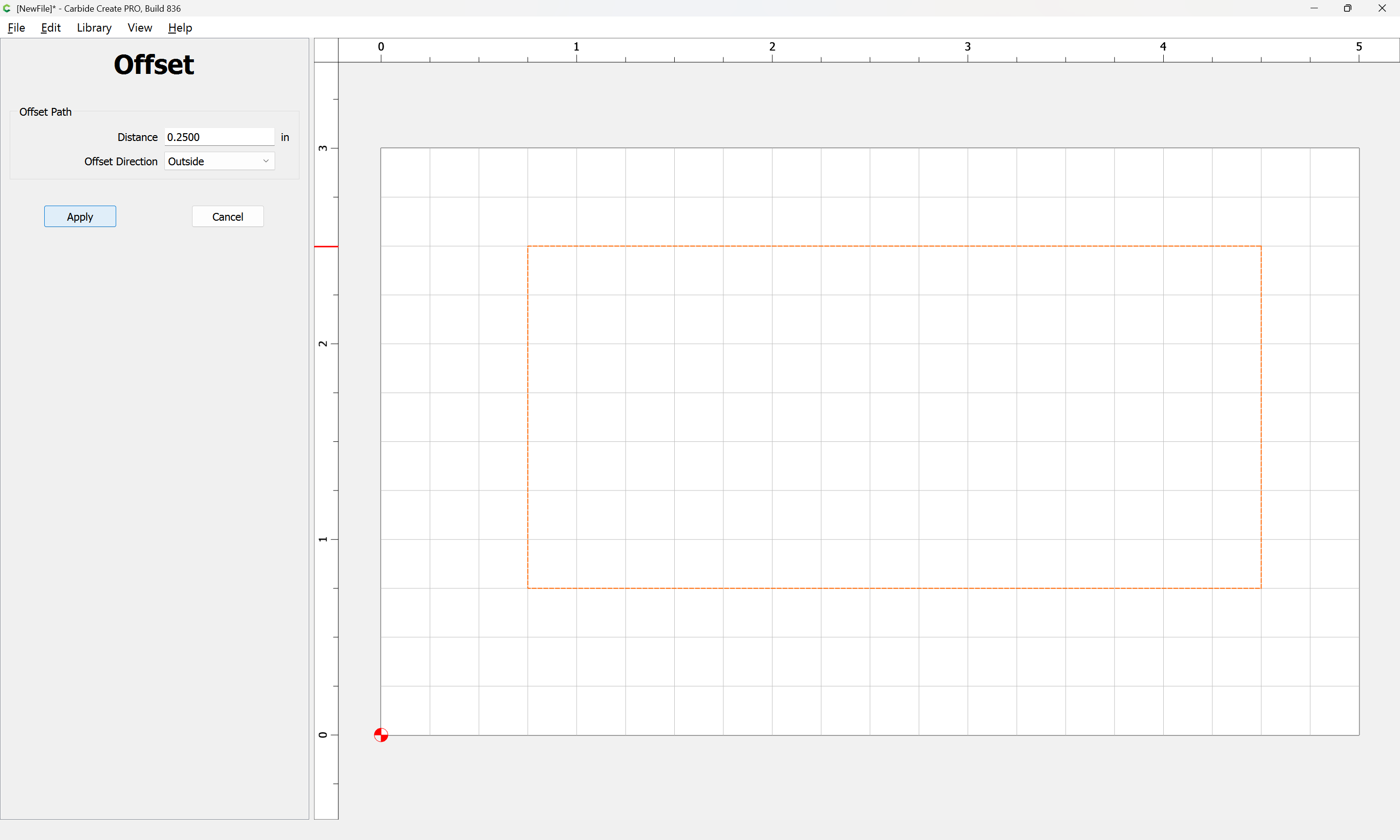

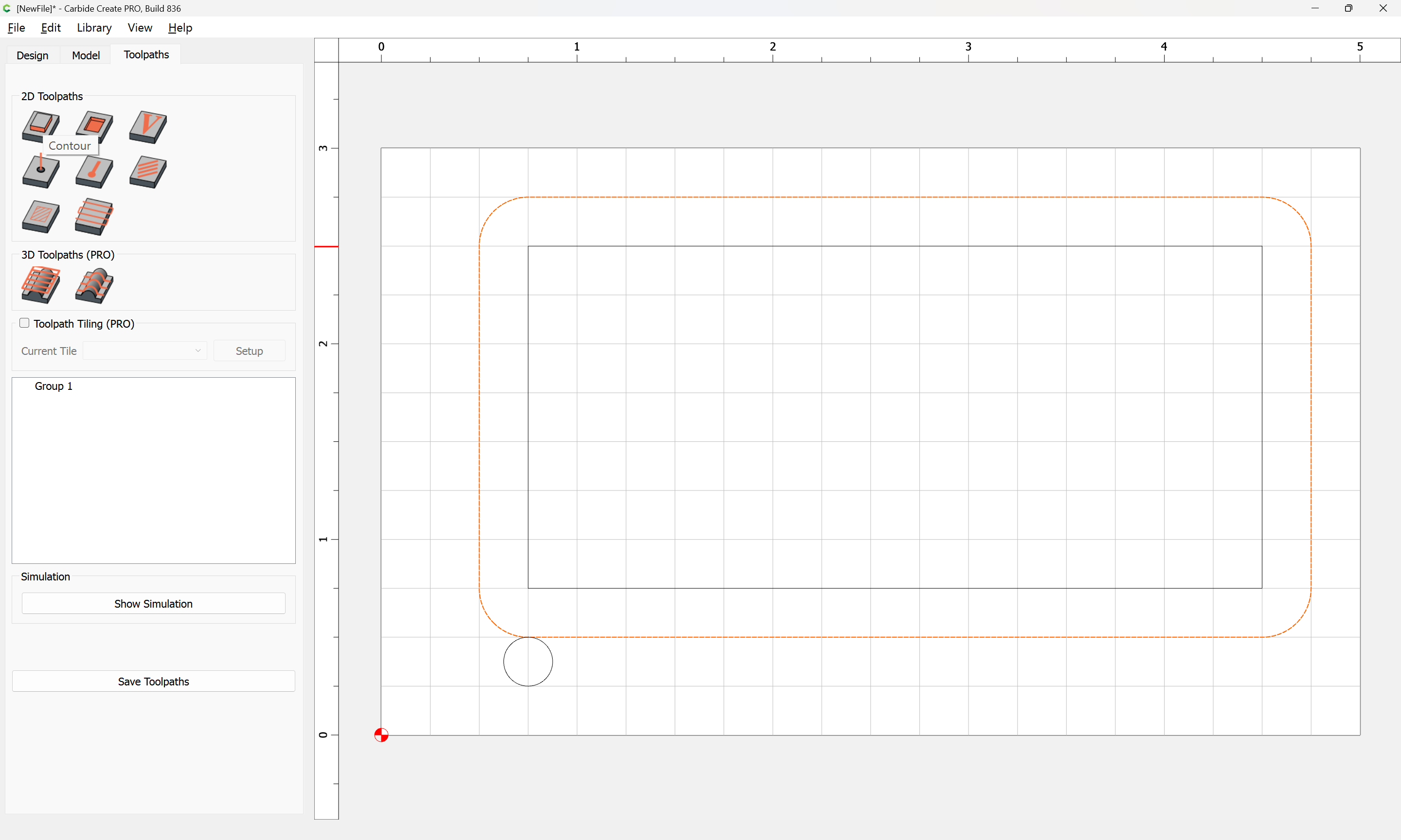

If we Offset (to the outside) by 0.25":
Apply

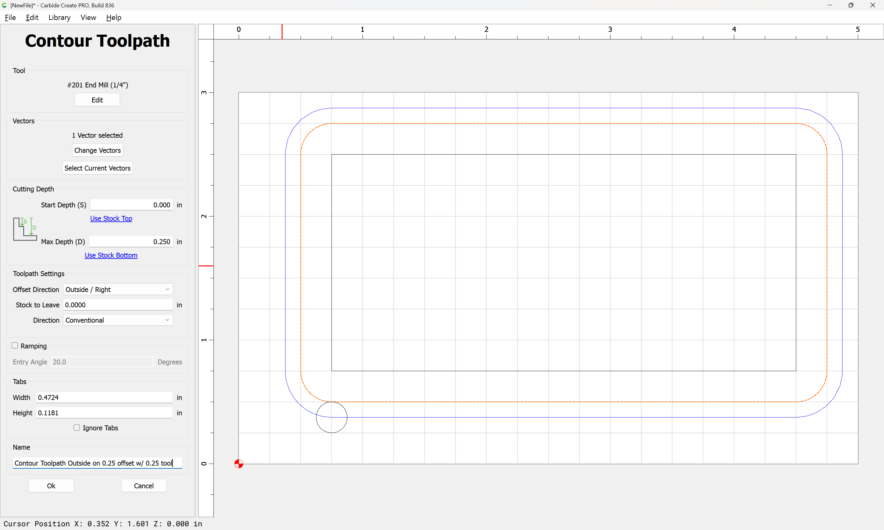

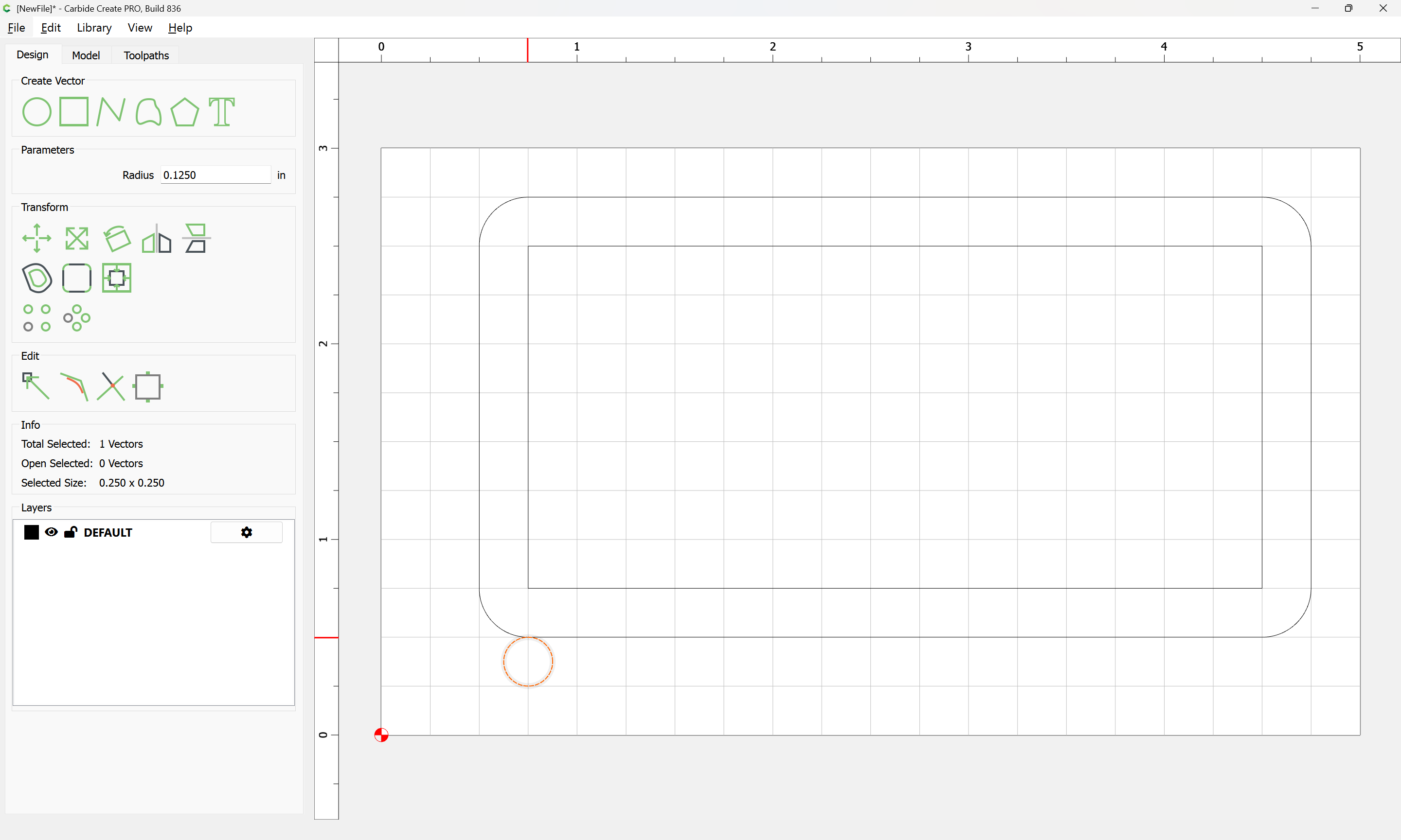

and then apply an Outside Contour toolpath which will be offset by the radius of the tool, so for a 1/4" tool, by 1/8" of an inch:

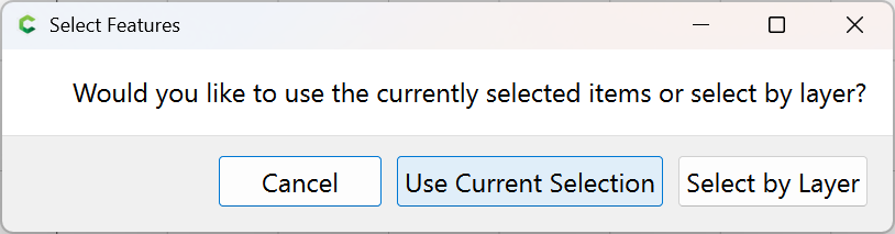

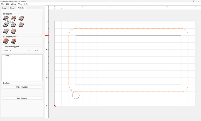

we assign the Outside Contour toolpath in Toolpaths to the Offset geometry:
Use Current Selection

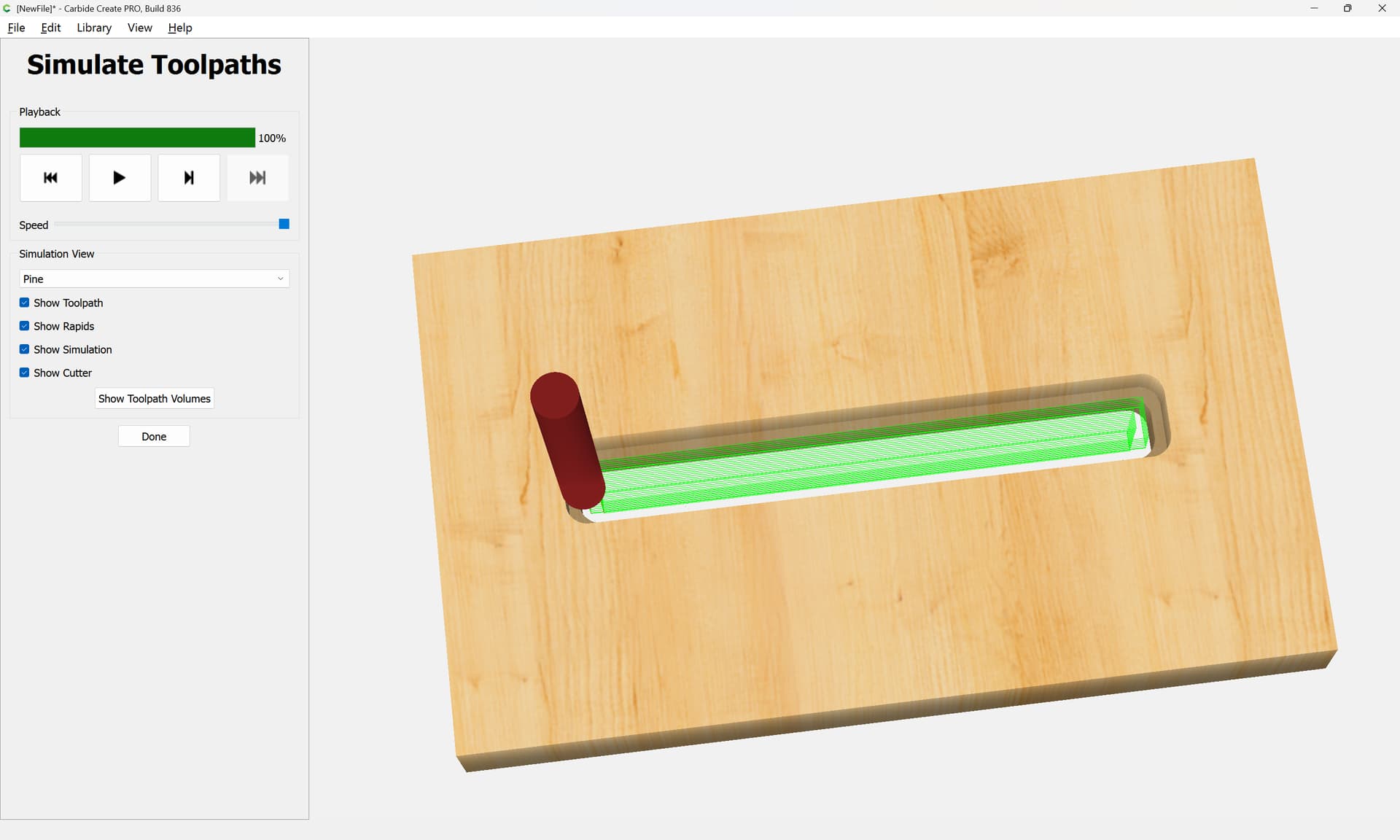

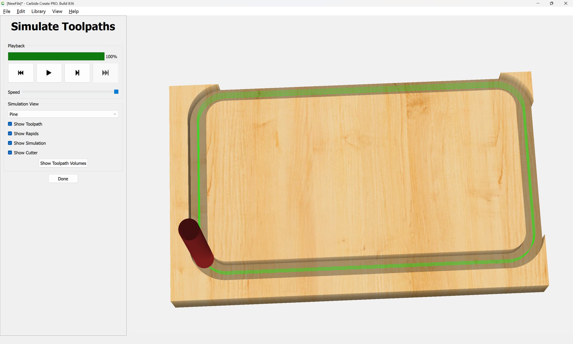

we see that the toolpath travels through the center of our tool proxy and when previewed:
cuts away compleatly at the back and right where only 0.25" of Stock material is left beyond the edge of the offset geometry.

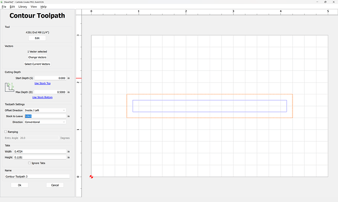

Can someone provide an explanation on Stock to leave? I have seen it, but don’t understand it.

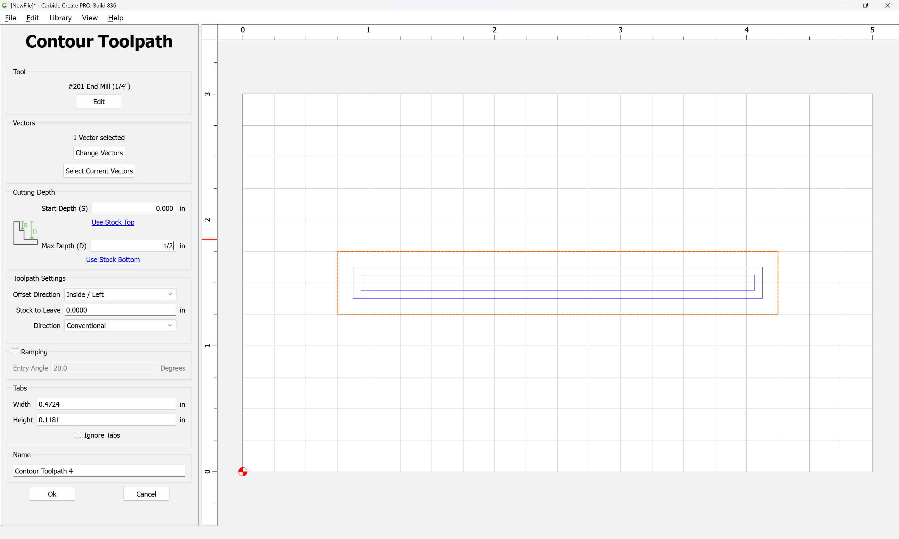

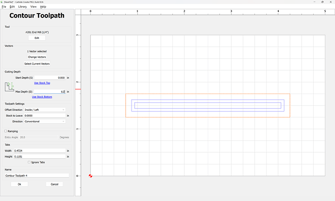

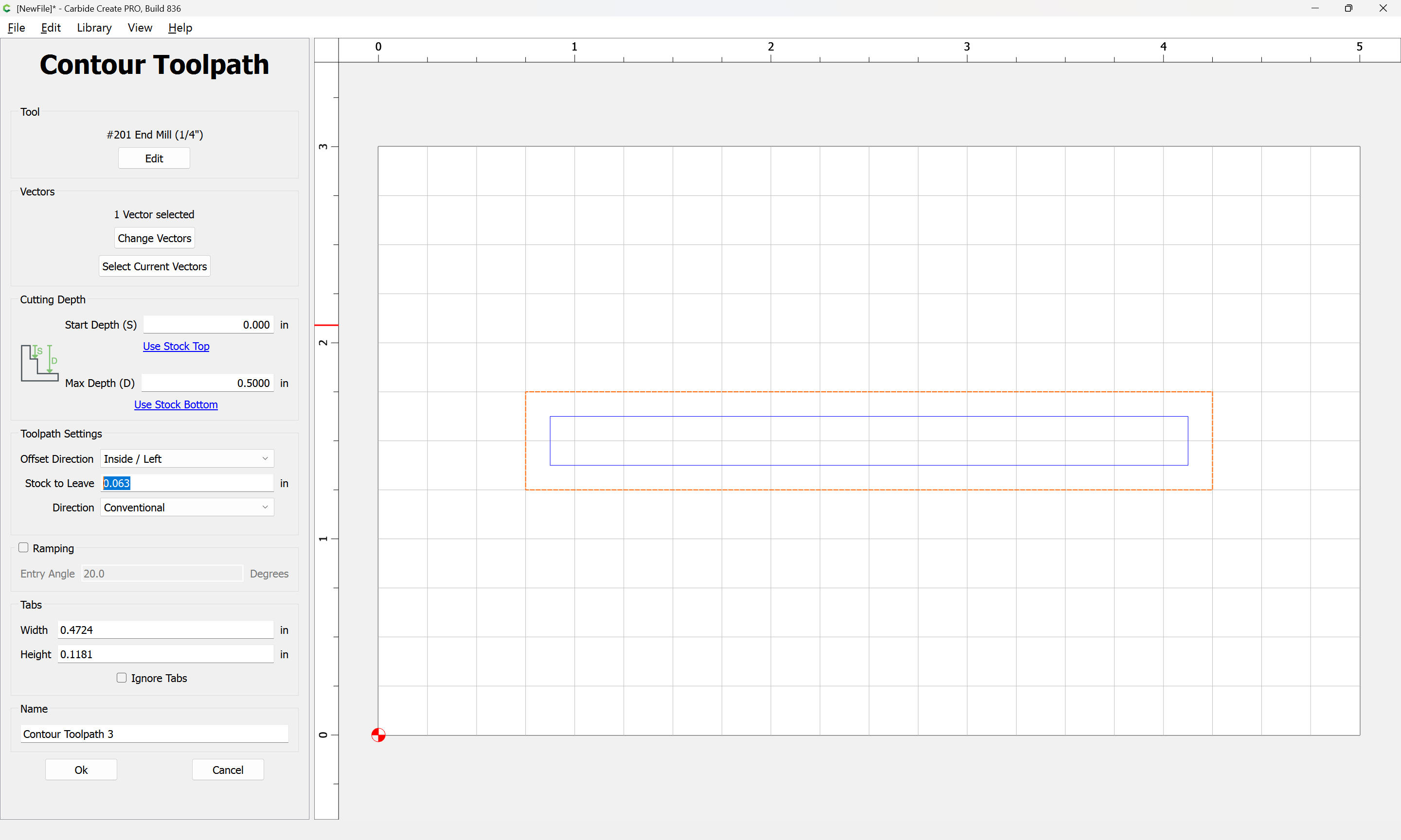

Imagine that you want to cut a region as a roughing pass:
and one wants to leave a Roughing Clearance of 0.063 inches:
then the toolpath will be inset by that dimension, which can be verified by making a partial depth toolpath which does not leave stock uncut:
